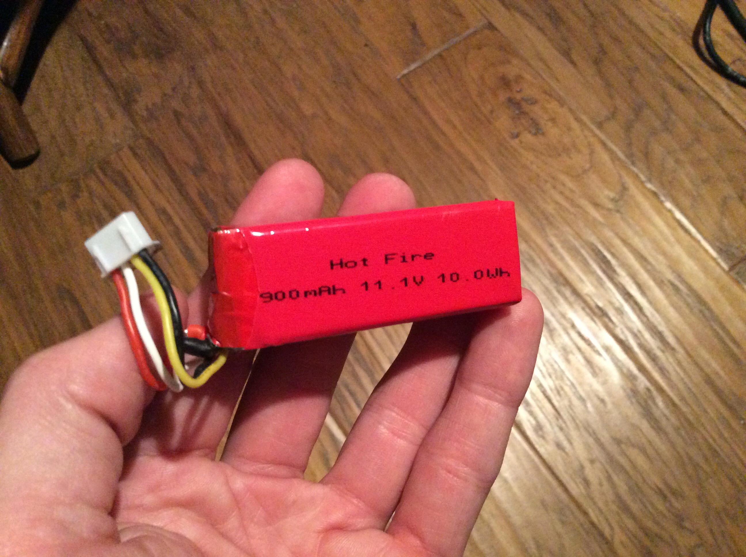

digatel Posted November 22, 2015 Report Posted November 22, 2015 Hotcig batteries are junk! I have a Hotcig and I just decided to replace the battery they gave me with a Fullymax from EVOLV. I'm glad I did too. I watched a review yesterday, where this guy did a in depth review of the battery that comes with the DX200 and the replacement batteries they're selling on Fasttech right now...the specs were astounding...in a bad way. Hotcig is really shady company and they continue these unethical practices, knowingly, at the cost of consumers like myself. They really need to be held accountable...anyone considering buying from Hotcig should watch this first! Here's the link to the review: http://youtu.be/SeOem8x26Gg

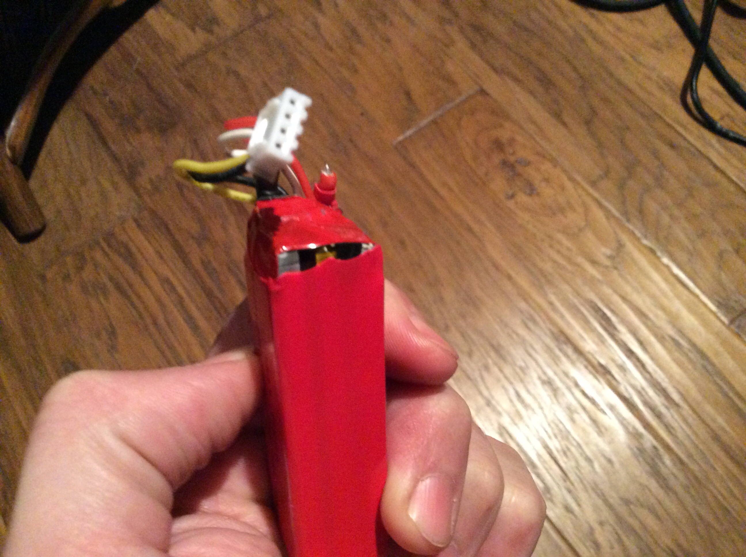

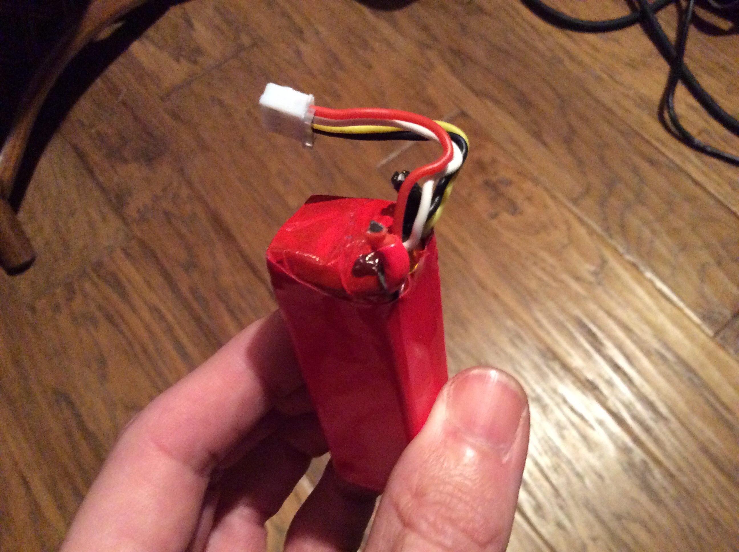

Conanthewarrior Posted November 22, 2015 Author Report Posted November 22, 2015 Gm111 said: I'm not sure what the hotcig battery connectors are like but do you have a multimeter? Expand Yes I do have multimeter, when I got the battery it measures at 11.31V-so I thought great, a replacement that will work.BUT when I got my DNA200 back from Evolv, guess what? Cell 1 will charge to a maximum of 3.85V, 3.86 if I am lucky. Cell 2 and 3 charge to the full 4.2V. So, intead of 10W/h's I get 6. I can't wait for the wismec realauz to come next week, and be done with the hotcig-I will just use it as a back up. I am using it right now, but the battery life is comparable to a single battery device at around 30 or so watts. So, it works, flawlessly, and performs the best out of all my devices-but I got a bad battery, AGAIN.
Conanthewarrior Posted November 22, 2015 Author Report Posted November 22, 2015 digatel said: Hotcig batteries are junk! I have a Hotcig and I just decided to replace the battery they gave me with a Fullymax from EVOLV. I'm glad I did too. I watched a review yesterday, where this guy did a in depth review of the battery that comes with the DX200 and the replacement batteries they're selling on Fasttech right now...the specs were astounding...in a bad way. Hotcig is really shady company and they continue these unethical practices, knowingly, at the cost of consumers like myself. They really need to be held accountable...anyone considering buying from Hotcig should watch this first! Here's the link to the review: http://youtu.be/SeOem8x26Gg Expand Hi there Digatel, I thought the hotcig battery WAS the fullymax that Evolv sell-it has the exact same dimensions as the fullymax 900MAH, plus the same constant and burst ratings. I agree hotcig is shady though. "Bennett" is currently speaking to me, and has said he will send me a new DX200 on Mondat due to everything I have had to go through via DHL, he asked for my adress and said he will give me a tracking number. But, I will find out on Monday/Tuesday if he follows through on this promise.

Gm111 Posted November 22, 2015 Report Posted November 22, 2015 Conanthewarrior said: [QUOTE=Gm111]I'm not sure what the hotcig battery connectors are like but do you have a multimeter? Expand Yes I do have multimeter, when I got the battery it measures at 11.31V-so I thought great, a replacement that will work.BUT when I got my DNA200 back from Evolv, guess what? Cell 1 will charge to a maximum of 3.85V, 3.86 if I am lucky. Cell 2 and 3 charge to the full 4.2V. So, intead of 10W/h's I get 6. I can't wait for the wismec realauz to come next week, and be done with the hotcig-I will just use it as a back up. I am using it right now, but the battery life is comparable to a single battery device at around 30 or so watts. So, it works, flawlessly, and performs the best out of all my devices-but I got a bad battery, AGAIN. [/QUOTE] If you've done this since having your mod back then don't worry but try measuring through the balance plug rather than the whole battery and see if each cell is okay.. Should be 3.7, 7.4 &11.1 if that's all good then the problem could be the balace connector on the chip isn't soldered right on cell 1.. Hopefully we can resolve this problem asap, if it's not the solder joint on cell 1 on the balance connector you could always replace the battery with one bought here in the uk, you could get one for under £10.

digatel Posted November 24, 2015 Report Posted November 24, 2015 Hi there Digatel, I thought the hotcig battery WAS the fullymax that Evolv sell-it has the exact same dimensions as the fullymax 900MAH, plus the same constant and burst ratings. I agree hotcig is shady though. "Bennett" is currently speaking to me, and has said he will send me a new DX200 on Mondat due to everything I have had to go through via DHL, he asked for my adress and said he will give me a tracking number. But, I will find out on Monday/Tuesday if he follows through on this promise. [/QUOTE] ------------------------------------------------------------------------------ Hey Conan, I thought maybe it was too, considering the specs, but when I took it apart and seen the battery that is in there, it was evident it is not. Granted, it does have the same "specs" and dimensions, but as far as quality it is junk. My battery was DOA, like I said before, so I never was even able to charge them. Nonetheless, when I seen that review on YouTube, I was couldn't believe it. I don't know where the batteries are made, but they are not up to "specs". The dimensions are almost exact that of the Fullymax, which made replacing it very easy. This is the battery that come with the Hotcig and the replacement battery:
