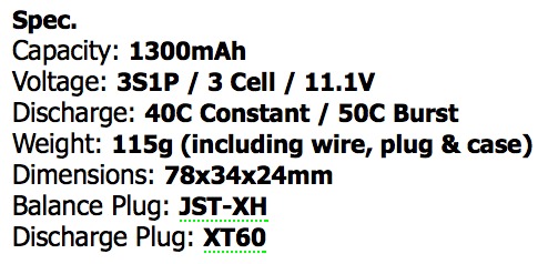

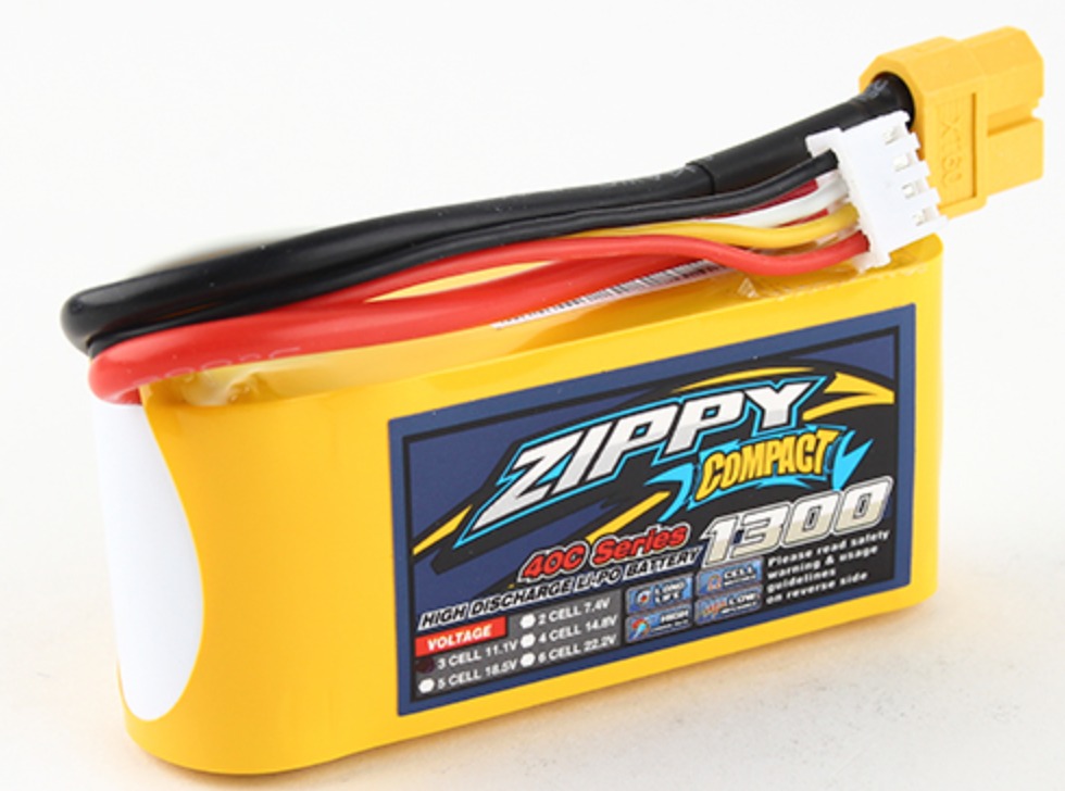

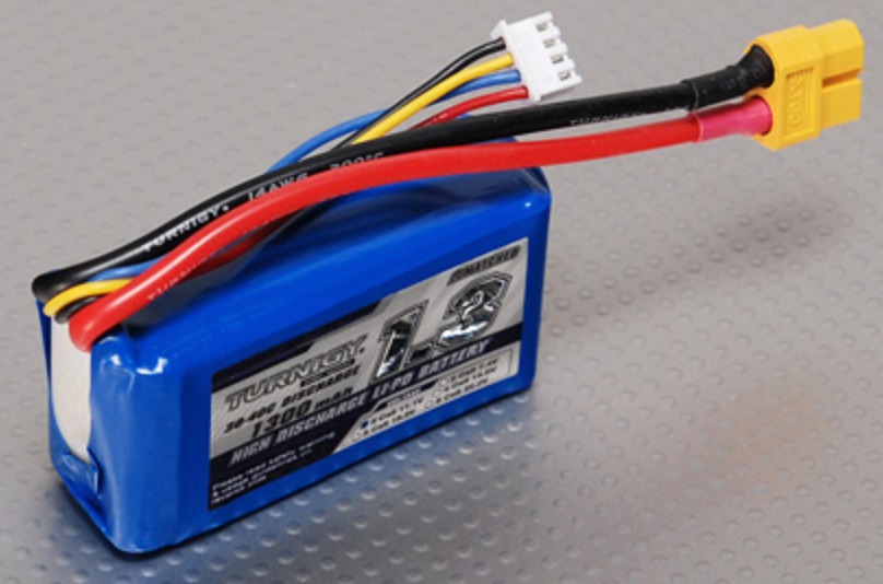

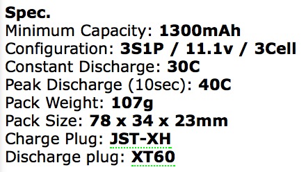

Amexmod Posted February 1, 2016 Author Report Posted February 1, 2016 My original battery don't work and now a want to buy a new.. can you help me?
VapingBad Posted February 1, 2016 Report Posted February 1, 2016 They are both upto spec, I would expect the Turingy to be a bit better IIRC from the communality battery results (https://forum.evolvapor.com/topic/65816-topic/) the Zippy's are below the stared capacity.
awsum140 Posted February 1, 2016 Report Posted February 1, 2016 Either should work well, but I'd use the Turnigy out of personal preference and good results, so far, with them. You will probably need to change the XT60 connector to an XT30 connector though no matter which one you use.
