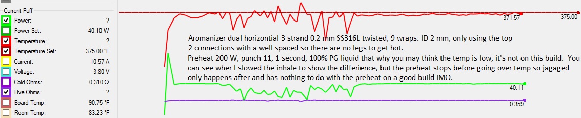

don't get freaked out when you see what the temp graph looks like in device mon for SS. it's no where as smooth as higher TCR wires. however, that does not mean you can not get a good TC vape from SS.

i find the trick to TC' ing SS is to : turn off preheat (1 watt, 1 punch 1 seconds). adjust the watts so you never really hit your set temp. so say you want 500°F, set it to 510°F and adjust you watts so you don't quite reach 510. other wise once you hit your set temp, the board struggles to regulate the wattage etc. so i keep it to where i come close to my set temp but never hit it, right towards the end of my vape.                something like this, i'm happy with........ss1.png

I find the best strategy with ss is to max the preheat, especially punch and 2 or 3 seconds and keep the wattage so it stays just below temp just below the temp limit.  It only get jagged after the preheat has finished if you have the watts higher than you need.

Your welcome, this is what I mean
VapingBad, that actually makes a lot of sense on a rebuildable, I need to get some SS wire to build with but the only thing i have that runs stainless is a TFV4 coil, but because it does have legs to heat maybe causing my issues.  So I wonder how that would compare to a build.
