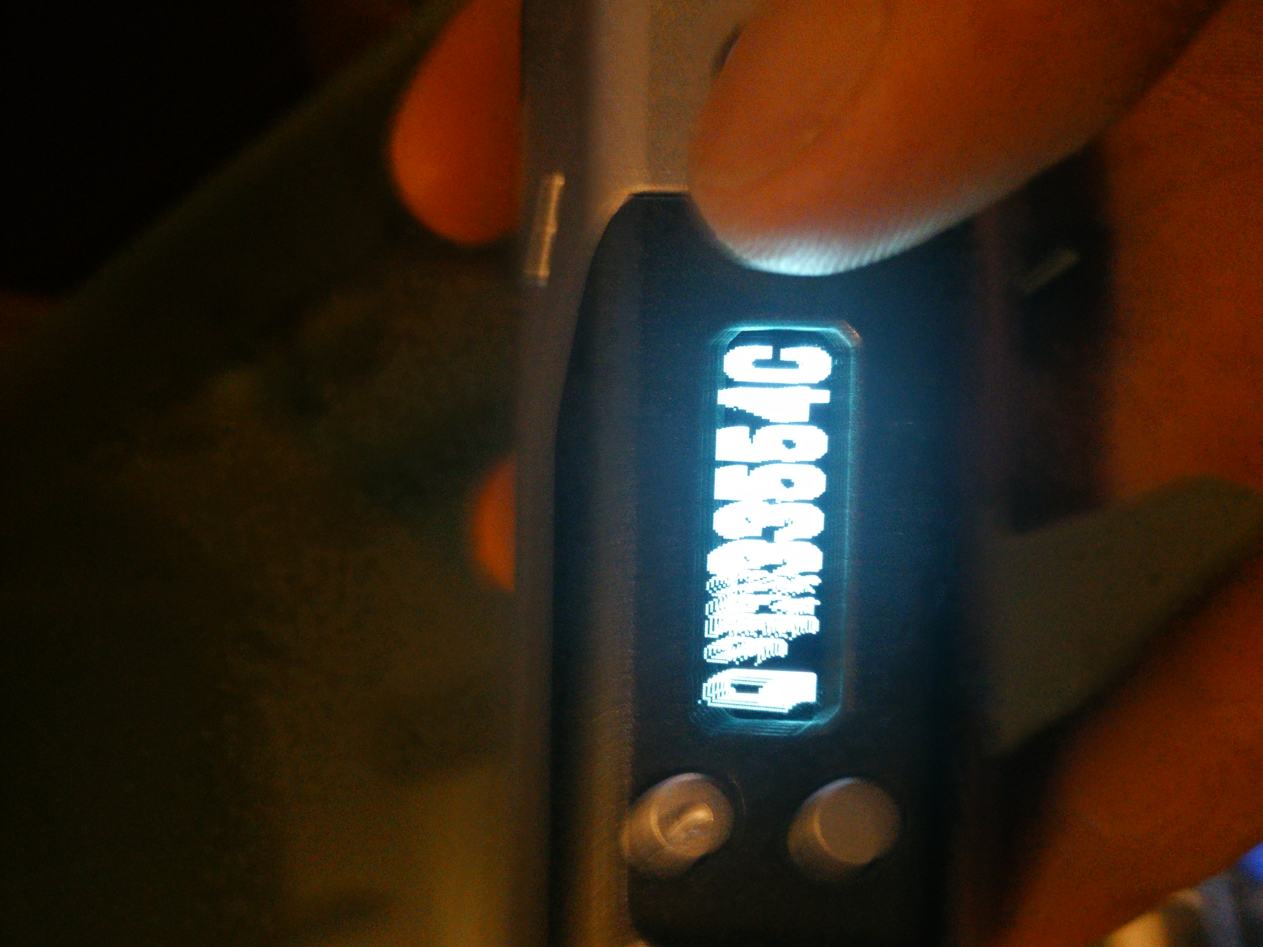

MaDc0w Posted April 12, 2016 Author Report Share Posted April 12, 2016 I had a profile with ohms locked to 0.56, changed coils and forgot to unlock/set the coils properly to the new ohm value. When I went to hold down and fire, I didn't lock the fire and it fired shortly showing 33554 degrees celsius. Sorry for the terrible picture attached, but I don't want to try reproducing it as a safety precaution. Using firmware 2016-02-29 EScribe 1.0.42 Link to comment Share on other sites More sharing options...
blueridgedog Posted April 13, 2016 Report Share Posted April 13, 2016 That is a calculated value, so if you build a new coil with substantially different resistance and you fired it with ohms locked at .56, then it would "think" that the difference between .56 and what it was reading was due to temperature, and calculate what that temperature might be and show it to you. Link to comment Share on other sites More sharing options...
MaDc0w Posted April 13, 2016 Author Report Share Posted April 13, 2016 I see, makes sense. I had built a .23 and it was a strange sight to see. Link to comment Share on other sites More sharing options...
