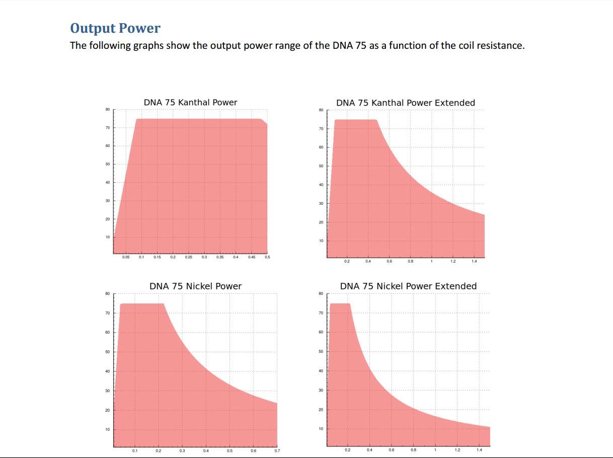

lordbyron77 Posted May 4, 2016 Author Report Share Posted May 4, 2016 I observed the graphics, but I'd like the precise values ??of the limits for the circuit supply. I don't uderstand the difference between Ni200 (temp) mode and power mode Link to comment Share on other sites More sharing options...

lordbyron77 Posted May 4, 2016 Author Report Share Posted May 4, 2016 this is clear. what can I not explain is the graph. If you look at the attachment you will see that Ni200 limit seems lower than the Kanthal mode Link to comment Share on other sites More sharing options...
BillW50 Posted May 4, 2016 Report Share Posted May 4, 2016 Did you also consider that Ni200 from room temperature doubles its resistance when heated to about 400°F? Link to comment Share on other sites More sharing options...
lordbyron77 Posted May 4, 2016 Author Report Share Posted May 4, 2016 ok, it is a variable that I had not considered Link to comment Share on other sites More sharing options...

VapingBad Posted May 4, 2016 Report Share Posted May 4, 2016 lordbyron77 said: now it is clear we must consider the resistivity increases from early activation. I saw that you are proficient with Excel, are you able to develop a similar table to the above with Ni200? Expand I did the one above to help a user understand an issue with a quite hight res ceramic coil on a VT133, you could but as it depends on your preferred temp I decided not to, but doubling the res would be in the ballpark. My little table has not been confirmed by Evolv so it's nothing official. Link to comment Share on other sites More sharing options...

VapingModeration Posted May 4, 2016 Report Share Posted May 4, 2016 Oh, I see now. The resistances specified for Ni are for Base value and not the high value it will hit during usage. Brilliant! Link to comment Share on other sites More sharing options...
