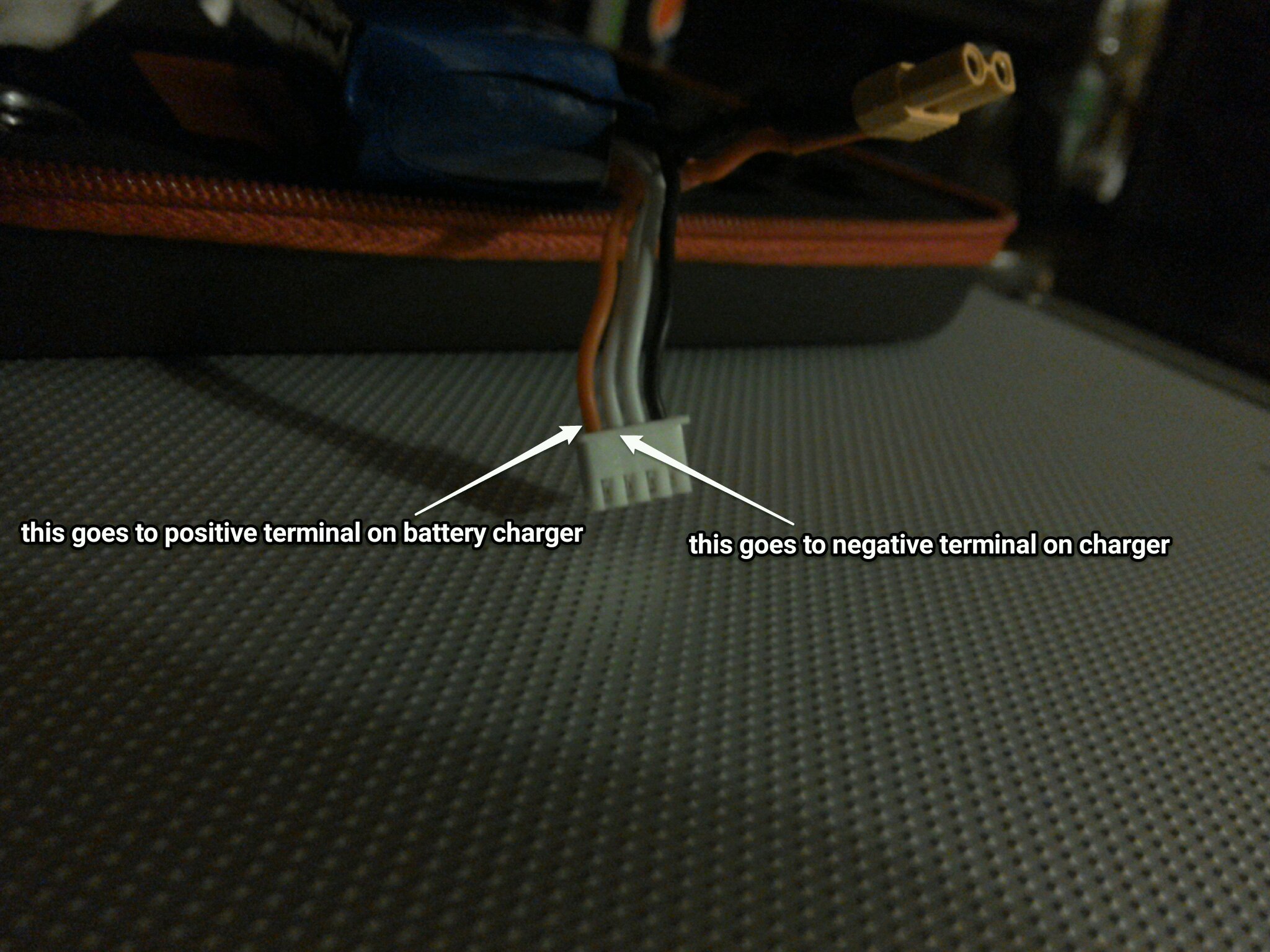

Daft Chunt Posted June 21, 2016 Report Posted June 21, 2016 the battery is a fullymax, cell 1 4.18v, cell 2 4.18v and cell 3 3.78 and the mod is an efusion dna 200
Spector NS5 RD Posted June 21, 2016 Report Posted June 21, 2016 Daft Chunt said:Cell 1 4.18v, cell 2 4.18v and cell 3 3.78vcell 3 is out-o-balance. you can try to just charge that cell ONLY through the balance tap with a 3.7 volt lithium charger. bring that one cell up to around 4.18 and see how the pack behaves when re installed in your efusion.

Spector NS5 RD Posted June 21, 2016 Report Posted June 21, 2016 Daft Chunt said:Thanks chunky, where about do I get one of these chargers?you don't have an 18650 battery charger laying around? hang on, a friend of mine here has a pic showing what i'm trying to explain. let me find it.......hang on
dwcraig1 Posted June 21, 2016 Report Posted June 21, 2016 The pack is somewhat unbalanced, it's a very slow process using the on-board charger to get it balanced. It may eventually balance or perhaps cell 3 won't charge any higher due to a bad cell. If you have a meter check the voltages on the balance connector or the power wires, your voltages add up to 12.1 volts and see if they match up to what EScribe says.BYW 12.1 is 95 +% roughly of 12.6 volts
Spector NS5 RD Posted June 21, 2016 Report Posted June 21, 2016 if you want to try this. dwcraig1 can explain more. basically you're targeting the unbalanced cell. you want to bring the voltage up on it. you single out the unbalanced cell through the balance tap for charging.

Daft Chunt Posted June 21, 2016 Report Posted June 21, 2016 I have a night core charger somewhere but I don't understand how I can isolate the individual cell to bring it into line with the others
Daft Chunt Posted June 21, 2016 Report Posted June 21, 2016 Is that safe?, Looks kinda Frankenstein dangerous to me
dwcraig1 Posted June 21, 2016 Report Posted June 21, 2016 It's safe (enough)Your only looking at 4.2 volts @ .7 ampWell the wiring must not short as it has quite a bit more power, connect the wires to the balance connector last and disconnect them first.
dwcraig1 Posted June 21, 2016 Report Posted June 21, 2016 In the picture a couple posts back it is cell #3 that I'm charging, that's using two pins on the positive side of the connector. The outboard (#3) is positive and next one (#2) is negative.Mine got out of balance because I got e liquid between the connector and board. I thought it was the battery so I replaced it, soon it had the same problem. Then I cleaned the area and problem never came back.
