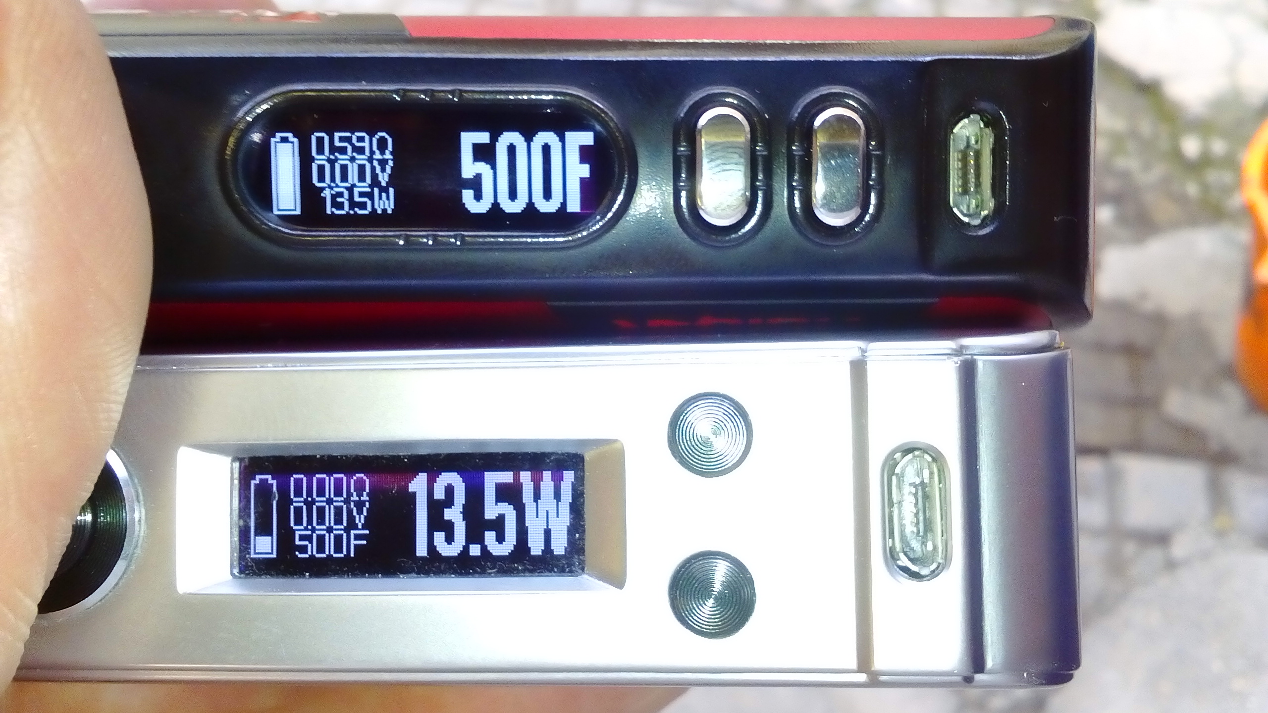

David247 Posted July 5, 2016 Author Report Posted July 5, 2016 Im trying to change screen layout to watts instead of temp but after I upload to device its still the same, or am I missing some thing?Thanks David
Scarab Posted July 5, 2016 Report Posted July 5, 2016 "Temperature dominant" checked? And it's only for TC profiles.
VapingBad Posted July 5, 2016 Report Posted July 5, 2016 Probably that you should be in a temp dominant or watts (any wire with the temp sensing box not checked) profile, then temp and watts will swap places on the screen, you don't need to change the fields.
BillW50 Posted July 5, 2016 Report Posted July 5, 2016 Yes like Scarab and VapingBad already stated. In EScribe, just uncheck Temperature-Dominant for the Profiles (General tab) you want Wattage displayed in big digits on the right. Don't forget to Upload Settings to Device.
