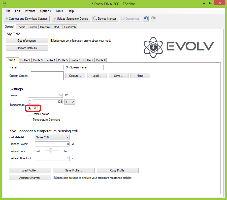

VapingBad Posted July 22, 2016 Report Posted July 22, 2016 DNA 200 are great in power mode, they automatically go into power mode when they detect non temp sensing wire so what you describe is probably just the other mods putting out lower power than the screen says causing you to up the power on the DNA, jut turn the power down a bit. You can force power mode by adjusting the temp above 600 F if that make you more comfortable, but it is not necessary, this applies to the DNA 25, 40, 75 & 200. You can also turn temp limiting off in each profile in EScribe.

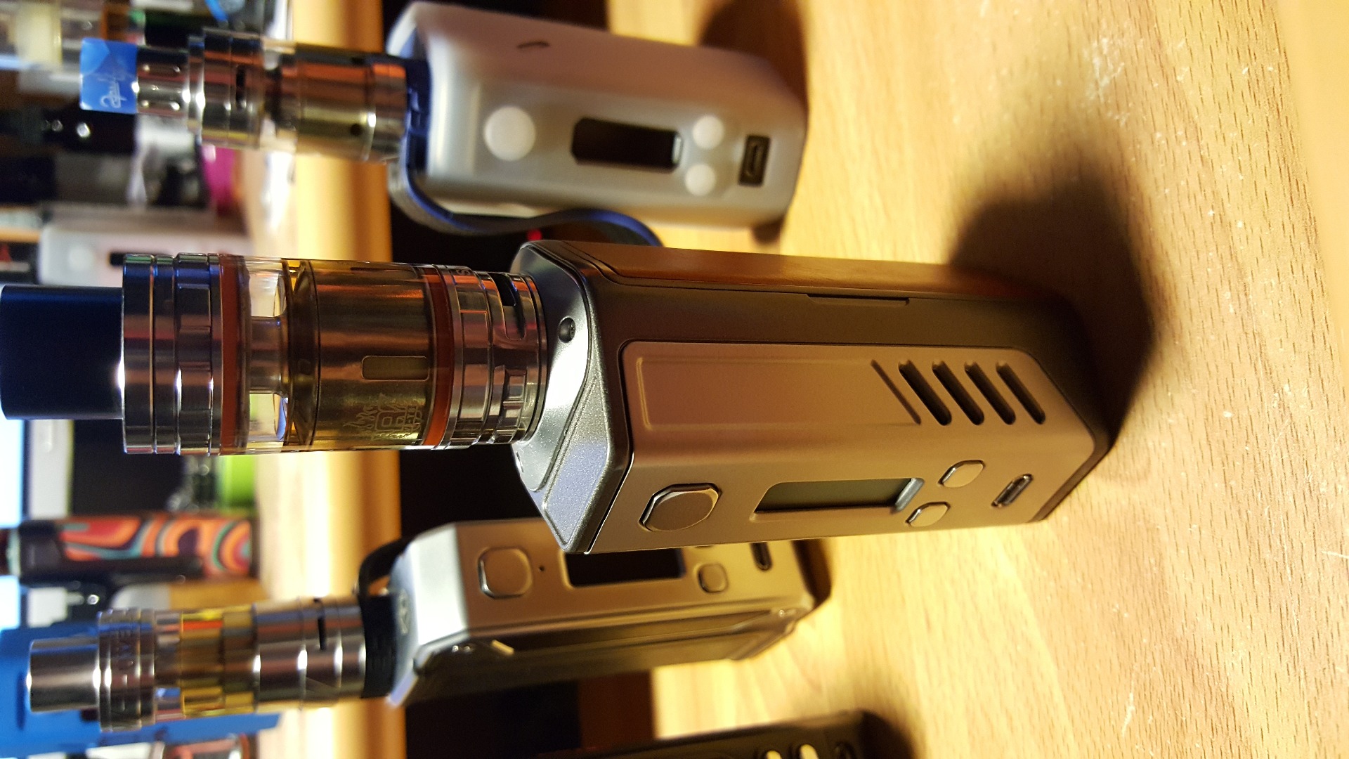

Alcaideariel12 Posted August 7, 2016 Report Posted August 7, 2016 It vapes great, just turn off temp control. I have a TFV8 on my Triade DNA 200 and it vapes awesomely. I vape my TFV8 at 95W all day. Gotta say, it's a juice HOG.
