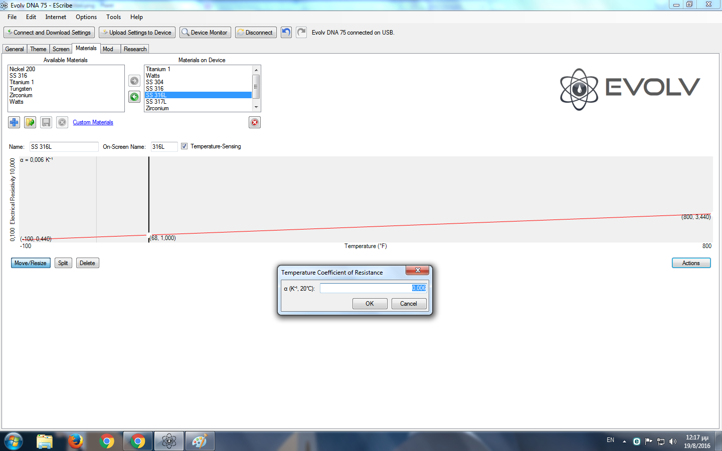

GreekNick Posted August 19, 2016 Author Report Posted August 19, 2016 Once you change the TCR on one material it automatic changes it to all other materials and once you change a battery it puts it back to its default 0.006

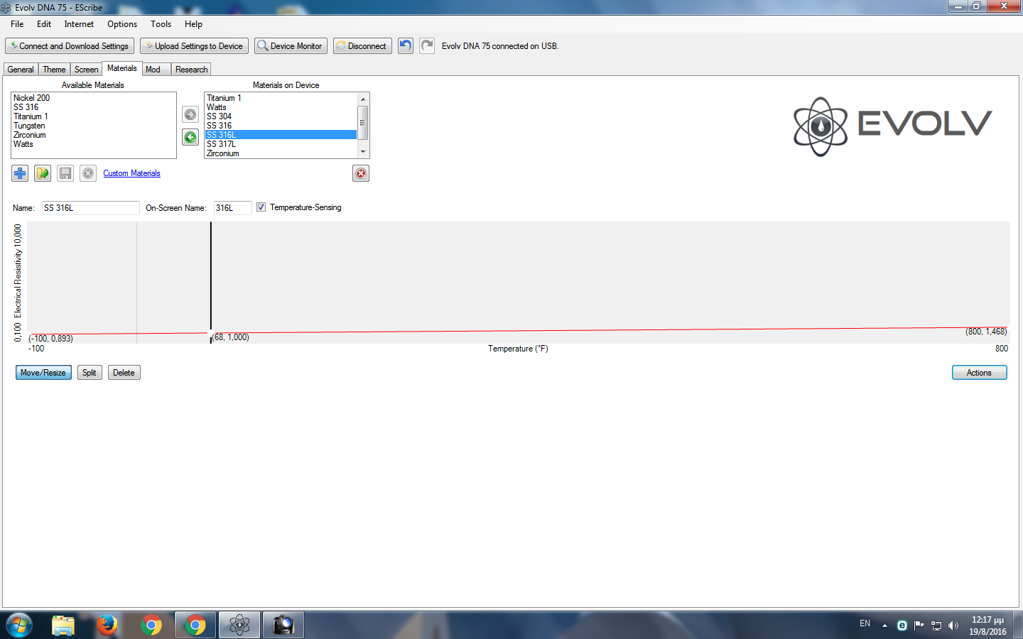

VapingBad Posted August 19, 2016 Report Posted August 19, 2016 If you are looking at the value in the box you get from Actions - TCR (Approximation) it always defaults to 0.006 as most profiles cannot be converted to a single TCR. Are the materialsall like this (TCR 0.006)?
GreekNick Posted August 19, 2016 Author Report Posted August 19, 2016 Yes. and once i connect it again and try to change it it goes again to 0.006 allthow i have set it to 0.0012

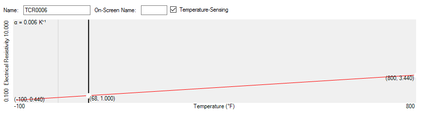

VapingBad Posted August 19, 2016 Report Posted August 19, 2016 The 2nd screen shot is not 0.006, I know the line shows 0.006 when the edit box is open, but if you cancel it reverts back to what is in that memory slot. Did you change the value to something other than 0.006 and save or if you just cancelled then the TCR on the mod wasn't 0.006.
GreekNick Posted August 19, 2016 Author Report Posted August 19, 2016 i posted the pics in the wrong order
VapingBad Posted August 19, 2016 Report Posted August 19, 2016 GreekNick said:i posted the pics in the wrong orderThen if the 2nd pic is what on the mod it was not 0.006, look at the value on the right for 0.006 it is 3.440 at 800F, for the TCR you have it is 1.468 at 800 F, if my maths is right about a TCR of 0.001151.

dwcraig1 Posted August 19, 2016 Report Posted August 19, 2016 I'll give it a go.If EScribe is just opened and you put up the window to change the TCR of a particular material it will have .006 in the box by defaualt as well as show you the graph for that setting. Nothing is changed till you press"OK".If EScribe wasn't been closed and you have changed the TCR of a material then it will show that number in the box by defaualt.Again nothing is changed till you "OK" it
VapingBad Posted August 19, 2016 Report Posted August 19, 2016 GreekNick said:Yes but why it is changing it to all other matirialsI don't think it is, as I said when you open the box to enter a TCR it defaults to 0.006, but this is not the value that is currently stored you need to compare the curves. Because the profiles are not a single ratio TCR they cannot convert most of them to a TCR without loosing data so they don't try, this can be confusing I know, but it is what it is. FWIW may values have never changed on the 2 DNA 75s I have.
