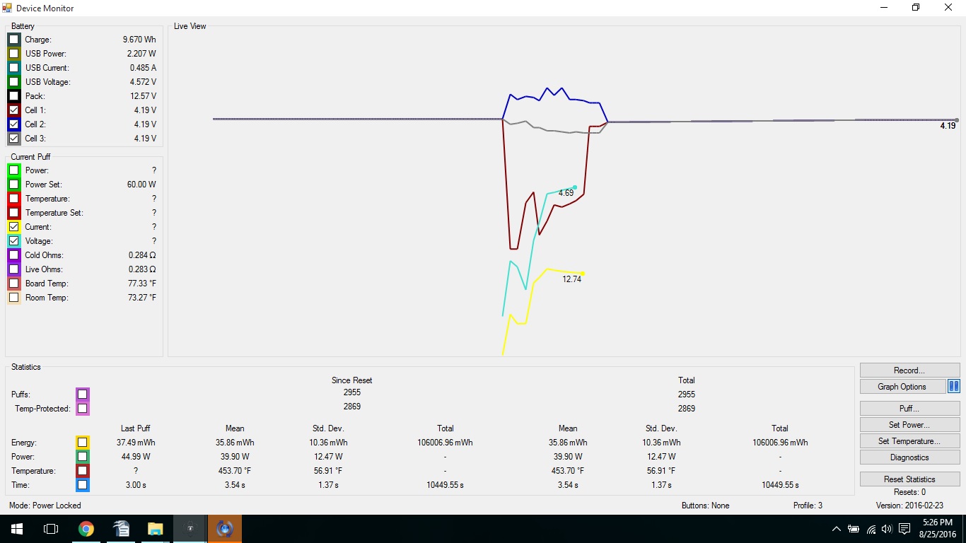

lkirk1387 Posted August 22, 2016 Author Report Posted August 22, 2016 Hello everyone. I am having an issue with the Lavabox 200. When it was first used I kept getting an "imbalanced battery" issue when I was firing. I plugged in and updated and things have been fine until now. I started getting the same error. When plugged in and on device monitor all three cells are consistent with being less than .01 off at a time. When the device is fired all three cells have stability issues and i started getting the same error again. I don't know how I should fix this.
retird Posted August 22, 2016 Report Posted August 22, 2016 Can you post a screenshot of Device Monitor (while firing the device) that shows "Cell 1, cell 2 and cell 3" "Current" and "Voltage".....
lkirk1387 Posted August 25, 2016 Author Report Posted August 25, 2016 Sorry that it took so long for me to get a photo up, but here it is.

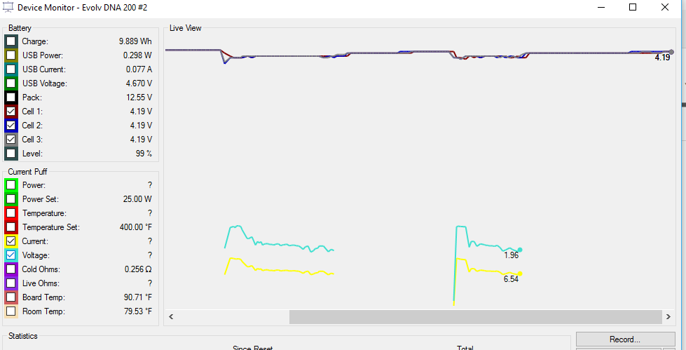

retird Posted August 25, 2016 Report Posted August 25, 2016 The pack should be discharging at about the same rate from each cell. Thinking the battery pack needs replacing or maybe defective wiring...., Since it has done this since it was new you might contact your vendor ....here is a screenshot showing what my battery discharge per cell is..:
BillW50 Posted August 28, 2016 Report Posted August 28, 2016 Wow that is pretty bad, lkirk1387. Maybe cleaning the lipo connections and checking for leaked juice on the board.
