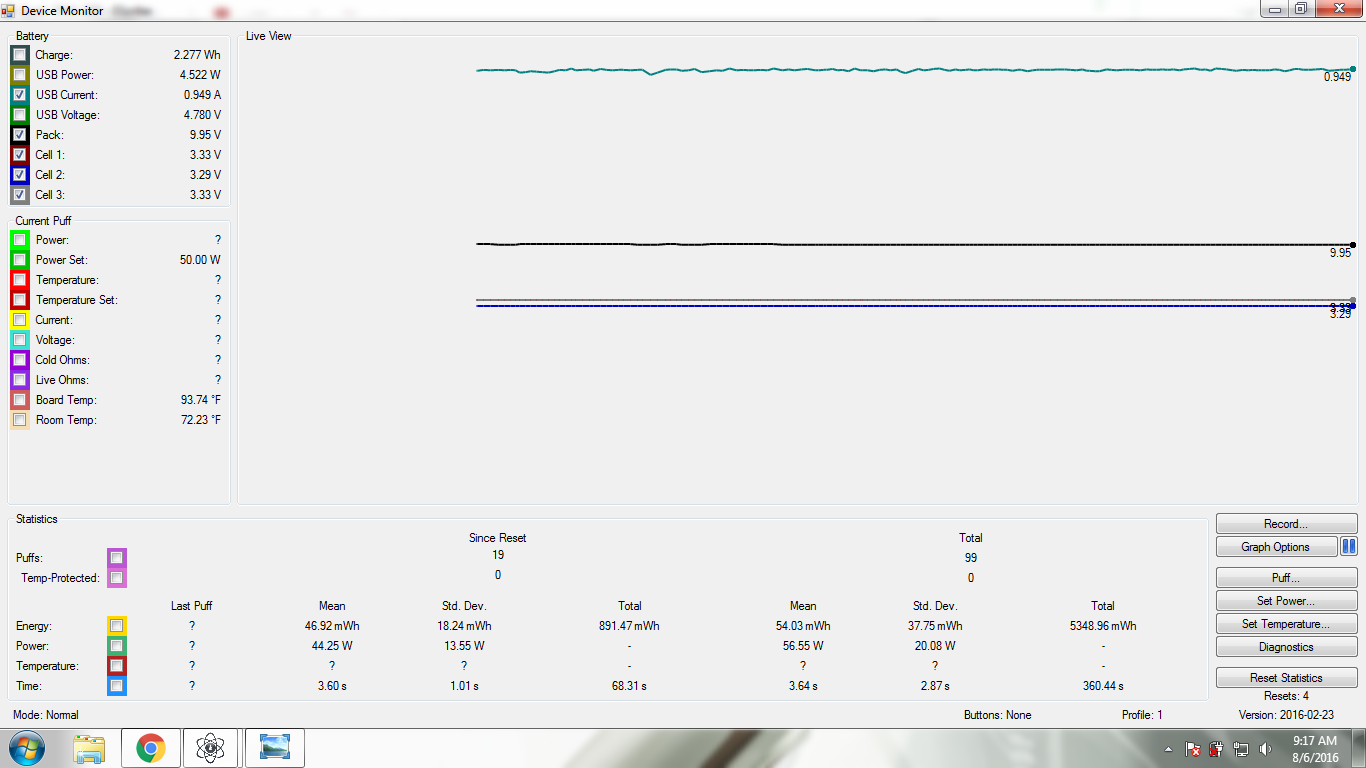

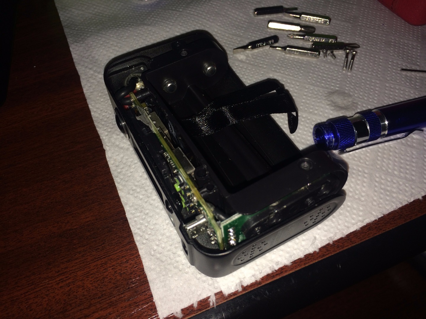

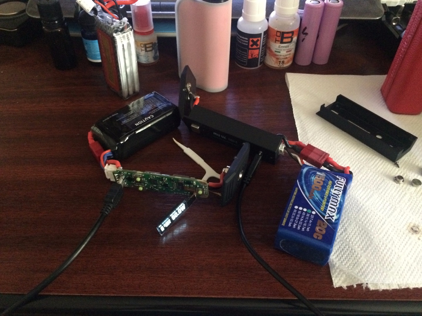

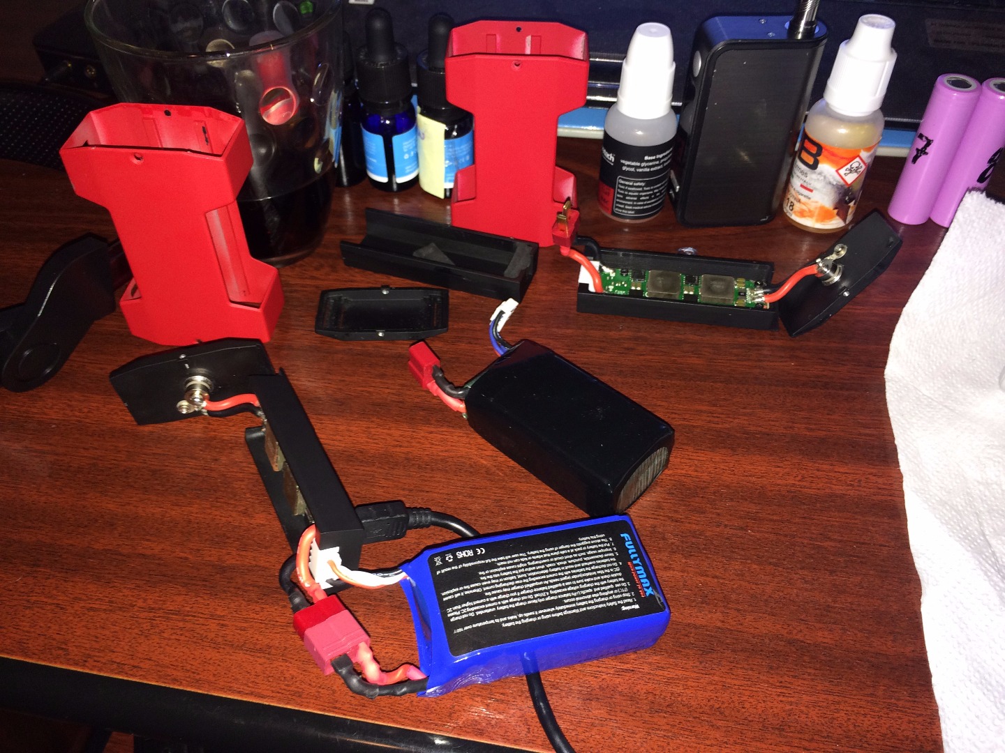

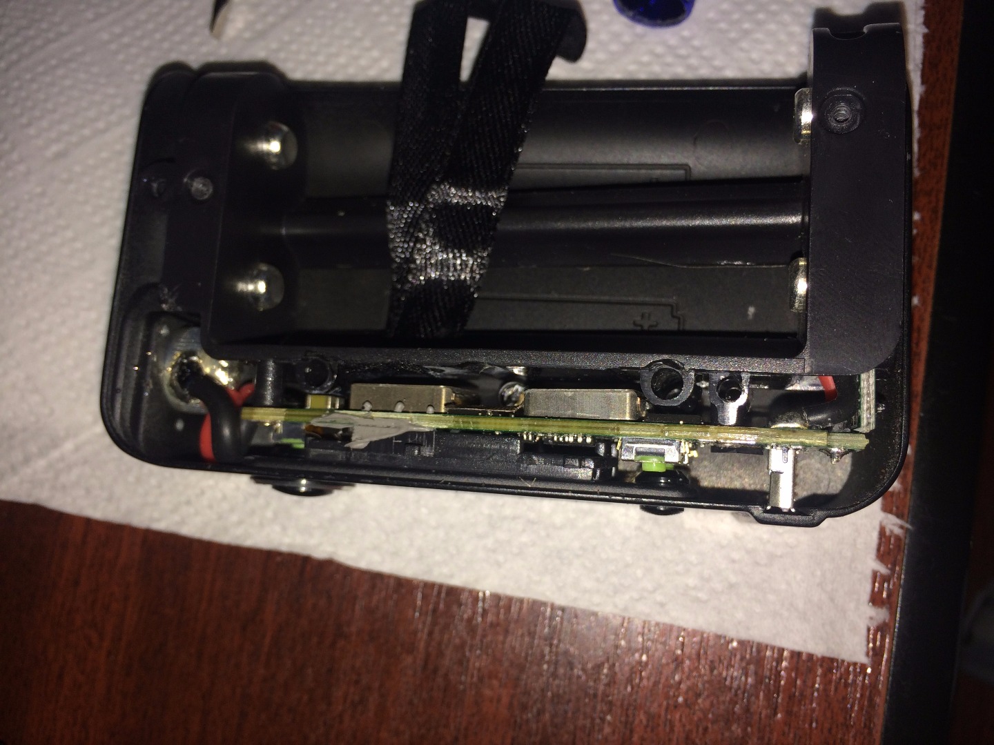

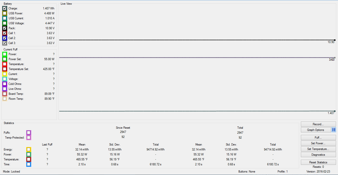

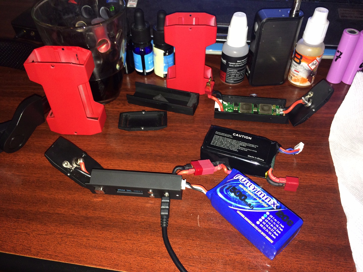

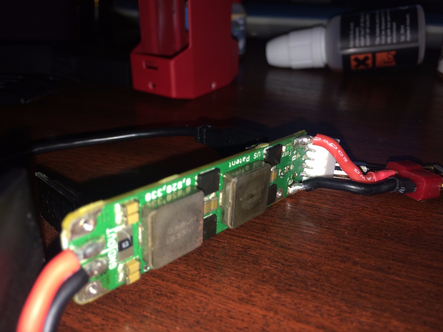

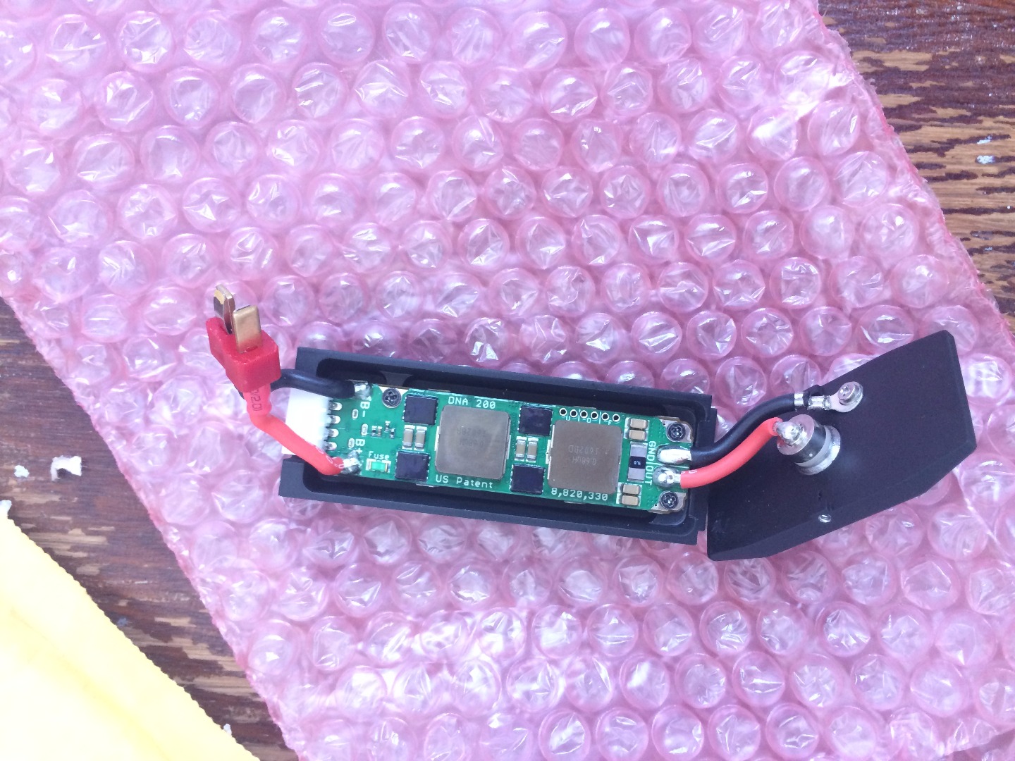

RedLabel Posted August 6, 2016 Report Posted August 6, 2016 Hello,I bought my second Panzer Box DNA200 from Gearbest with serial VBNGZARWGKVZ of the DNA board.With this second one i have a problem with the board. It doesn`t charging.My first Panzer box came with original Lipo but this second one has a Fullymax 1500mah 3S 20C Lipo.When it arrived, the battery was drained, i tried to charge but nothing. I changed with another Lipo and it doesn`t charge. After that i charged that Lipo on a Lipo charger and is OK now. All my Lipo batteries are OK now.I connected on Escribe and on my laptop USB it shows 0.95A charging but the voltage it is the same. I changed a lot of USB cable, i tried USB recovery charge .... Still the same.... The 3 battery voltage has not increased.I can charge my Lipo batteries only with other DNA board or Lipo chargers.I`m attaching you some photos with the board, Lipo and Escribe device monitor where it shows that is charging 0.95A from a laptop USB (where it should be max 0.5A)Please help me.Thank you.
BillW50 Posted August 6, 2016 Report Posted August 6, 2016 RedLabel said:I`m attaching you some photos with the board, Lipo and Escribe device monitor where it shows that is charging 0.95A from a laptop USB (where it should be max 0.5A)What is selected for a battery type under the Mod (tab)? Is Lithium Polymer selected and 3 cells?
RedLabel Posted August 6, 2016 Report Posted August 6, 2016 Lithium Polymer selected and 3 cells ....
BillW50 Posted August 6, 2016 Report Posted August 6, 2016 Well there are soft reset and hard reset to try. Although I don't think they will help one bit. As removing the lipo should do this anyway. Then there is reloading the firmware in case the one on the DNA200 had been corrupted for some reason. Otherwise then it is down to contacting Gearbest or Evolv. As it really sounds like it is a board failure.
RedLabel Posted August 6, 2016 Report Posted August 6, 2016 When i click Soft / Hard reboot it appears a little window with ``Soft / Hard reboot command issued`` ... is it ok?

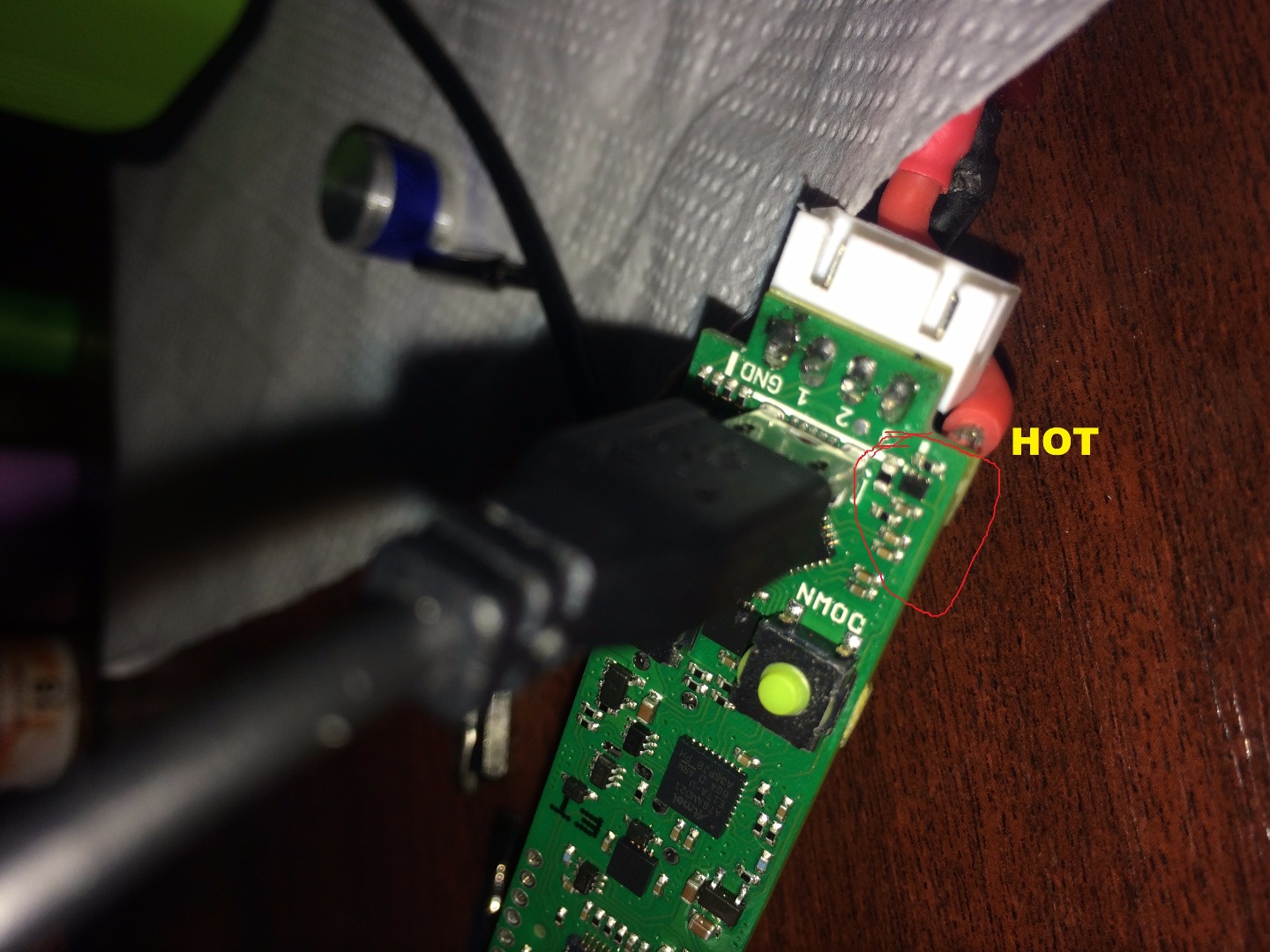

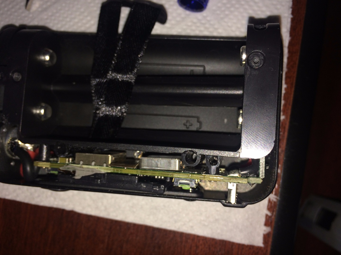

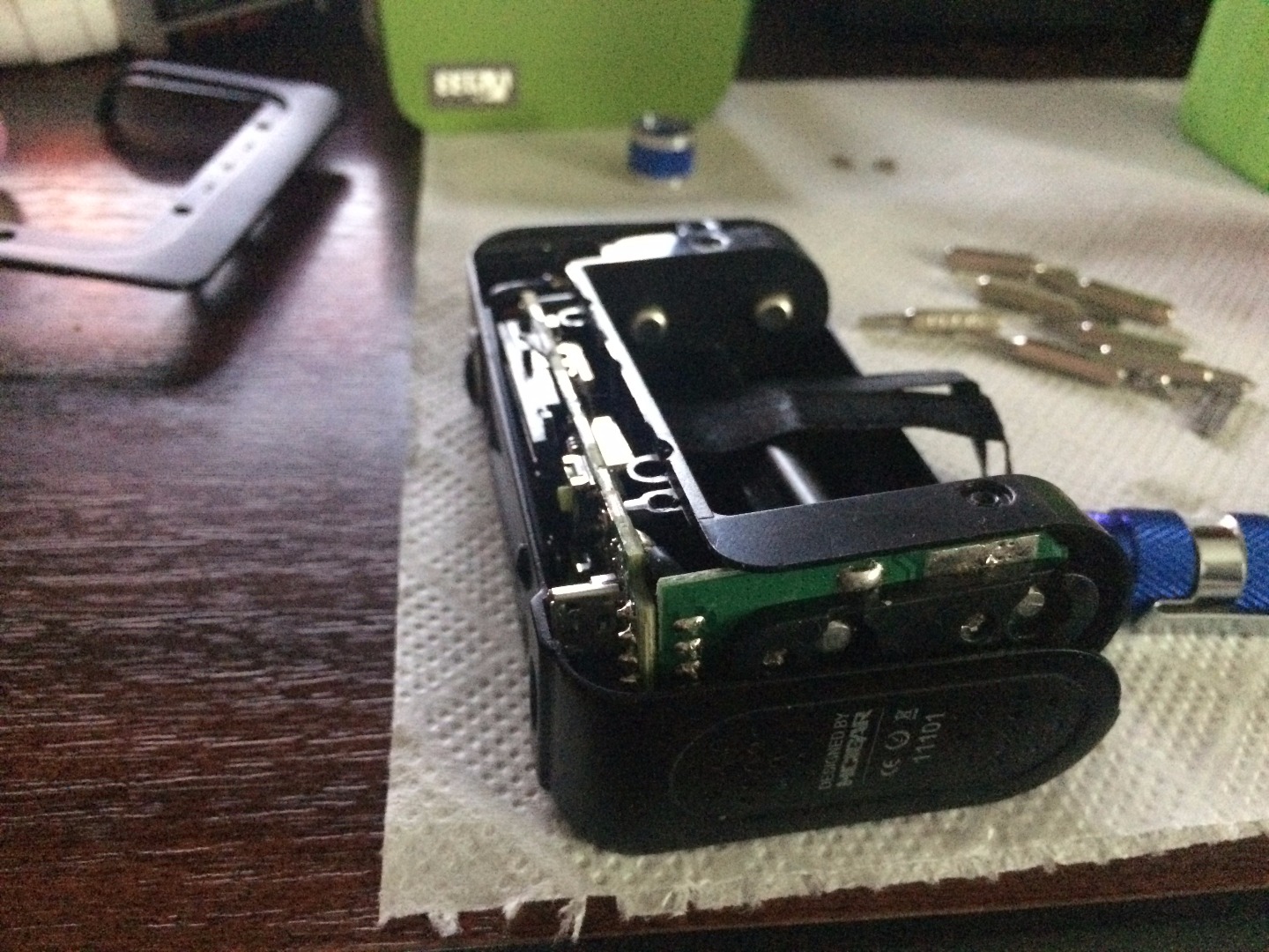

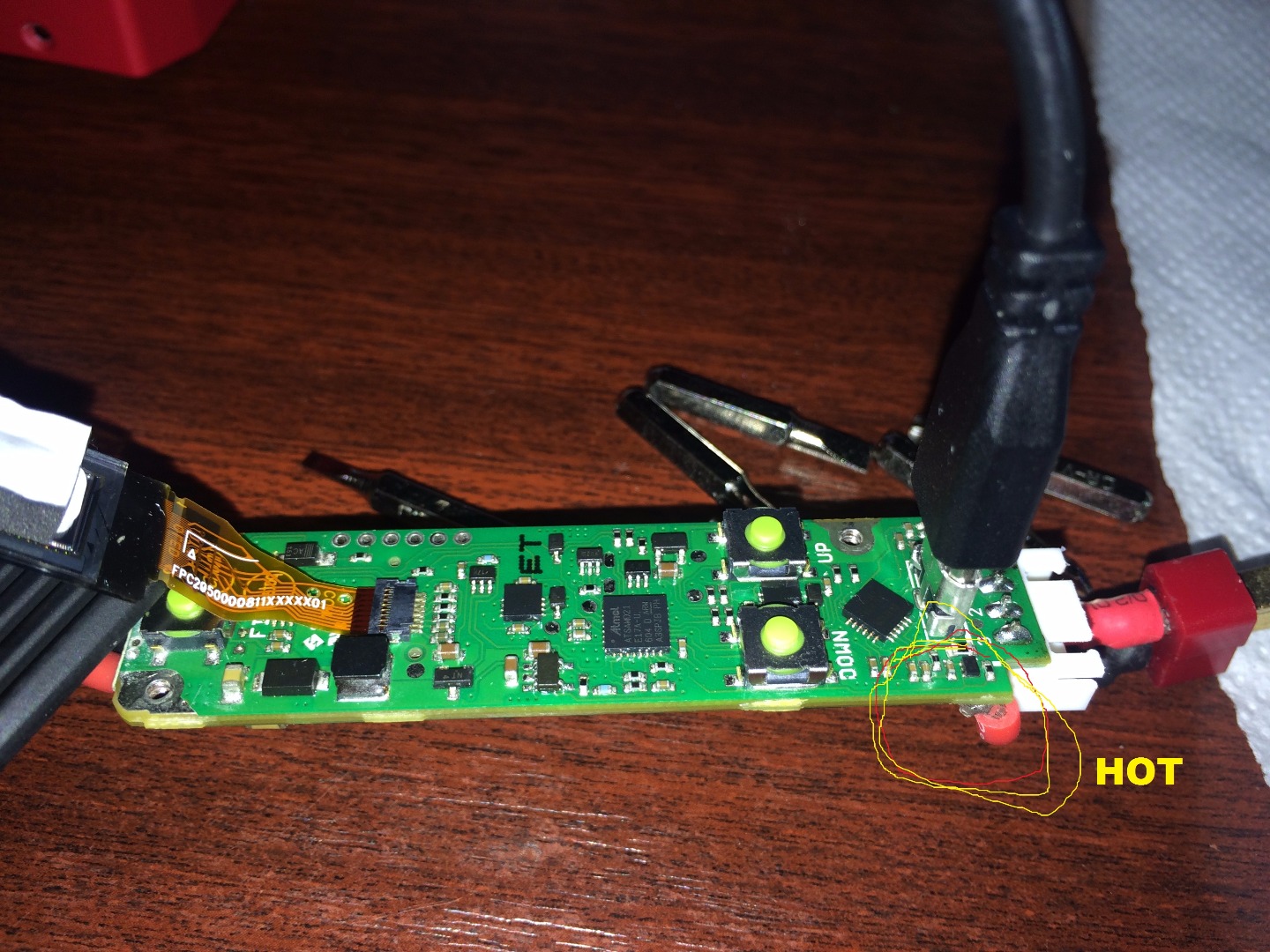

RedLabel Posted August 6, 2016 Report Posted August 6, 2016 I tried with 2cell Lipo... nothing... it shows 0.93 A from laptop USB ...and the 3 battery voltage does not increased .... I figured that near USB on the board is a very hot small area .... only on one side... Lipo was disconected...you have some photos with that area on my board.1. Do you think that an electrician can repair this board?2. Can i change this board with another dna200 from a Hcigar Vt133 where i`m charging batteries on an external charger and put there this dna200 wich fails to charge Lipo ?
BillW50 Posted August 6, 2016 Report Posted August 6, 2016 Well I wouldn't have switched it to two cell and especially tried to charge a three cell lipo.Can an electrician repair this board? Not likely.Yes you can swap the DNA boards between the VT133 and this one. Although now you are going to have problems with the VT133. Probably one cell might drain faster than the other.
RedLabel Posted August 6, 2016 Report Posted August 6, 2016 (I can not throw it in the trash that Dna board....only because it can`t charge ... it doesn`t seems to drains cells different on my li-po .... I opened VT133 and it is very tight inside than Panzer box.... it has a separate board for 18650 conection ....
BillW50 Posted August 6, 2016 Report Posted August 6, 2016 Yes I know, I have five VT133 myself. That extra board is for reverse battery protection. It would be totally useless on the Panzer. So you only need the DNA200 board itself. But the bad board I would contact Gearbest or Evolv and get it repaired or replaced. But will it work fine in the VT133? It probably would. And wow! That is a cool serial number on the VT133.
