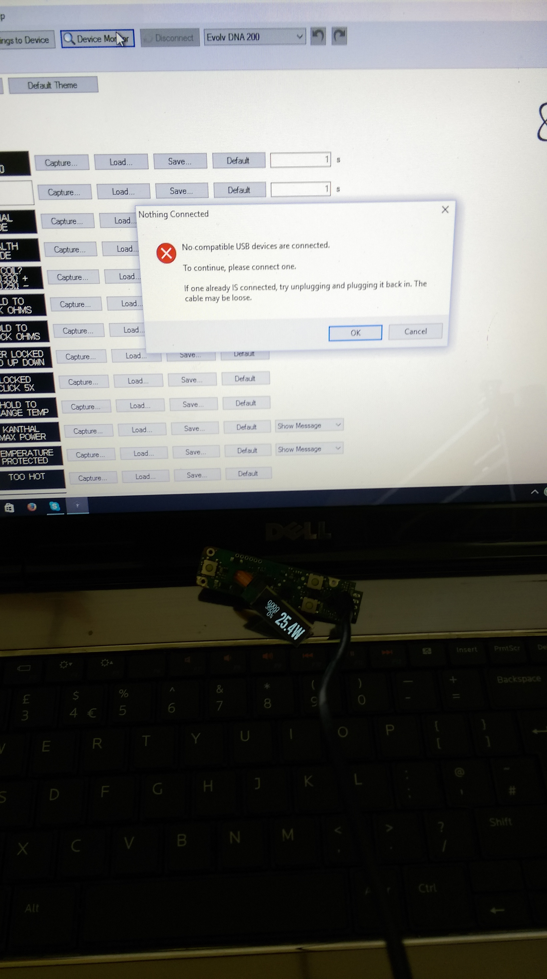

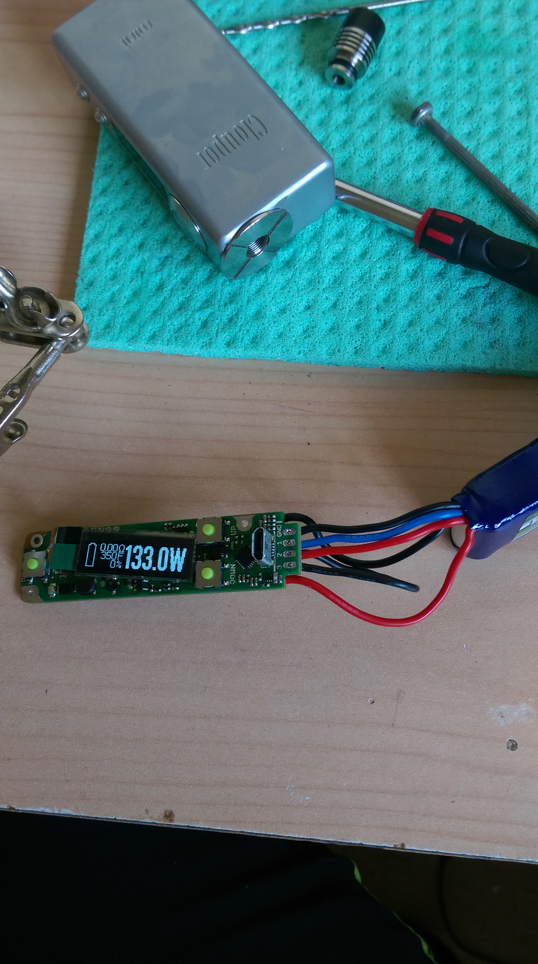

JoJo Posted August 11, 2015 Author Report Posted August 11, 2015 I got a problem this morning usb port stopped working not charging and pc not detecting board. Yesterday was fine. Board brand new

JoJo Posted August 11, 2015 Author Report Posted August 11, 2015 Yes tried different cable three pc win10 and win7. Connected battery to board works fine only usb port not working.
Gm111 Posted August 11, 2015 Report Posted August 11, 2015 JoJo said:Yes tried different cable three pc win10 and win7. Connected battery to board works fine only usb port not working. Right so nothing is coming up in escriibe as the usb isn't working obviously, the only thing you could do is speak to one of the evolv guys and see if they've had any problems in the past, if they havn't then they will most likely want you to send the board back to them and send you a new one or send your mod back and swap for a beta box. They should be online in a few hours.
JoJo Posted August 11, 2015 Author Report Posted August 11, 2015 When connected to usb it's power up but nothing on pc
Gm111 Posted August 11, 2015 Report Posted August 11, 2015 will you post a screenshot of device monitor with mod plugged in.
BobC Posted August 11, 2015 Report Posted August 11, 2015 Are you sure any of the cables you tried carry data?

JoJo Posted August 12, 2015 Author Report Posted August 12, 2015 Yes on the screen max 133w I selected before it's stopped working. P.s any of evolv team for support?

Guest Posted August 16, 2015 Report Posted August 16, 2015 One thing I noticed is that the board could flex (plugging and unplugging) if not secured causing the USB contacts to break or other board related problems
