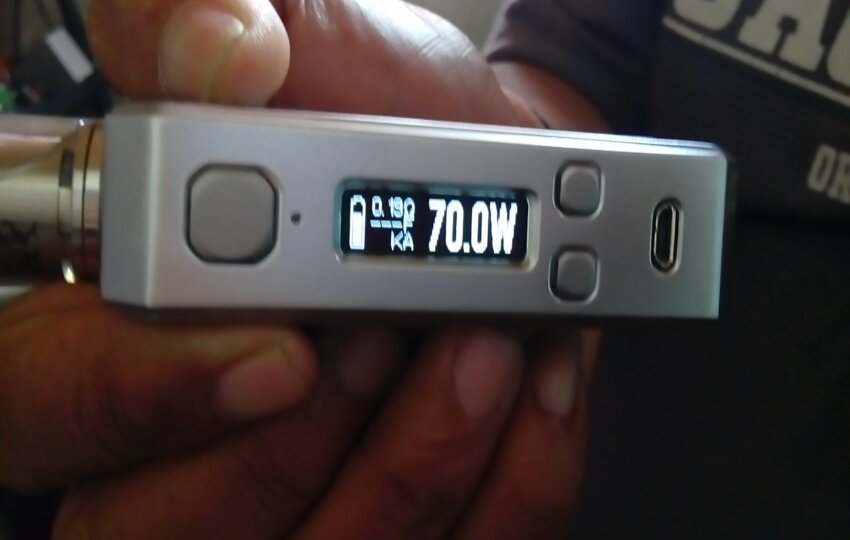

Hi guys,
It bothers me alot my therion DNA 75 is brand new but when i opened it to use it the first thing that bothered me is that there is no VOLT reading on the screen instead there is the ---F and KA at the bottom. Im not sure if this is normal but i have been using other DNA 75 and DNA 200 mods and i dont see this problem. Can someone tell me how to fix this. I just want to the normal setup which is Ohms VOLTS and amp. Please see attached pic for my problem.

welcome to the forum markace21. you have to go into the escribe program from a computer and change your screen display options. you can't do it from the mod, sorry. once you download the escribe program you can set the device up however you want it. i recommend that you watch the escribe tutorial video first before using escribe. be sure to post any questions you might have, here.

Thank you very much for the reply. Ill try to look up on youtube on the video on how to change this through the computer and apply it. Hopefully it will work.

Well I can tell you what I did, it will probably sound confusing but I opened Escribe v1.2SP3 up with out the device attached and I went to the Power Ctrl profile which I believe is profile #6 then I saved that profile and named it ES Power. Then I attached the Therion and went to the Watts profile provided by Lost Vapes and loaded the profile from Escribe that I saved there and replaced the one from Lost Vapes with the standard one from Escribe and it takes care of everything. The Escribe profile has the voltage in the 2nd spot just for that profile without changing your other profiles. That's probably about as clear as mud. I would say watch the tutorial and maybe Busardos review on the DNA200. I replaced a lot of Lost Vapes profiles with either Escribes or Steam Engines but Escribes Power Ctrl profile is better then Lost Vapes.
