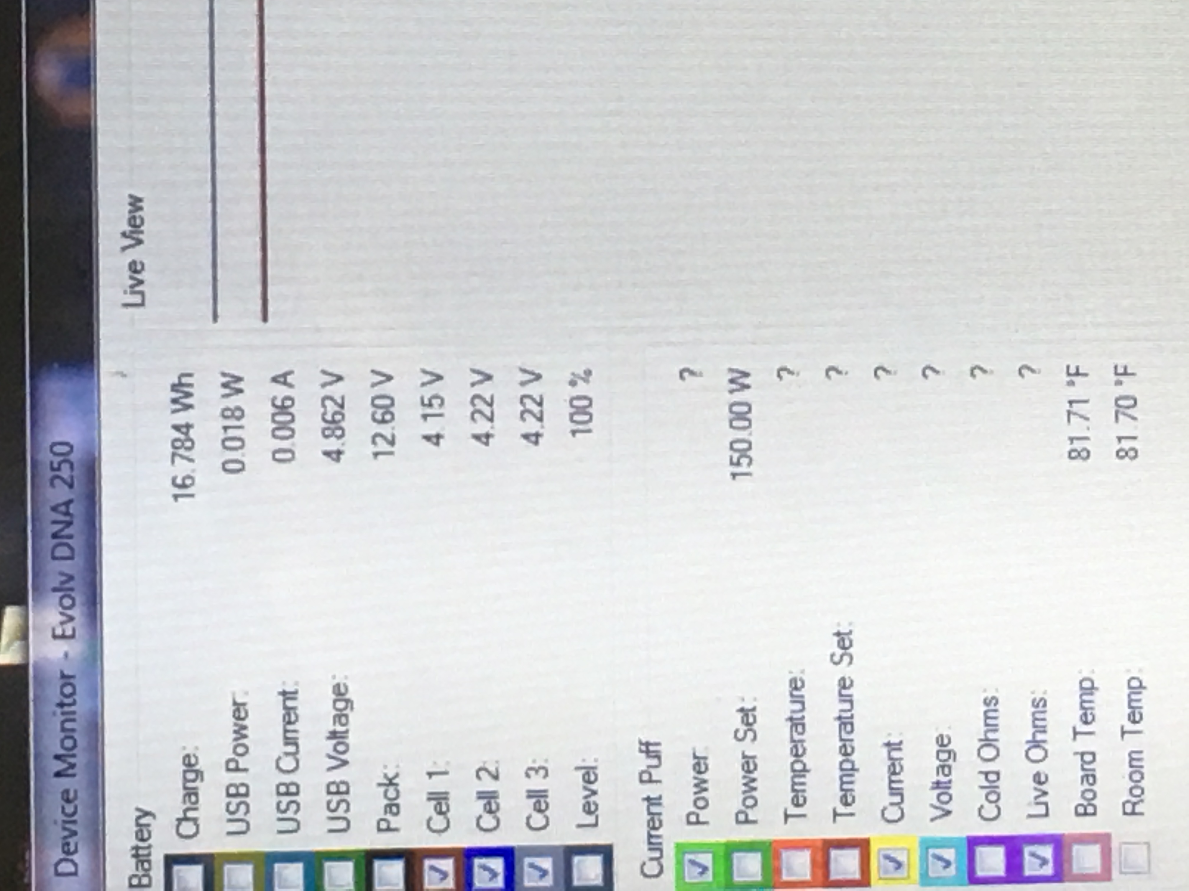

Doyle4 Posted September 25, 2016 Author Report Share Posted September 25, 2016 Hey guys,Anyone here played with the DNA250 yet? Hooked up a 3S turnigy lipo 1300mah, Noticed everytime i charge it via usb, they volts are uneven, cell one 3.47 volt, cell 2 3.43 and cell 3 was 3.17, Put the lipo onto my DNA200 board, charged it, used it till cut off, all blanched. Hope someone knows something. Thanks Link to comment Share on other sites More sharing options...

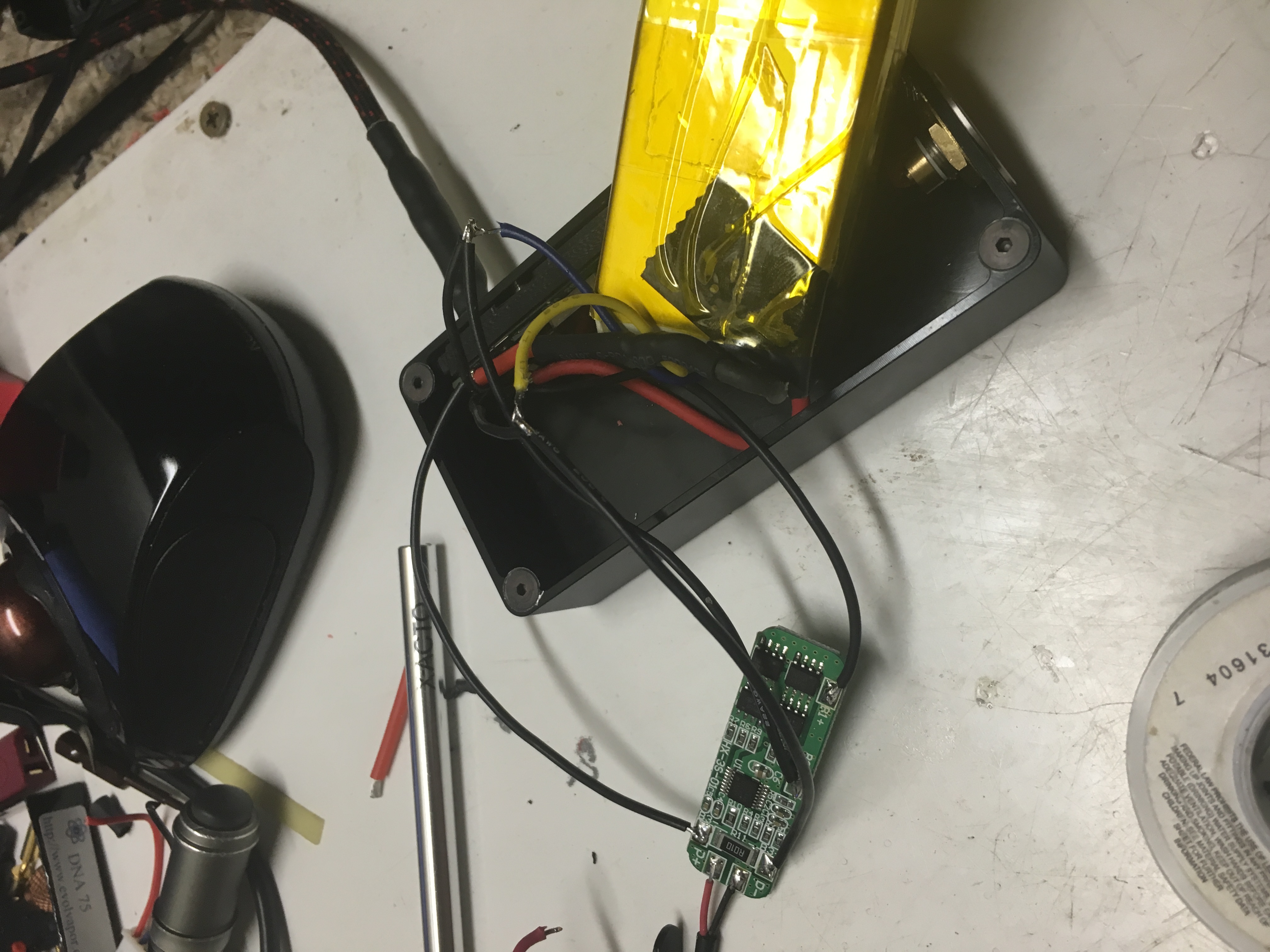

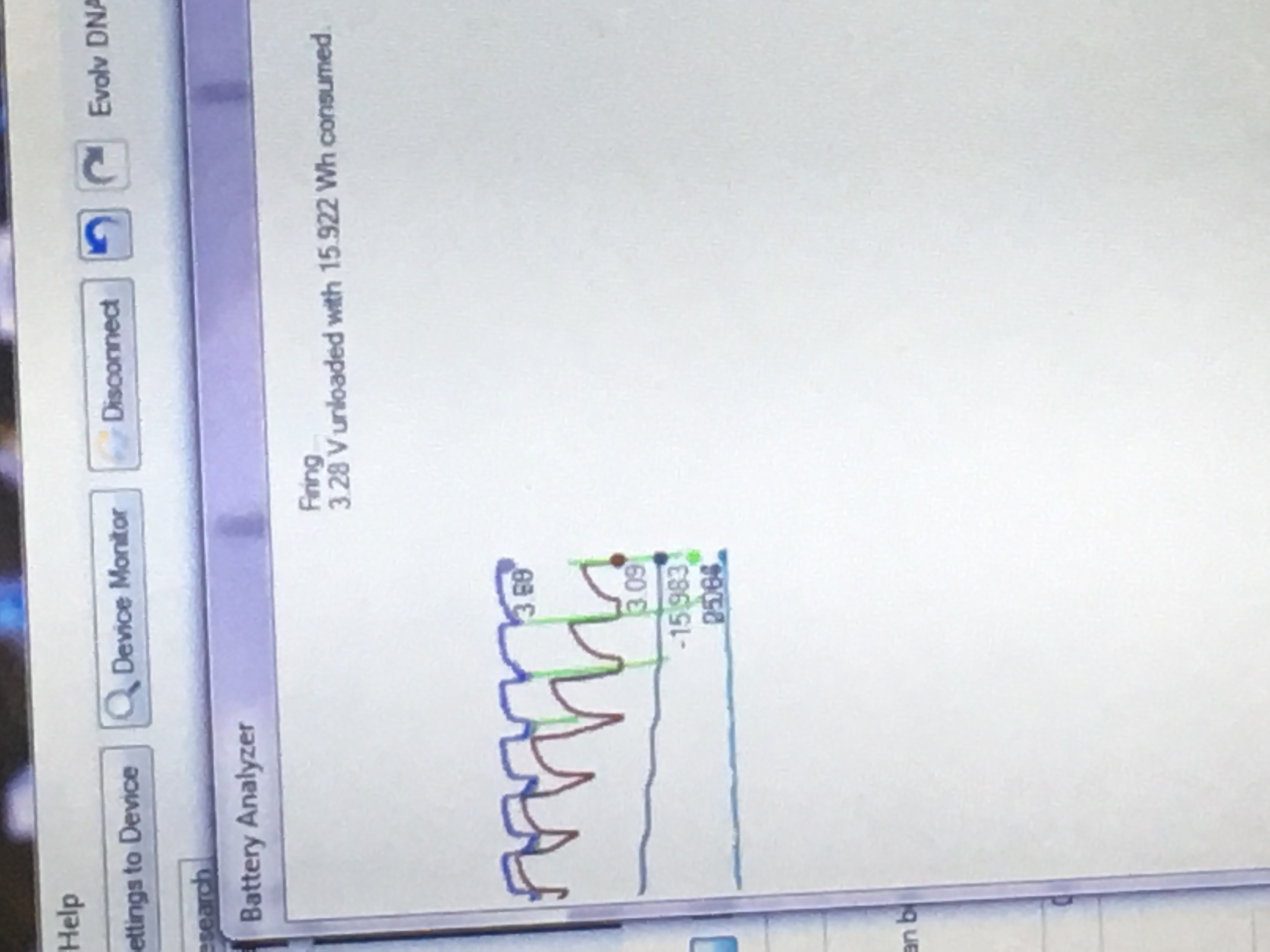

Frogmod Posted September 25, 2016 Report Share Posted September 25, 2016 I'm having the same oddity but for me it's cell 1 4.00v cell 2 4.10v cell 3 4.10v and it's done charging. I'm using a max amps 1850mAh. I can charge up cell 1 ( the last pack in a series ) by its self it charges fine while connected to device monitor. I've ran battery analyzer and cell 1 lags behind a little it's a new battery. Right now I'm running a 2nd test to see if it's doing it again, if it does I'm going throw it on my custom battery charger and watch all three cells charge. Link to comment Share on other sites More sharing options...
Spector NS5 RD Posted September 25, 2016 Report Share Posted September 25, 2016 have you guys checked the individual cells voltage with a DMM? are they actually imbalanced or just read as imbalanced by the 250? Frogmod, do you have it set to max RECHARGES or max PUFFS? Link to comment Share on other sites More sharing options...
Frogmod Posted September 26, 2016 Report Share Posted September 26, 2016 ChunkyButt200 said:have you guys checked the individual cells voltage with a DMM? are they actually imbalanced or just read as imbalanced by the 250? Frogmod, do you have it set to max RECHARGES or max PUFFS? it was set to max puff but I switched it to max charge. I did check it with the volt meter. I just got done doing a second battery analyzer. And cell 1 started to drain faster, it's charging now and it's lagging behind so I'm leaning towards the the battery at this point. Still testing it thow. Link to comment Share on other sites More sharing options...
Doyle4 Posted September 26, 2016 Author Report Share Posted September 26, 2016 Placed back into DNA250, drained battery to half, used diagnostic to check battery levels, all balanced, so its happening towards the last half of battery im assuming, changed cut off from 3.09 to 3.3 and going to see what its displays when 'dead' and charging. Link to comment Share on other sites More sharing options...
Frogmod Posted September 27, 2016 Report Share Posted September 27, 2016 For me it's the battery, I get the same results with the external balancing board Link to comment Share on other sites More sharing options...
Doyle4 Posted September 27, 2016 Author Report Share Posted September 27, 2016 Going to do battery analyser next to double check, but changing cut off voltage, seems to of helped, mine is also a brand new lipo so im hoping a couple charges can solve it, if not, new battery it is... Link to comment Share on other sites More sharing options...
