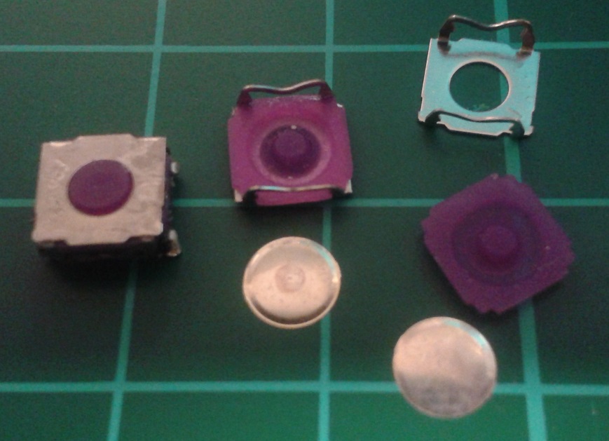

EScribe will show if the button is working.
If you decide to put in the 250 be sure to open a ticket with Evolv on the 200 board.....or open one now on what you have.
https://helpdesk.evolvapor.com/index.php?a=add
BTW, it's small stuff but most of the button can be disassembled/assembled (the button cover, button, disc)

Cheer's for the reply and info. I should have thought about sticking it on Escribe as that will show straight away where the problem lays, good call. If it does turn out to be the button i may just get one from RS in the UK if they stock an equivalent  , but will talk to Evolv beforehand.
