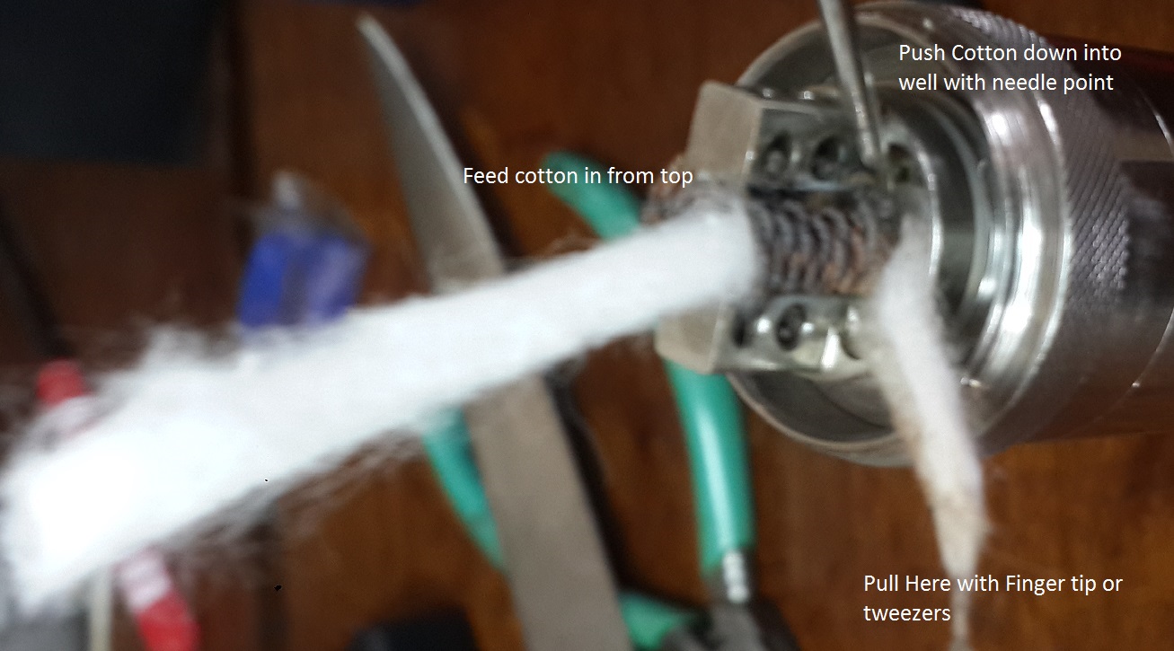

TrexWyo Posted November 28, 2015 Report Posted November 28, 2015 Any way I can get a pic of your build? With only finding 28g, I was thinking of doing twisted. I have a velocity decked Crius. Not sure how I'm going to wick for vertical. I almost hate to show a picture. It is a Very Ugly Coil but has lots of mass and surface area and vapes well. There isn't a lot of room under the bottom end of the coil. Maybe 3/16". Actually Looks more difficult than it is to wick a set of verticals. With a little practice, less than a minute to wick. Wicking requires long strand cotton. I use Japanese cotton. Regular organic cotton from a cotton ball doesn't work very well. Feed cotton into the top until it sticks out from the bottom a bit. Capture the tip of the wick with a needle point and fish it out to the side until you can grab it with finger tips or tweezers. With needle point press down on the cotton into the well while pulling out the tail. A two hand operation. Loosely fill the juice well with cotton and trim the top almost flush just a little above the top of the coil

Powerman Posted November 28, 2015 Report Posted November 28, 2015 TrexWyo said: Any way I can get a pic of your build? With only finding 28g, I was thinking of doing twisted. I have a velocity decked Crius. Not sure how I'm going to wick for vertical. I almost hate to show a picture. It is a Very Ugly Coil but has lots of mass and surface area and vapes well. There isn't a lot of room under the bottom end of the coil. Maybe 3/16". Actually Looks more difficult than it is to wick a set of verticals. With a little practice, less than a minute to wick. Wicking requires long strand cotton. I use Japanese cotton. Regular organic cotton from a cotton ball doesn't work very well. Feed cotton into the top until it sticks out from the bottom a bit. Capture the tip of the wick with a needle point and fish it out to the side until you can grab it with finger tips or tweezers. With needle point press down on the cotton into the well while pulling out the tail. A two hand operation. Loosely fill the juice well with cotton and trim the top almost flush just a little above the top of the coil thanks. Ya, I assumed you wrap cotton around the outside with vertical. Didn't know you could do it that way. Clears up a lot. thanks a lot.
TrexWyo Posted November 29, 2015 Report Posted November 29, 2015 This build is going to be hard to beat for Unkamen's Nickel Free 28 gauge SS 430 that results in a stable temperature. It is 16 wraps of twisted annealed 28 gauge around 3mm arbor at about a 1.5 pitch. Came in at .445 cold ohms. Twist pitch ended up at 1.5mm A lot looser than I wanted but that is where the ware broke. When I replace this coil I'll Anneal the wire before twisting instead of after to see if that gives me a tighter pitch which should increase the cold resistance a little more. The graph below is about a 5 second vape in a 10 second window. Set for 90 watts, 1 second 150 watt preheat. Vertical coil on a Steamcrave Aromamizer. Going to kill a battery quick though.
TrexWyo Posted November 29, 2015 Report Posted November 29, 2015 Here is that build above. not quite the flavor production as the 2 wire twisted with two twisted wires I was using before though. Close though. More wattage might help that though.

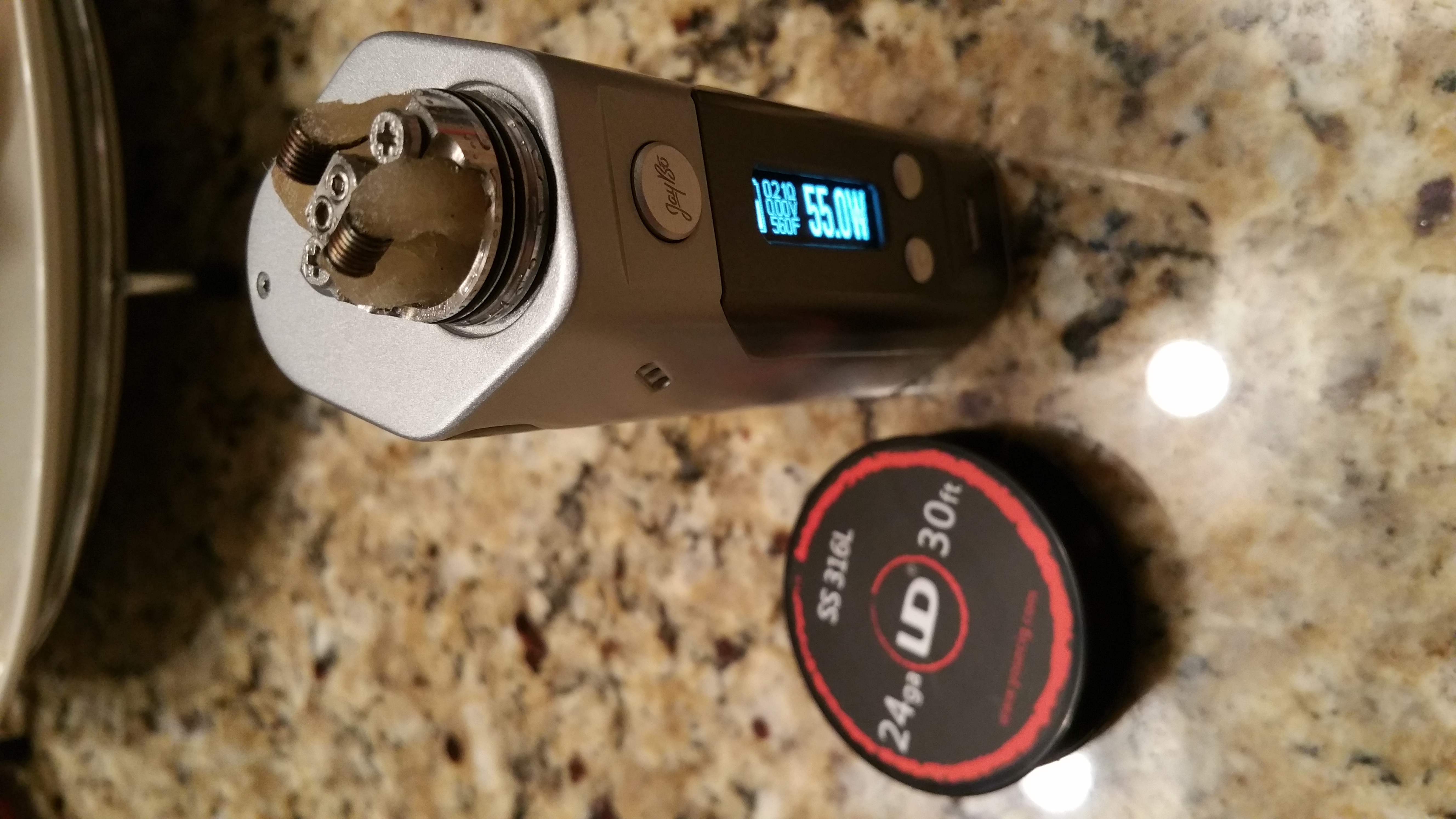

jj6404 Posted November 30, 2015 Report Posted November 30, 2015 I just put a dual coil twisted 24g UD 316L 10 wrap, 2.5mm ID build in my Twisted Messes RDA and at first it kept popping out of TC. It came out to 0.1 ohms, wonder if that's the reason. It's been working somewhat on Jaquith's files but I have to set the temp low because it seems to be reading it real low. I was thinking of making a CSV with the Wire Wizard but knowing that Steam Engine's 316 CSVs suck already, I wonder if making a twisted CSV will be any better.
Jaquith Posted November 30, 2015 Report Posted November 30, 2015 Every SS build I do, Preheat is off (1,1,0) and version V3 is the most accurate and all the variations between V3 to V4 are warmer with V4 the hottest. I have a V2 that's cooler. I do know this, some Atty's have resistance jumping problems. SS requires rock solid connectivity, small changes produce big variations. LOL I had one Atty that jumped from 0.20 to 1.20 when I noticed it didn't fire, and another with a short that went down to a 0.06 with an absolute horrible taste and a popped coil. So a lousy 510, loose wires, partial shorts, sketchy press fitted connections and settings can all adversely effect performance.
