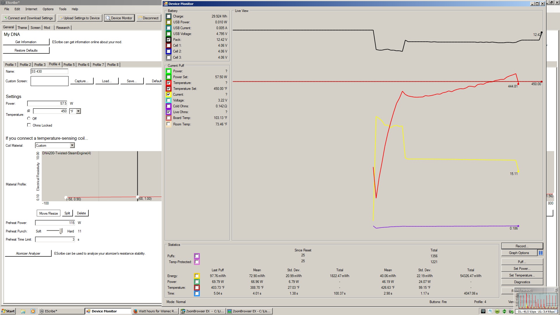

TrexWyo Posted November 26, 2015 Report Posted November 26, 2015 I am getting what I call very acceptable results with nickel free stainless, Grade 430. It has a higher TCR then grades 304,316 or 317. My build is dual vertical coils of 6 wraps of twisted/twisted 28 gauge around 2mm arbor. I do this by twisting 2 wires tight times two and then twist two twisted strands together at double the twist pitch. This results in a coil that delivers Clapton like flavor and clouds that is far easier to make. I use a modified SteamCrave Aromamizer RDTA, Velocity deck, that has LOTS of airflow. Flavor and clouds are great.

Powerman Posted November 27, 2015 Report Posted November 27, 2015 TrexWyo said:I am getting what I call very acceptable results with nickel free stainless, Grade 430. It has a higher TCR then grades 304,316 or 317. My build is dual vertical coils of 6 wraps of twisted/twisted 28 gauge around 2mm arbor. I do this by twisting 2 wires tight times two and then twist two twisted strands together at double the twist pitch. This results in a coil that delivers Clapton like flavor and clouds that is far easier to make. I use a modified SteamCrave Aromamizer RDTA, Velocity deck, that has LOTS of airflow. Flavor and clouds are great. Attached is a screen print of my results. Any way I can get a pic of your build? With only finding 28g, I was thinking of doing twisted. I have a velocity decked Crius. Not sure how I'm going to wick for vertical.
