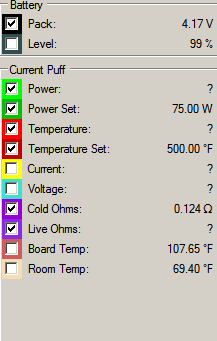

hi mikode.... if the dna does not sense a rise in resistance, while firing, within a set amount of time (1 second) it will kick you out of temp control. make sure you have 316L selected as the coil material in the mod. make sure your connections are secure (atomizer, coil wires, spaced coils). what brand of SS316L? what atomizer? "mod resistance" set correctly? post a screenshot of device monitor while firing the atomizer in temp mode (SS316L). make sure these boxes are selected

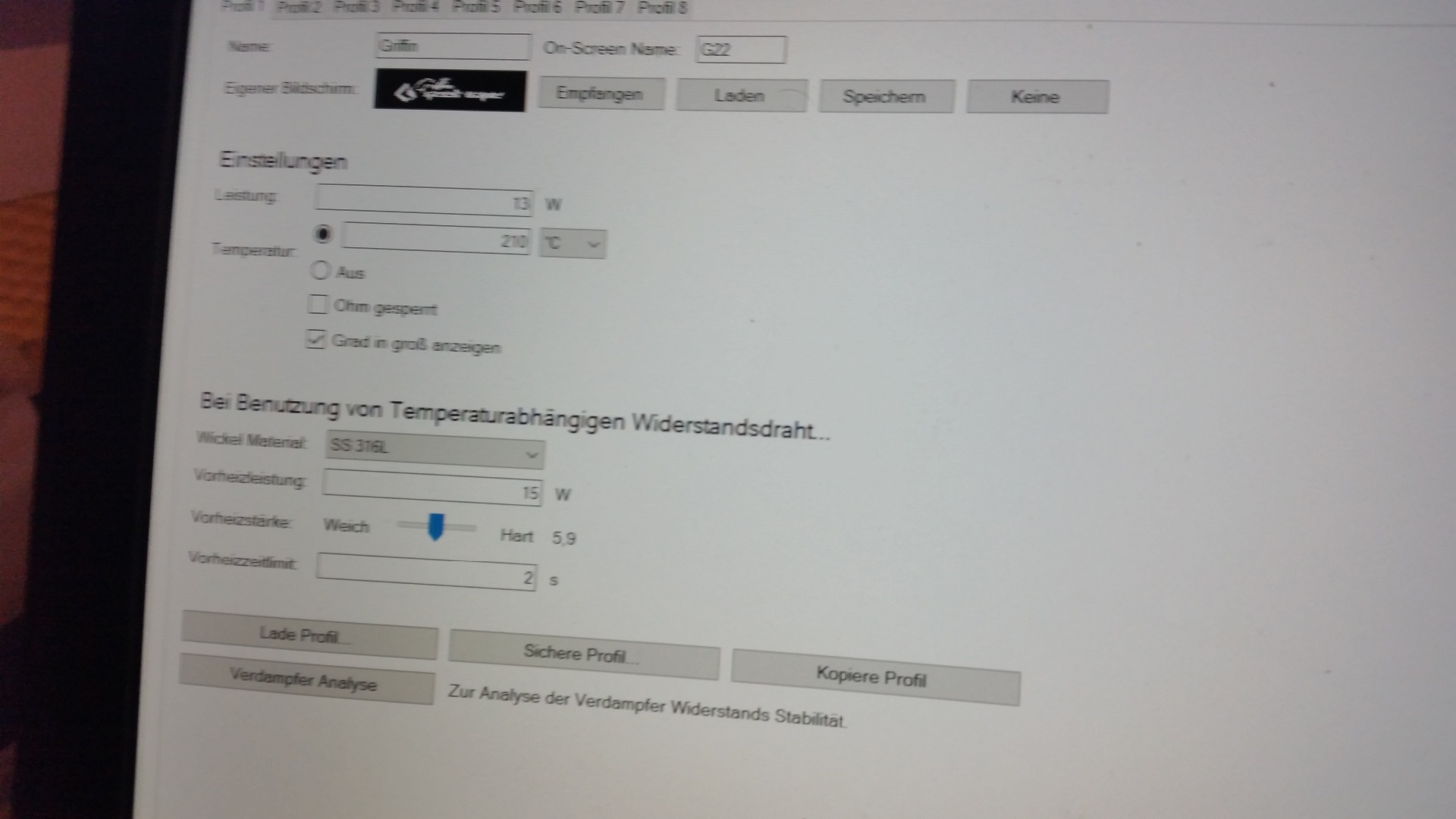

Set the Power down on 15 Watts
the temp on 210 Celsius (400 F)

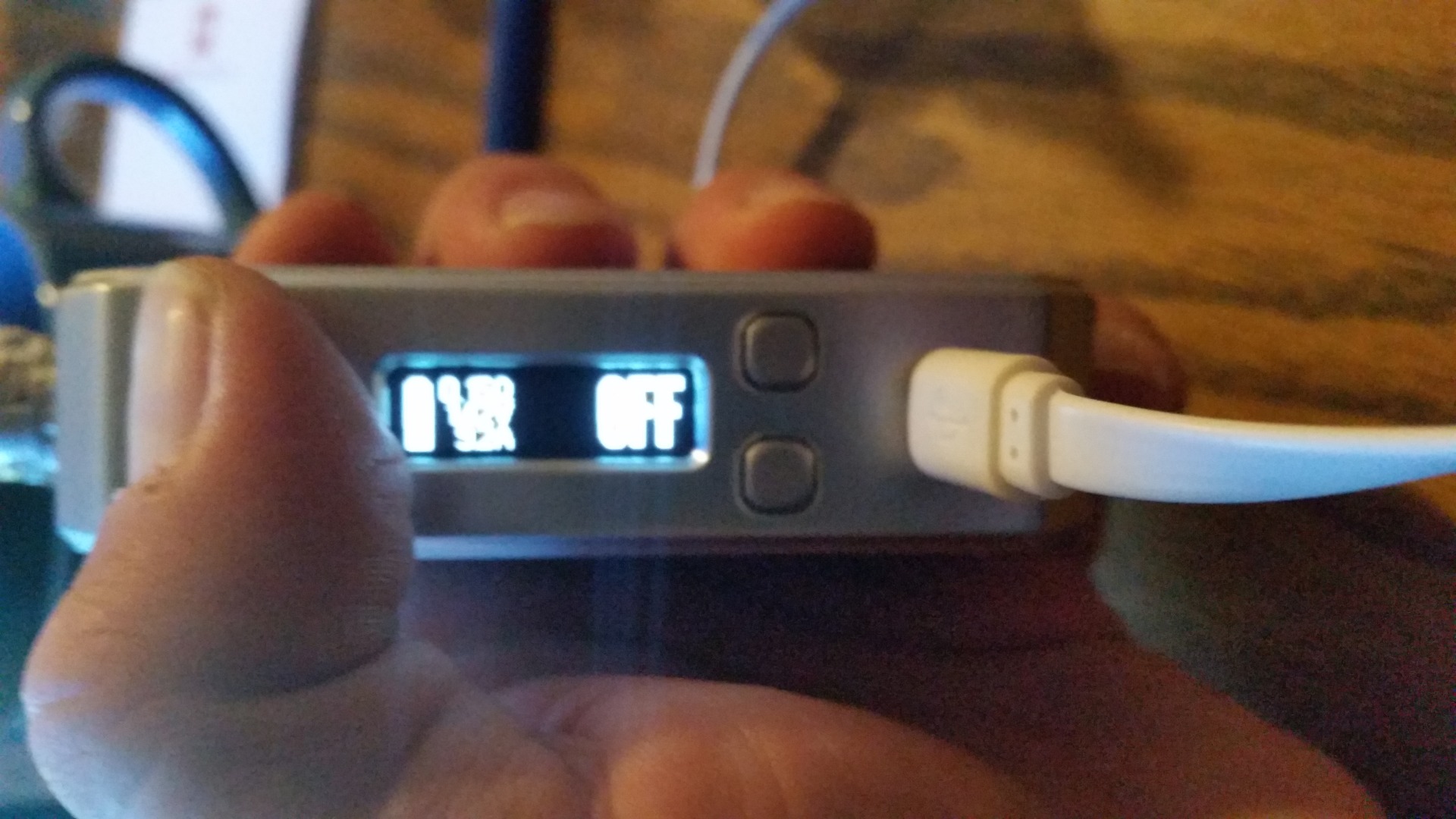

just a questionmark on the place where the temp should be

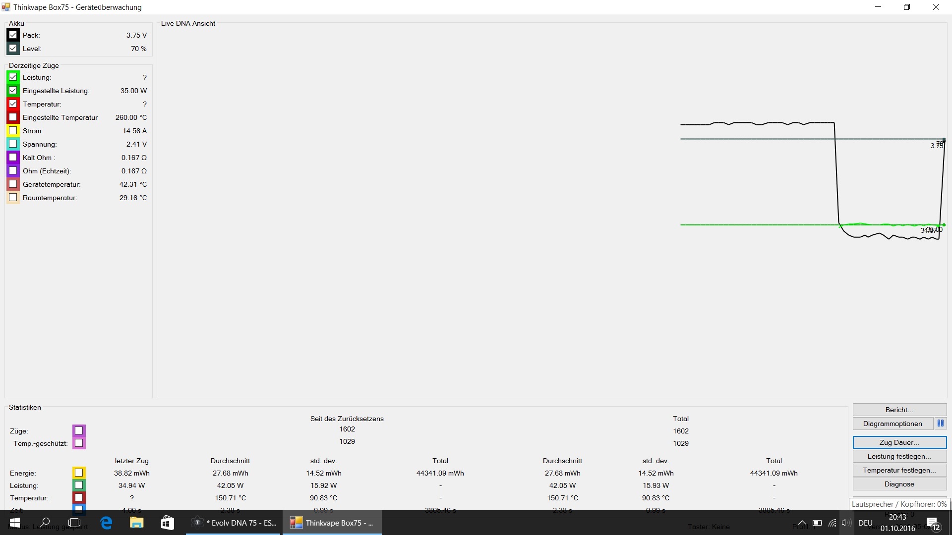

I don't want to tell you what settings to use, but will offer that I am using 316L in a DNA200 at a power of 40 watts and temperature set at 520F, ~270C, in a dual coil Aromamizer, say 20 watts per coil.  It is possible that you are not applying enough power for the DNA to see a change in resistance.  What Chunky was looking for was the graph generated in device monitor as the device is fired.  That will show the live resistance of your coil as it heats.

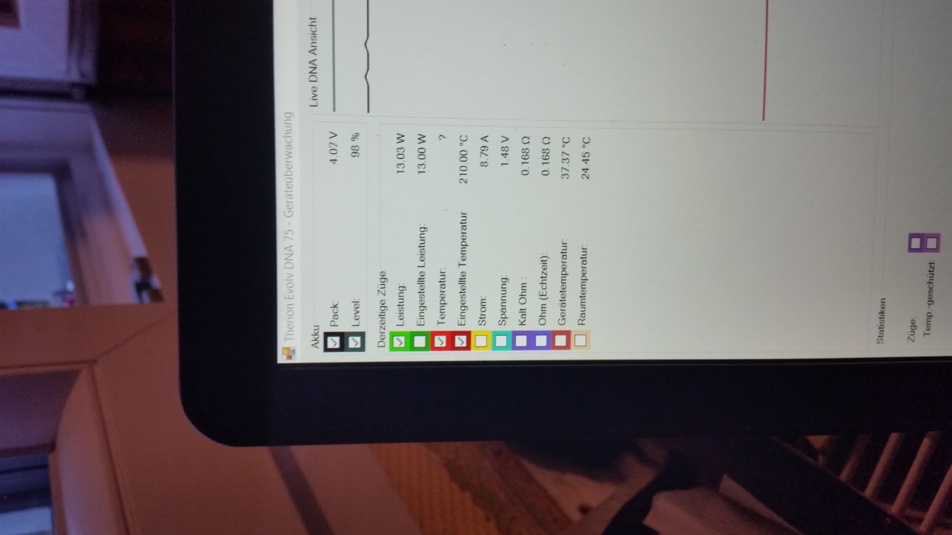

I changed everything on both Therion and Box75 in the first second temp will be displayed and then there is written off as in the earlier post...
but Temperature is just a questionmark in evolv software....

Well, looking at the graph, on the right, it's showing cold ohms and firing ohms at the same resistance.  Are you sure the wire is SS 316L?  Who is the source of the wire?

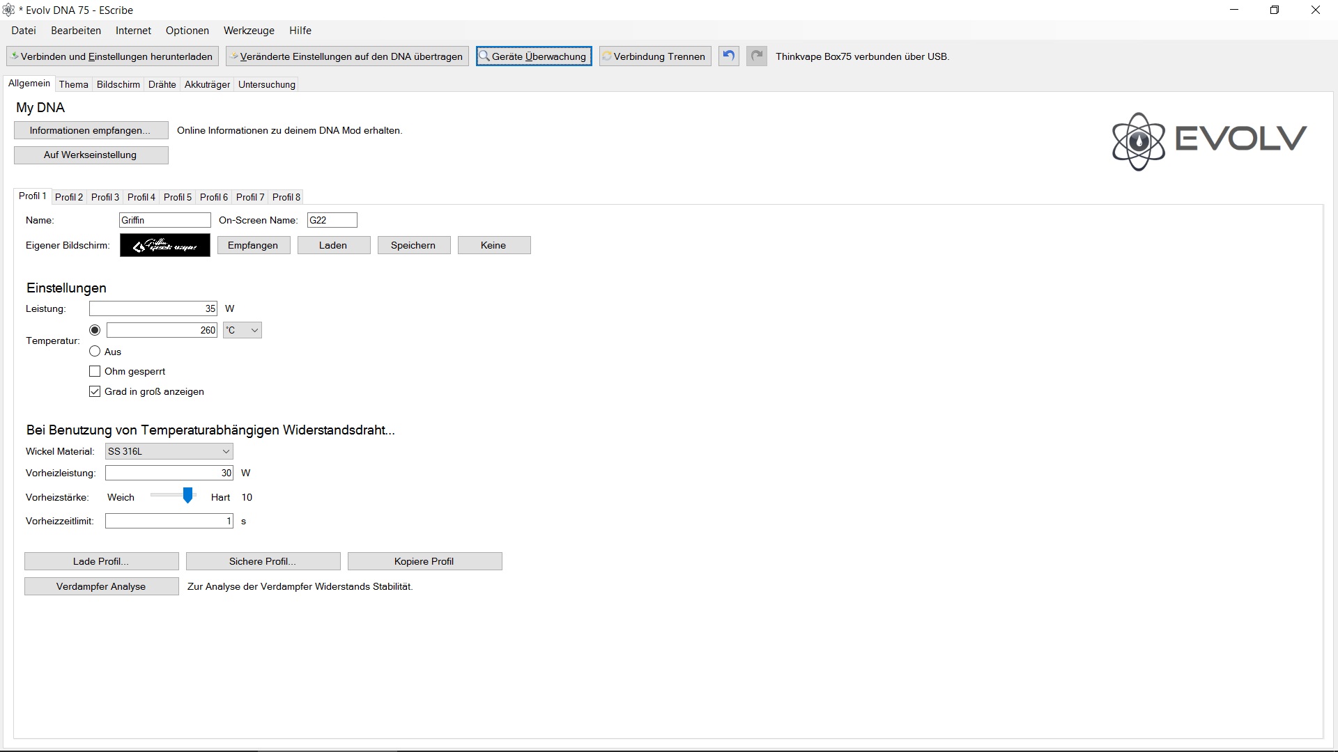

Temperature protection message is not anything to worry about, it is just an info message that you have gone past temp and you can turn it off in EScribe.   If it works with Ni it is probably the wire, connections or the coil build.  If it is too hot then the cold res reading could be too high, but as long as you do not lock resistance the mod should be able to compensate for that after idling of 10 or more minutes. Claptons can suffer from hot spots so are going to be the hardest types of coils to track down an issue with,
Posted
If you're having problems with the device going out of TC mode and you are 100% sure you have the right settings in Escribe (316L stainless steel profile downloaded from Steam Engine, imported and set to a profile in Escribe; uploaded, and activated as a profile on your device) you might want to contact the retailer.
