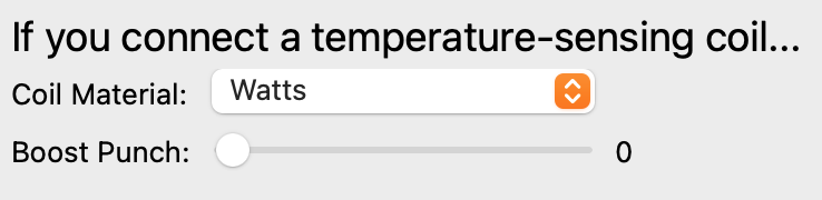

  • Wayneo changed the title to preheat kanthal dna75 (2022) Just use Boost Punch
Posted
This is a 5 year old post. On all boards except the OG DNA200, no trickery is needed. Just use the Boost Punch feature for a 1 second proportional watts increase
