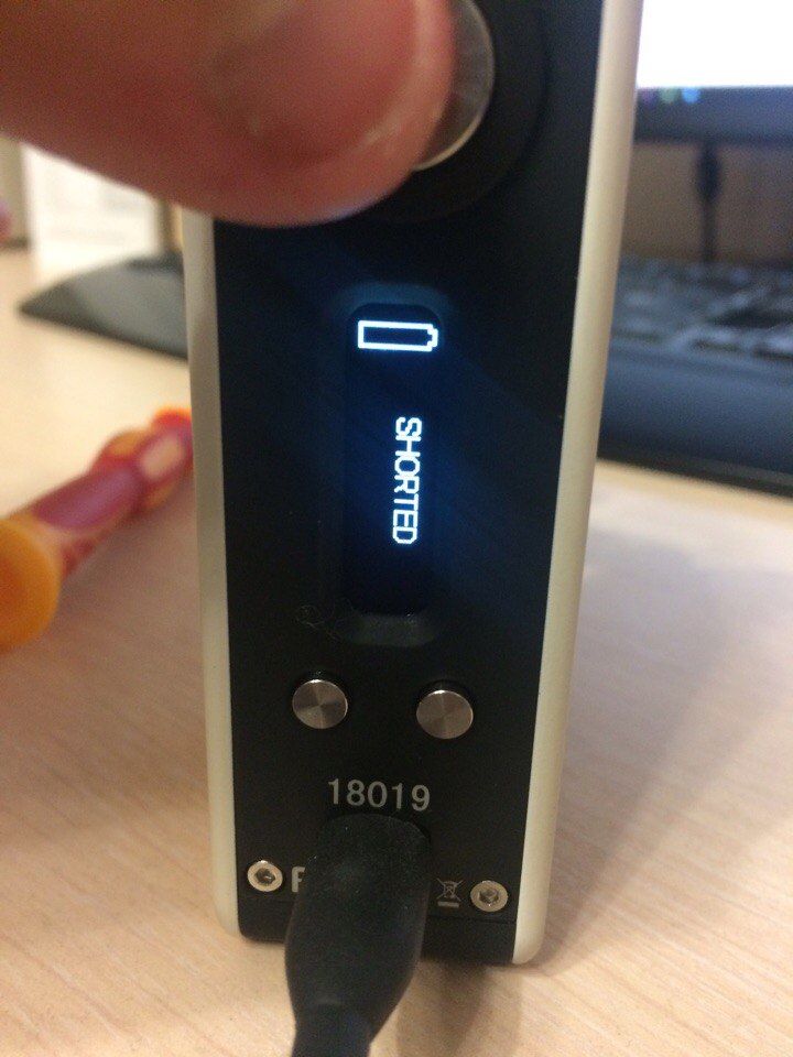

drzed Posted October 30, 2016 Author Report Share Posted October 30, 2016 Hello, I've got a real problem:My mod doesn't work, I guess, it's battery trouble.Everytime on the screen "SHORTED" and battery status 0.What can I do? This is new mod from GearBest (bought about 2 weeks ago)I hope you help me. With best wishes, Vladimir Link to comment Share on other sites More sharing options...
Spector NS5 RD Posted October 30, 2016 Report Share Posted October 30, 2016 the reason it's saying shorted is because the board sees NO battery connected. the board is being powered strictly from the USB cable. make sure your battery connections/taps are secure and making good contact. you could try "USB recovery charge" from escribe. doubt it will work though. i open a ticket with gear best. Link to comment Share on other sites More sharing options...

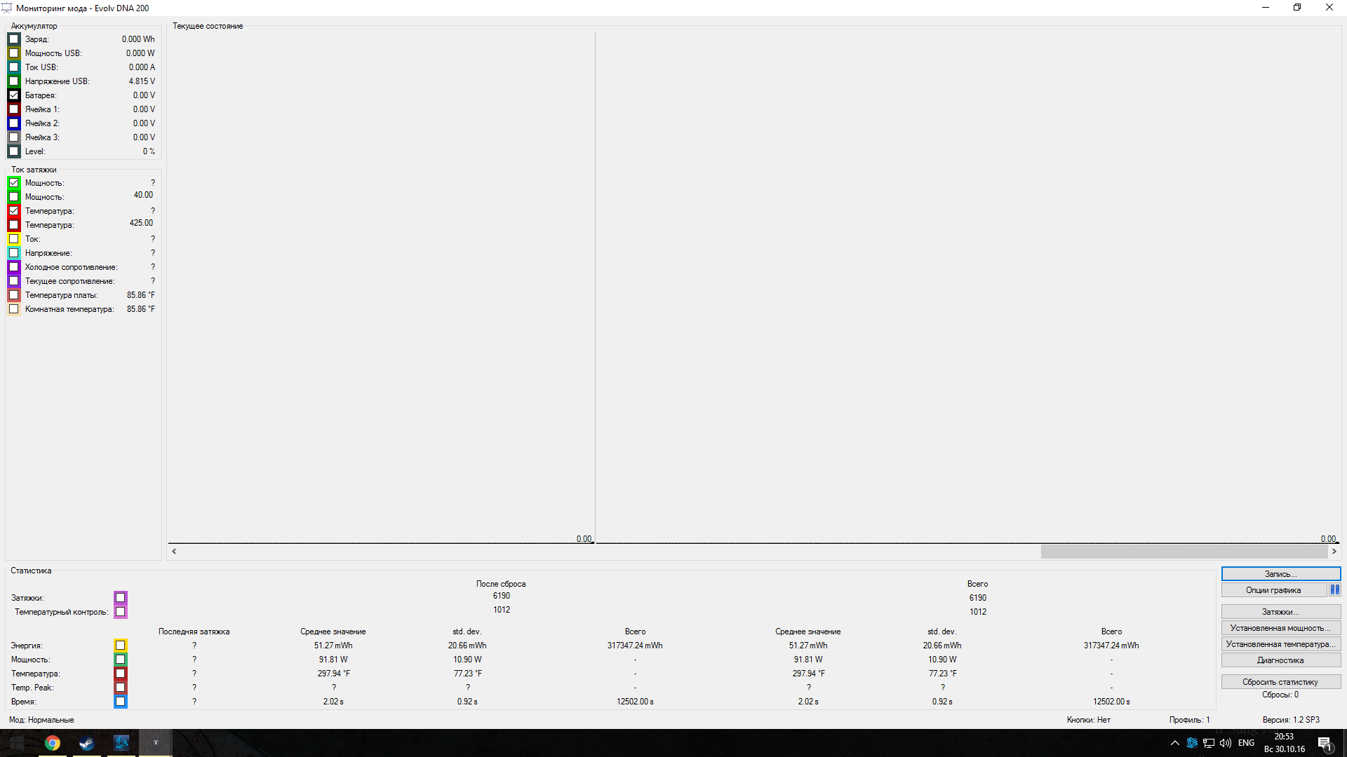

drzed Posted October 30, 2016 Author Report Share Posted October 30, 2016 ChunkyButt200 said:the reason it's saying shorted is because the board sees NO battery connected. the board is being powered strictly from the USB cable. make sure your battery connections/taps are secure and making good contact. you could try "USB recovery charge" from escribe. doubt it will work though. I'll try to reconnect Li Po, then my mod turn off, when I put battery back - he shows again "shorted" and 0 charged ...I make "usb recovery charge" but that's not help. He doesn't see battery level Link to comment Share on other sites More sharing options...

drzed Posted November 1, 2016 Author Report Share Posted November 1, 2016 I think dna200 or connector broken, cause LiPo battery working perfectly... Link to comment Share on other sites More sharing options...
