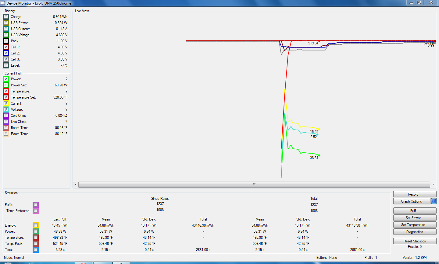

Modbustersecig Posted November 16, 2016 Report Posted November 16, 2016 i just built this DNA250 num 3 cell i am wondering if i should replace the lipo looks like a week cell ?
dwcraig1 Posted November 16, 2016 Report Posted November 16, 2016 Not much difference, give it some time charging/using, it should balance.Then see how it does under load.After looking at it more ...maybe, see if it continues after some cycles.
