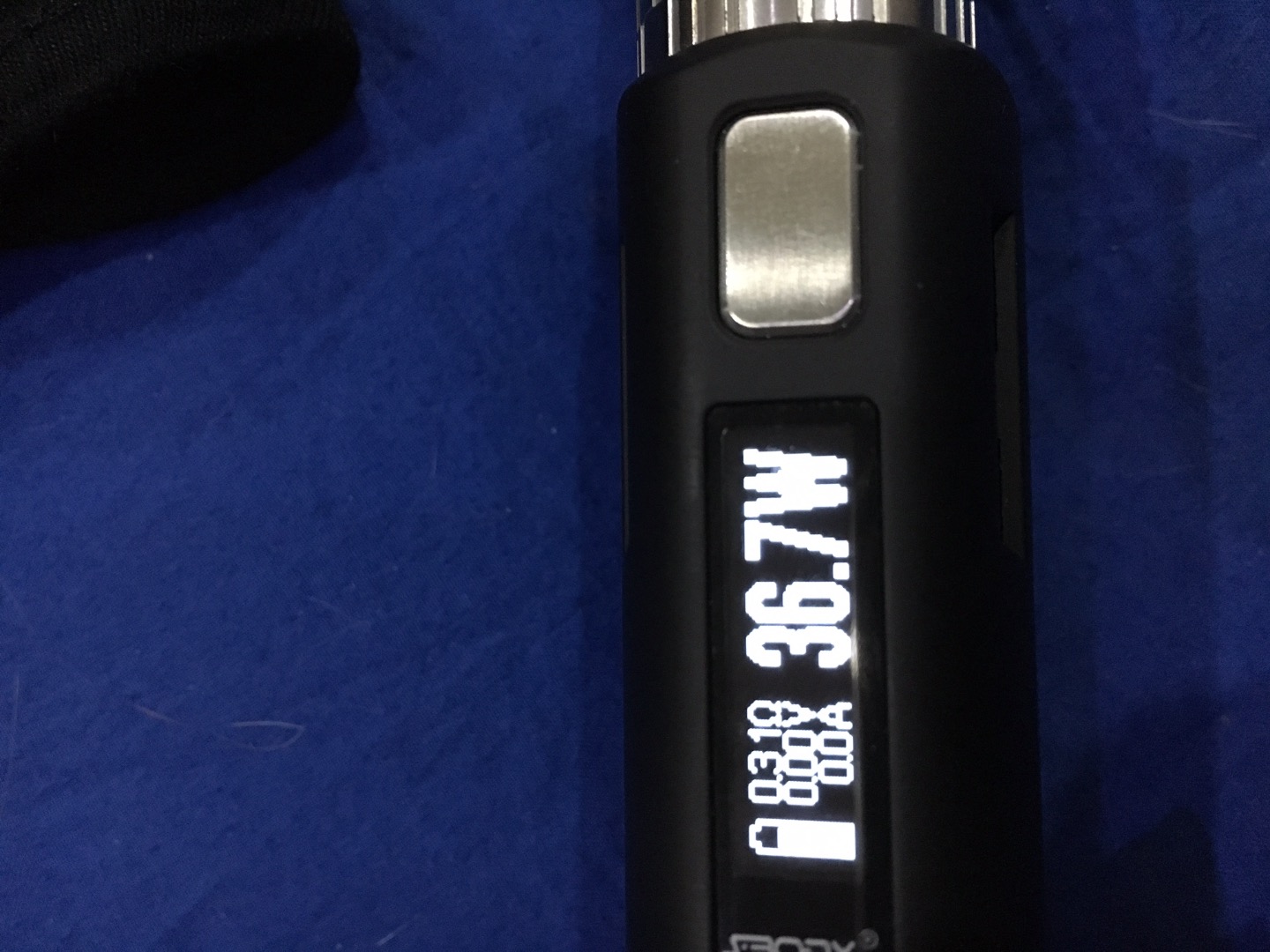

isnehal Posted November 20, 2016 Author Report Posted November 20, 2016 Hello Guys,need 1 quick help, I just brought a new mod and tank Arctic mini v8. The tank has tiger coil which I believe is 0.3oms, but my mod showing it as 0.31oms. should I be worried about this? earlier it showed 0.3oms with locked symbol on it. I believe after pouring juice it's showing 0.31oms. I m a newbie not sure whats going on.
retird Posted November 20, 2016 Report Posted November 20, 2016 No worry.... I never lock ohm's....locking ohms prevents refinement..
retird Posted November 20, 2016 Report Posted November 20, 2016 The DNA has a refinement feature. Here is a short version @VapingBad posted about refinement:Ever since the 40 they have used refinement to get an accurate resistance reading that compensates for environment and some internal resistance, so there is no need to manually adjust resistance. After you have taken a few puffs on a new build let it sit for a bit (5-30 mins, normally 5 is enough), the board will monitor how the coils cools and with a estimate of room temperature from a sensor on the board and calculate the base resistance. Because it takes temperature into account, a range of temperatures, it is probably the most accurate resistance reading possible.
