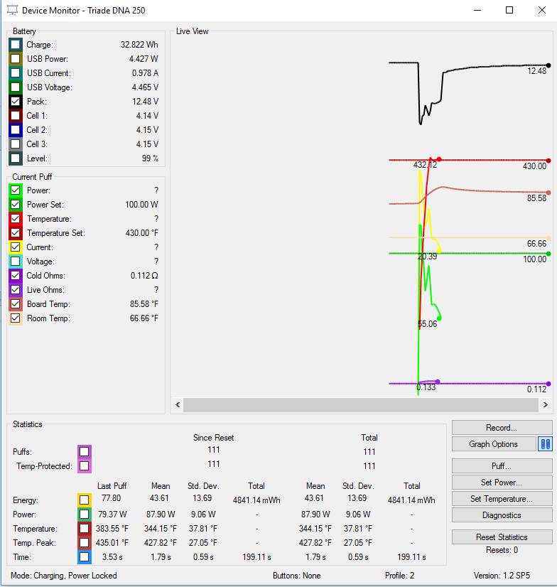

Viruk Posted December 4, 2016 Author Report Posted December 4, 2016 Quick update: I've used the new set up a little last night, keeping an eye on the voltages in device monitor. Its stood unused overnight and then fired fine this morning. The voltages have stayed even across all the cells and there has been no noticeable heat build up anywhere. This shot does show a very slight variance on one cell of 0.01v but that levelled out again within a few seconds. I'm still interested in hearing from anyone who either has any information on safety concerns or if anyone has had a similar experience with a new 18650
Wayneo Posted December 4, 2016 Report Posted December 4, 2016 @Viruk, looks just perfect man. I see you have it set at 100watts, and look at the ramp up to your temp. Just freakin perfect.There are 2 different camps for TC.Set your wattage high (like you did, and I do), and let the board do its job. ORSet your wattage much closer to the actual usage, and play with punch and preheat.2 different ways to skin the cat, neither is wrong, just different. Now if you really want to see just how great it all is, down in the bottom right hand corner, there's a button called 'puffs'. Set your mod down, click that button (I usually just choose 4 seconds) and your mod will fire, as if you were taking a 4 second vape. Go look at that smooth line, and how few watts are required to maintain that temp.And with these boards (unlike many others) you should never lock the resistance (unless you have a shitty build)
