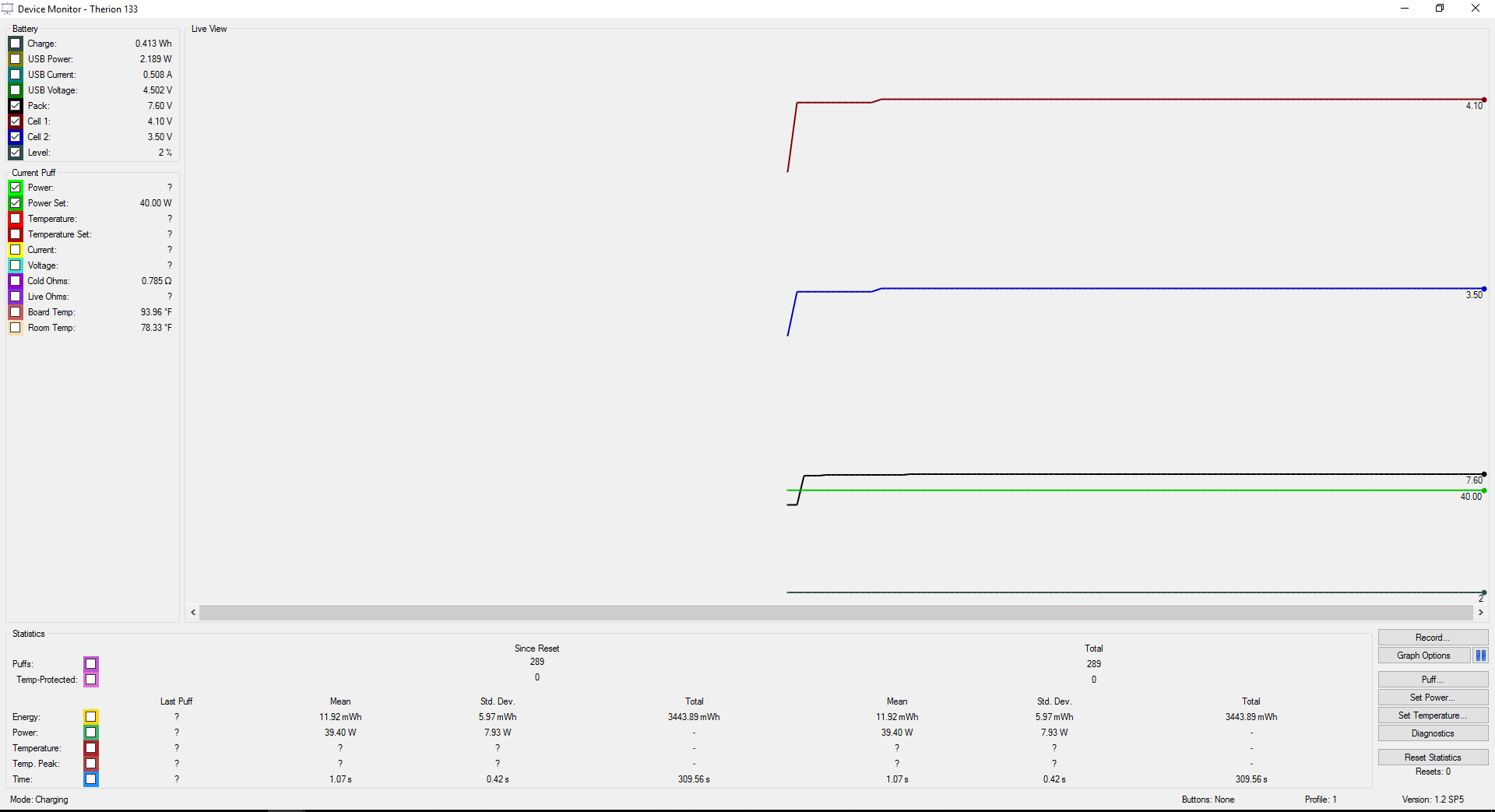

Alvon Posted December 26, 2016 Author Report Posted December 26, 2016 Hi Guys, I just bought brand new Therion DNA133, but when i plug the 2 (AWT RED 3000mah 40a) 18650 battery (Fully charge) the battery indicator on screen is showing that is empty. but the mod it self is fully functional.Can you guys help me to solve this issue? because i think that is only problem on the EScribe setting. below is the screenshot of my current setting. Thank you
Spector NS5 RD Posted December 27, 2016 Report Posted December 27, 2016 welcome Alvon. your cells are imbalanced. cell 1- 4.10 / cell 2- 3.50. i would double check their voltage, individually, with a DMM or standalone charger or you can swap the cells around, in the therion, and see if the corresponding voltages follow the cells in device monitor and report back. if the cells are in fact imbalanced from each other, you need to charge them separately, out of the therion. if the cells are not imbalanced, something is getting in the way of the DNA board reading the correct cell voltage. could be a poor/dirty battery contact.
Alvon Posted December 27, 2016 Author Report Posted December 27, 2016 Hi Chunky,Thank you for your responses, i will note that.But now the problem is solved after i am fully re-charge my battery overnight. and i will re-check on device monitor.Thank you.
