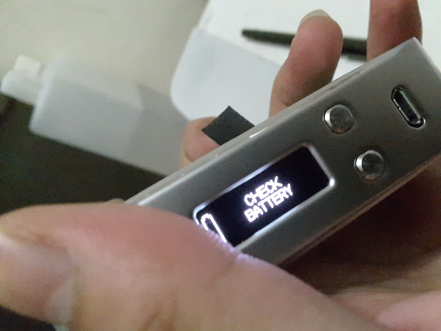

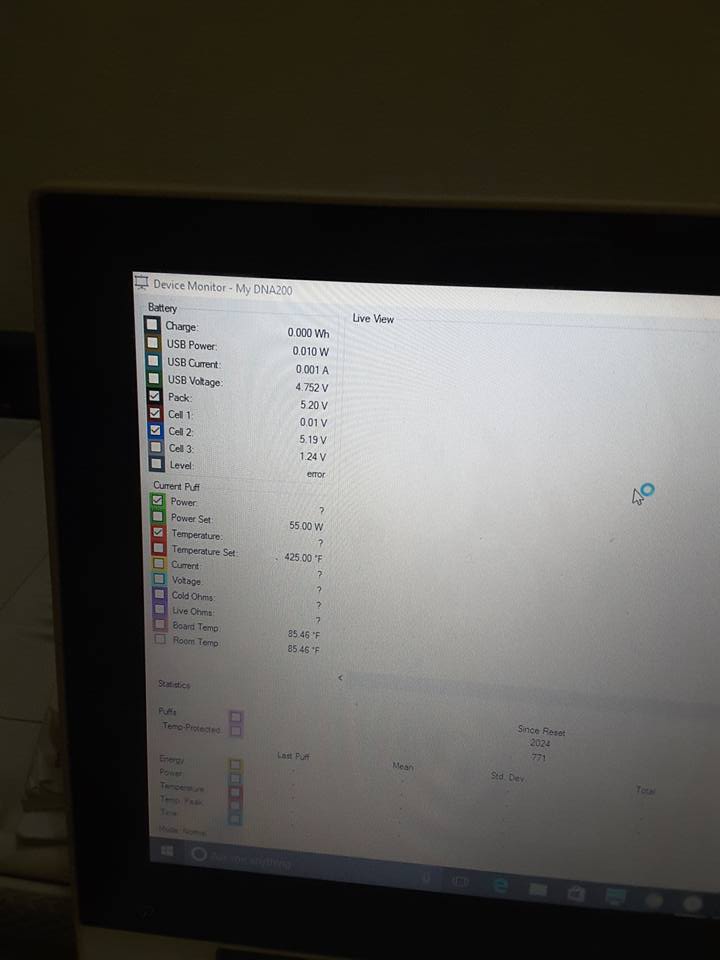

Im having trouble with check battery with device finder 133 dna chip 200 from thinkvap My device cant turn on , when im firing the device on and when i release firing button it shut down the device, my mod show check battery It will turn on via usb plug only And when i check via escribe in device monitor cell 1 is dead on 0.01 and cell 2 at 5.00 cell 3 at 1.2 .finder is 2 battery mod im already set my my battery wattage at mod. Im using 2 battery like samsung lg, still dont work This is common problem with this device in indonesian Can somebody explain

welcome to the forum Kudzako. you can try hard and soft reboot from escribe and also try re-flashing the firmware. the reason the device will not stay on is because it's not reading one of the cells, more of a symptom than a cause. you either have a bad/broken connection regarding the battery to the board or the board has failed. you're 100% positive BOTH cells are fully charged and balanced?  if you are, then you need to return the device.

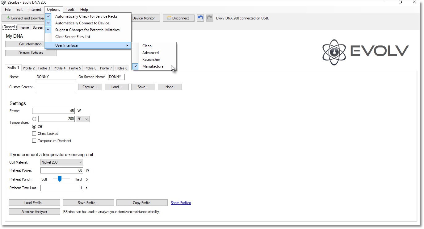

Then open the escribe software, choose Option -> User Interface -> Manufacturer.
Ussually if we don't choose the User Interface, the default is Clean.

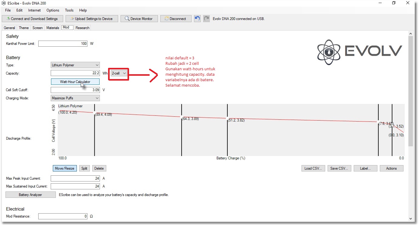

Then choose Mod tab.
You will see Battery option. Beside the Capacity text box, there is a drag option bar, the default is 3-cell. If you are using Finder 133 with 2-cells battery, as i am, then you have to change the value become 2-cells.
Then click the Watt-hours calculator to get the capacity value. The variable is written in your battery. Fill the Capacity text box after you calculated it.
Then upload the settings. Voila....you did it. hehe.

donysaurus, Thank you for posting #7 on no battery charge and mod stopped working. I followed what you said to do, and now it is better than before!!!! It is working again, and this is my 1st time here, and I thought I cooked it (Evolv VT 133).
