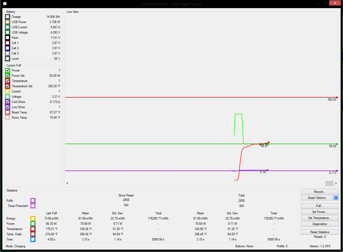

uberbdon Posted January 21, 2017 Author Report Posted January 21, 2017 I'm trying to use temp control on dual SS clapton coils and for some reason I never hit the temp ceiling I have it set at. Maybe I'm just reading this wrong. If you need any further info just ask!
VapingBad Posted January 21, 2017 Report Posted January 21, 2017 Have you locked the resistance, because I see the live res line dips below the cold res.
uberbdon Posted January 21, 2017 Author Report Posted January 21, 2017 VapingBad said:Have you locked the resistance, because I see the live res line dips below the cold res.This looks strange...
retird Posted January 21, 2017 Report Posted January 21, 2017 Are you using contact or spaces coils? any loose connections at the posts or any hot spots?
uberbdon Posted January 21, 2017 Author Report Posted January 21, 2017 retird said:Are you using contact or spaces coils? any loose connections at the posts or any hot spots?Contact coils. No hot spots. Fires great on wattage mode. It appears it may have fixed itself. I'm lost dit: I may take it apart and try spacing the coils a bit
