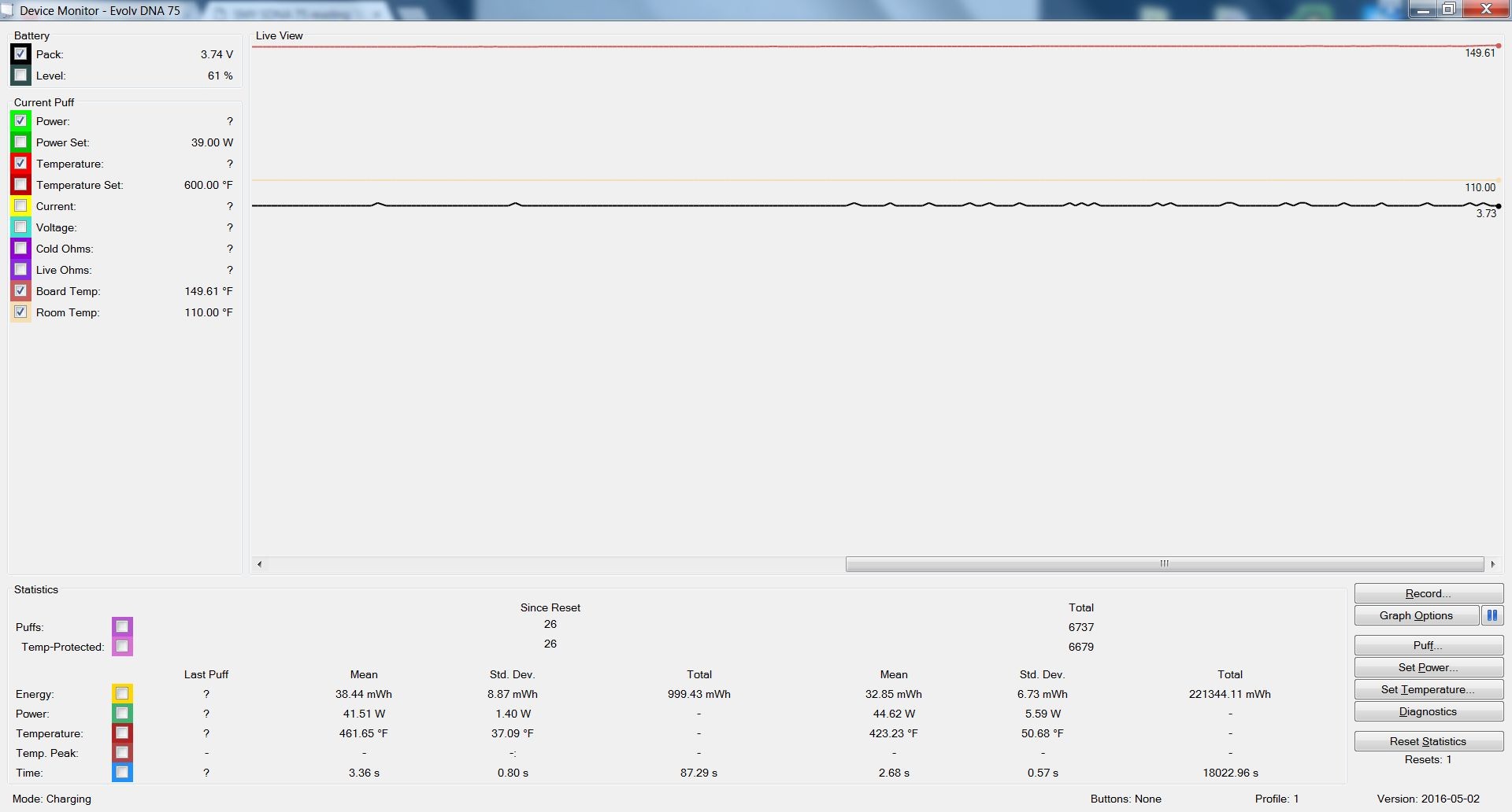

kjr Posted February 16, 2017 Author Report Posted February 16, 2017 Thanks!Since my last reload of the firmware, I have not used the mod (2 days).Screenshot of DM shows shows really high temps.
Spector NS5 RD Posted February 17, 2017 Report Posted February 17, 2017 unfortunately kjr, it seems one of the on-board temp sensors is out of calibration, possibly damaged. was the mod dropped or any type of liquid accidentally spilled on/into the device? only things i can suggest is trying exactly what you tried before, re-flashing the firmware and throw in a couple hard re-boots. other than those, there is no repair you can do yourself. if the device is still under warranty from the vendor you purchased it from, i would contact them first. if it's out of warranty from the vendor, there is always a one year warranty by Evolv, from the date of purchase, on the board itself (link is in my signature). just know, you may be asked to send in the board only. however, i have heard of Evolv taking in entire devices. if you have to go the Evolv route, and they only want the board sent in, i would check the board for juice and give it thorough cleaning with some iso alc giving it one more shot at life.
