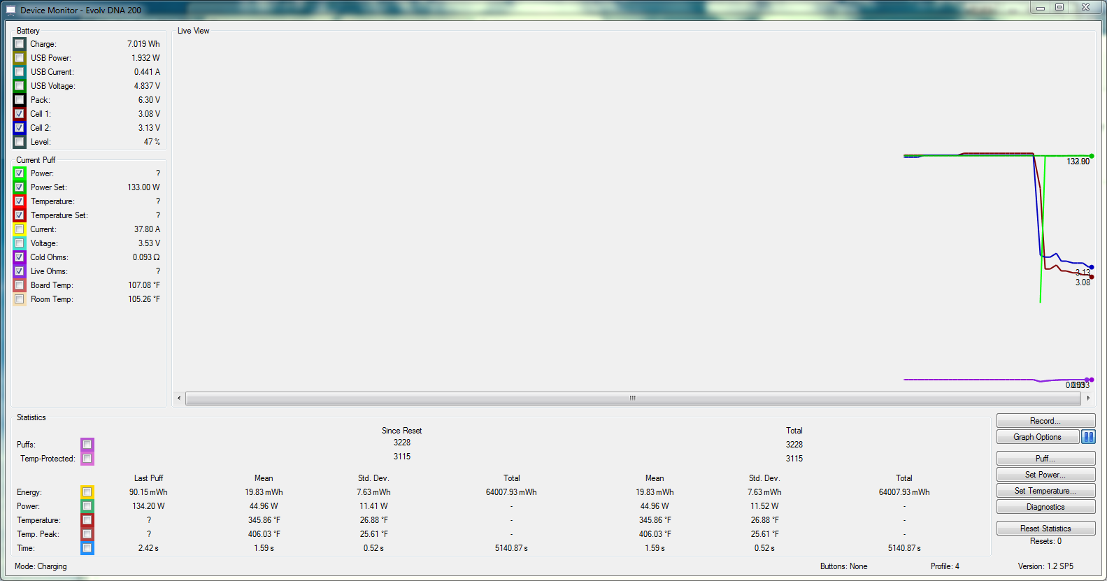

dwcraig1 Posted February 20, 2017 Report Share Posted February 20, 2017 Here's an example of where I would start looking.In EScribe/Device Monitor tick the two cells and not what the voltage sag is. My batteries in this example were 3.68 unloaded and when fired drop to near the soft cell cutoff. Had they dropped below the set soft cell cut off the power would have dropped.Here's my example:So take a look at yours and let us know, post it if possible. Link to comment Share on other sites More sharing options...

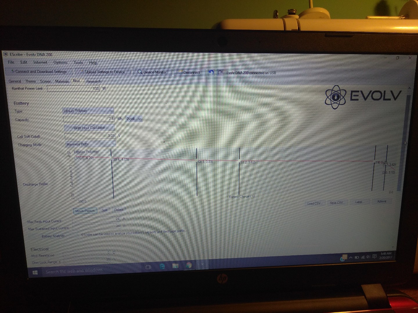

CodyB1369 Posted February 20, 2017 Author Report Share Posted February 20, 2017 These are my settings. Should the capacity be changed? I've tried everything I know but can't get it to work. Link to comment Share on other sites More sharing options...

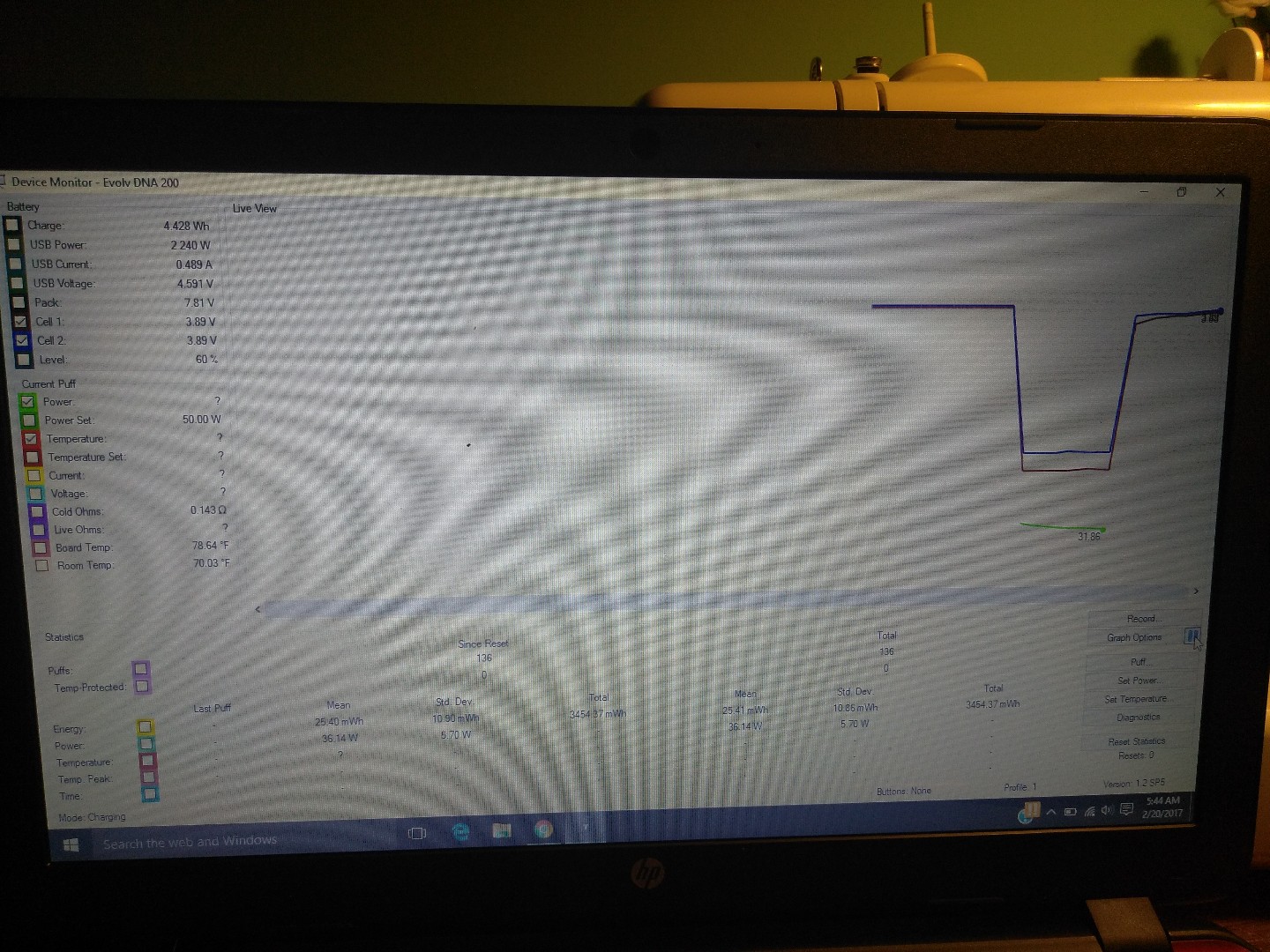

dwcraig1 Posted February 20, 2017 Report Share Posted February 20, 2017 The only setting on that page that can have anything to do with your problem is set correctly to 133 watts.We need to see it firing in Device Monitor with the two cell ticked. Use the stop button in the right lower corner once you get it then move your mouse over the sagged voltage points to show the voltages (if not showing) Link to comment Share on other sites More sharing options...

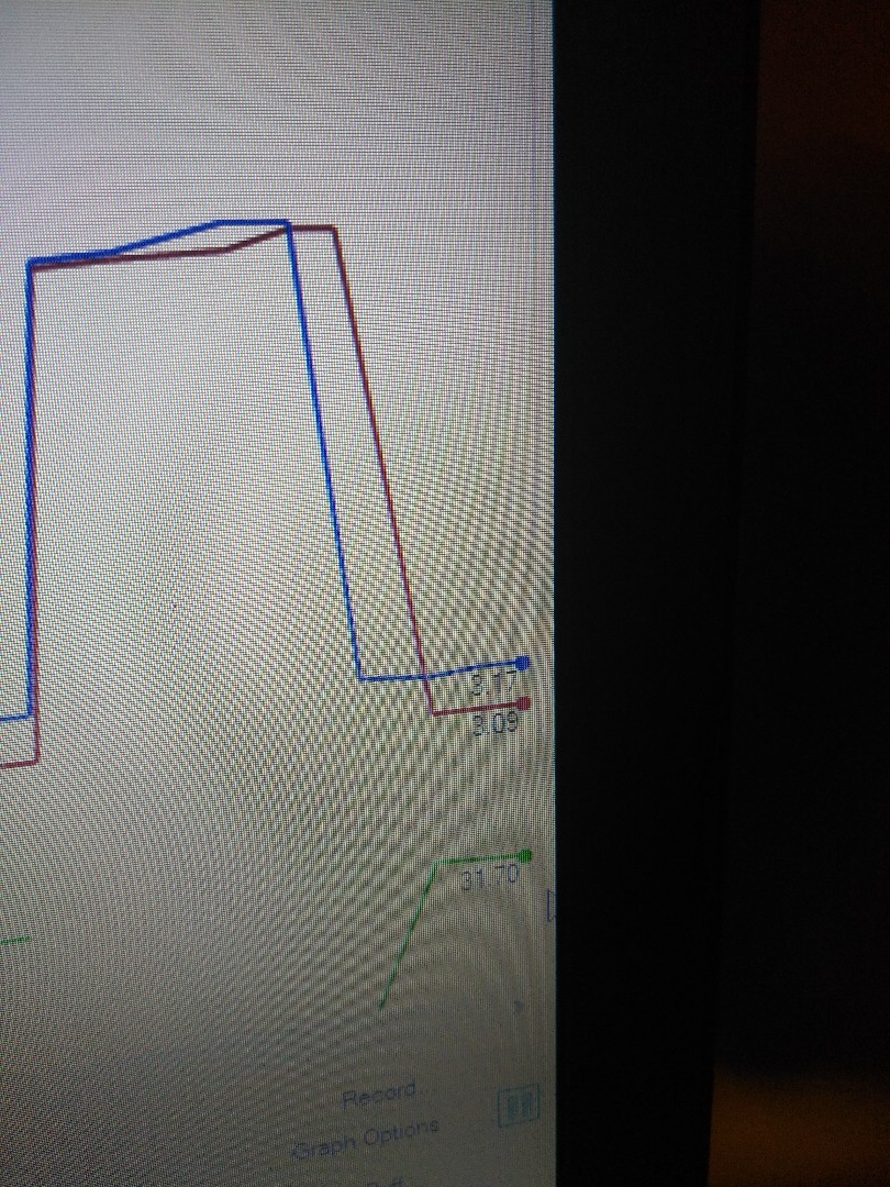

CodyB1369 Posted February 20, 2017 Author Report Share Posted February 20, 2017 This is while fire button held. Cell 1 reading 3.10 cell 2 reading 3.17. Link to comment Share on other sites More sharing options...
CodyB1369 Posted February 20, 2017 Author Report Share Posted February 20, 2017 The odd part is it shows firing at 31.70w but I have it set to 50w. Ohms are .144 Link to comment Share on other sites More sharing options...
giz_60 Posted February 20, 2017 Report Share Posted February 20, 2017 Looks like one battery is hitting your 'cell soft cutoff' setting. Are you seeing a 'check battery' message on your screen? I too run 2 LG HG2's & have my cell soft cutoff set at 2.8 Link to comment Share on other sites More sharing options...
CodyB1369 Posted February 20, 2017 Author Report Share Posted February 20, 2017 giz_60 said:Looks like one battery is hitting your 'cell soft cutoff' setting. Are you seeing a 'check battery' message on your screen? I too run 2 LG HG2's & have my cell soft cutoff set at 2.8 No check battery but the battery bar did flash once. And my cut off is set to 3.09. Link to comment Share on other sites More sharing options...

giz_60 Posted February 20, 2017 Report Share Posted February 20, 2017 Oh yeah...they changed the message to a flashing battery symbol...lower your cell soft cutoff to 2.8 or 2.9 & give it a try... Link to comment Share on other sites More sharing options...

CodyB1369 Posted February 20, 2017 Author Report Share Posted February 20, 2017 giz_60 said:Oh yeah...they changed the message to a flashing battery symbol...lower your cell soft cutoff to 2.8 or 2.9 & give it a try... I tried that and it said check battery as soon as I hit the button. Lowest I could take it was 3.00v Link to comment Share on other sites More sharing options...

dwcraig1 Posted February 20, 2017 Report Share Posted February 20, 2017 OK, for sure power isn't getting from the cells to the board. Could be poor cells (probably not), bad solder joint on B+ or B- or at battery sled(lo or at battery sled. But most likely battery contacts to cell, make sure they have as square contact as possible and tight against cell. Link to comment Share on other sites More sharing options...
