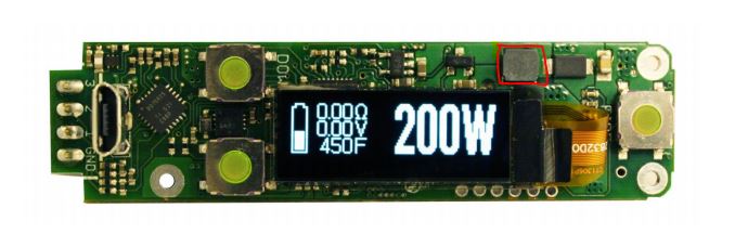

lawtran Posted February 21, 2017 Author Report Posted February 21, 2017 Firstly, i would like to say hello to anyone!I'm a newbie of building custom box. Today, i try to move a board (DNA 200) from my old mod box to new one. Sadly, when i assembled, a component was broken. (red square on my picture) So my question is, what is a component and what function of this? So will my board working properly without this component ? If won't how can i fix it? Anyway thank for you help. Sorry about my bad english
VapingBad Posted February 21, 2017 Report Posted February 21, 2017 It is an inductor that I believe is for the voltage conversion for the charging circuit, you will need to exchange the board, open a ticket with Evolv they will probably replace the board for free, you pay the postage to send it to them.
black lace Posted February 22, 2017 Report Posted February 22, 2017 I have also broken one of thoes in the past, and also while removing the board, ,,they have a little copper winding inside and the black outer shell is very brittle, it will crush and chip very easily, evolv swapped mine for me,,,
