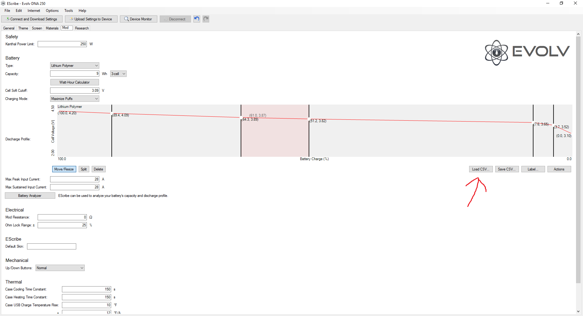

cloudymods Posted March 7, 2017 Author Report Posted March 7, 2017 ok so im trying to set up my finder 250. i would like to ask if anyone can give me the settings i need for 3 hg2 batteries? i cant download anything yet im a new member and for some reason it says check email. however i have had the approved email. also profiles i would love to know how to do custom etc
dwcraig1 Posted March 7, 2017 Report Posted March 7, 2017 29 watt hours will put you pretty close.2.9 volt cell soft cutoff 1
giz_60 Posted March 7, 2017 Report Posted March 7, 2017 It can take a few hours until you can download files...here is the .csv file for 3 LG HG2's... LG_HG2 (3)_18650_3000 mah_28.3 Wh.csv ...and there is a really good interactive Escribe training course here...https://downloads.evolvapor.com/escribe/guide/story.html
cloudymods Posted March 7, 2017 Author Report Posted March 7, 2017 i dont understand the file i has all different numbers ahaha i feel dumb
Wayneo Posted March 7, 2017 Report Posted March 7, 2017 Under "File" menu, go and save a copy of your entire settings in case you ever need to restore back to pretty close your 'standard'.
giz_60 Posted March 7, 2017 Report Posted March 7, 2017 cloudymods said:i dont understand the file i has all different numbers ahaha i feel dumbYou need to load that .csv file for your battery settings...go to the 'Mod' tab, Load .csv & select the file you downloaded...
