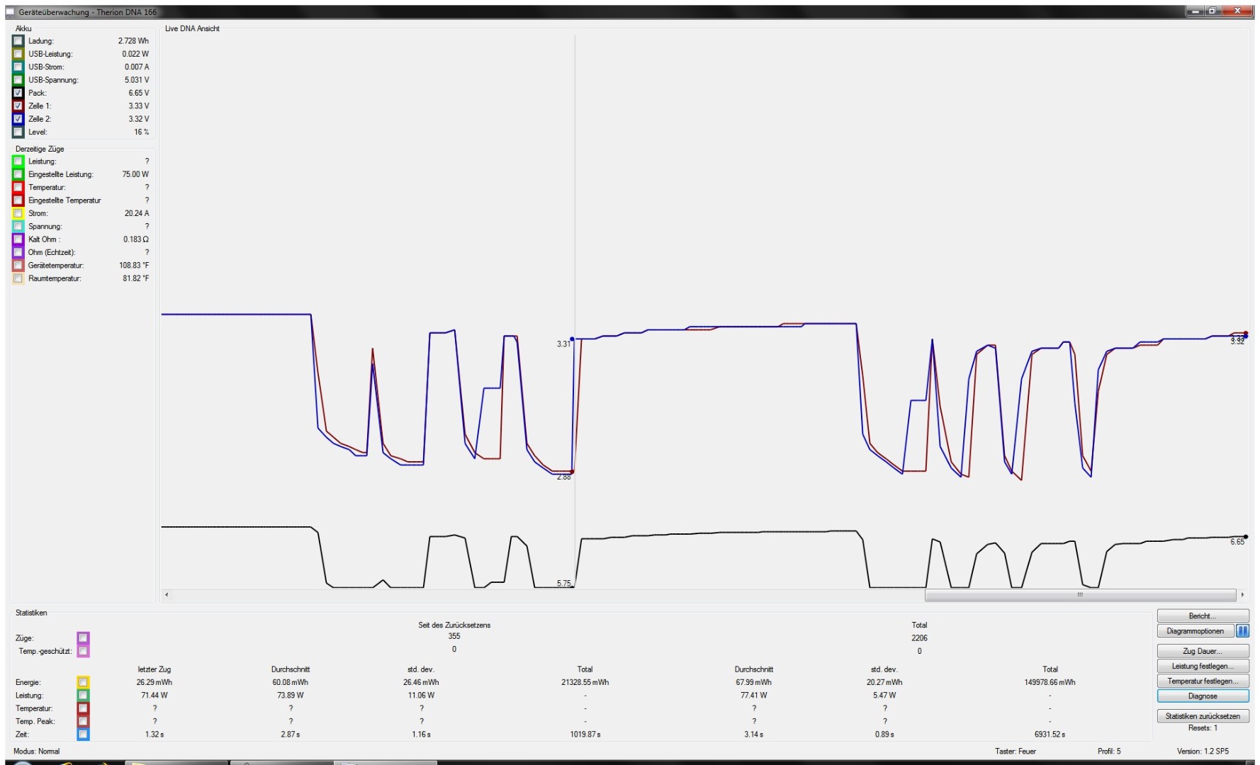

Smii Posted March 1, 2017 Author Report Posted March 1, 2017 The Pack Voltage is 8.4 Volt if the cells are fully charged. I "played" in the morning with the Device Monitor and noticed that. If the cells are empty i charge them in a external charger. Both empty cells got 3.33 volts then. That looks right for me. At the moment my batteries are all charged. If the drop to 15% and the message is shown i make a screenshot from the Device Monitor.Edit:So i capture a screenshot from the Device Monitor while i get this message. My Pack Voltage at 16% is 6.65 Volts. The Cells drop from 3.33 Volts to 2.86 Volts and then i get the message Check Battery. If the Cells are fully charged, the time i can vape is not shorter than before. I got 2 sets of the Sony VTC5, they are 4 months old and work the last time in a Smok Alien. In this Mod i got no Problems with the Cells, but maybe they are too old now or damaged.I dont know whether the Volt drop is normal, maybe somebody see in the screenshot a answer for my problem....and sorry for my bad english
Wayneo Posted March 3, 2017 Report Posted March 3, 2017 @Smil Your batteries show they're hitting your soft cell cutoff under load. Follow @giz_60 suggestion. When you say this "... My other "Non-DNA" Boxes drain the batteries to 5% - 0%" what is the voltage remaining in them? "I dont know whether the Volt drop is normal" This is different for every mod depending on its ability to pass current from battery to atty. Quality of battery, wires, connections etc. all play a role.If your concern is really that "15% value" run your own battery analyzer
