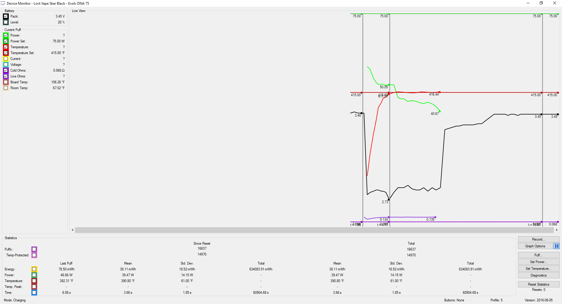

giz_60 said:
The discharge profiles are only going to aid in the battery indicator to be more accurate...I use all the batteries you listed with a dual coil build, clapton wire at .07?, with no major issues... even on my Skar 75 with a single cell...
What is your sag under load?  Are you using TC or no?
Posted
Asmodeus said:
Yeah, I know.  My struggle with this DNA build is multi-faceted.
xD
I kinda want my battery meter to be remotely useful if it does work better with these batteries though!
TC, .068?, 3.45v in battery at approx 20%
Edit:   cell was an LG HG2
Edit Edit:  Why not just run the battery analyzer, so that you have an accurate data set for YOUR device?
