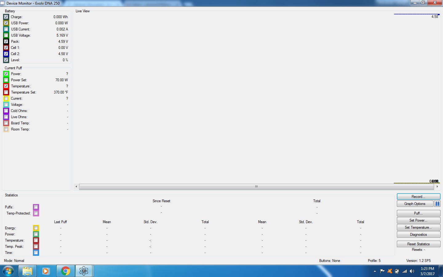

Reksie Posted March 7, 2017 Author Report Share Posted March 7, 2017 My finder 167 DNA 250 shows 0% battery charge and wont show normal screen when USB is unplugged also is it normal (from attachment) that on device monitor, the cell 1 shows 0v during charging? Please help!*EDITThink Vape Finder 167DNA 25018650 * 2 pieces (red AWT 3000MAH) 1 Link to comment Share on other sites More sharing options...

sirlesmp Posted March 15, 2017 Report Share Posted March 15, 2017 I have a similar issue as the OP.Took my Thinkvape finder 167 off usb charge to find it will not fire, gives me a blank screen and when using the fire button the error check Battery.I have tested this with 4 differrent sets of 18650 cells, rechecked Escribe to make sure the mod is set to use 2 cells.As the OP i too see using device monitor that cell 1 shows as 0v and cell 2 shows as 4.9-5.0v.Battery wise ive tried 2 sets of sony VTC 5a( brand new ), 1 set LG HE4 and 1 set LG HG2 all fully charged.Im unsure about the OP but i only ordered and recived my Mod within the last 4 weeks and the DNA 250 board according to the serial no was only produed in January this info may be irrelevent or may point to a Faulty batch, either that or myself and the OP are just unlucky. Link to comment Share on other sites More sharing options...

Spector NS5 RD Posted March 22, 2017 Report Share Posted March 22, 2017 Lost Down Under said:Same as above. Finder 167 and when on usb battery indicator shows empty. Take it off the usb and it won't start up. Hold the fire button down and it cycles through start up, but keeps flashing check batteries. Have had 4 different sets of LG 3000 in it with no change. Tried both soft and hard re set through evolve program with no change.are you able to post a screenshot of Device Monitor with cells 1-2 and pack voltage checked? Link to comment Share on other sites More sharing options...

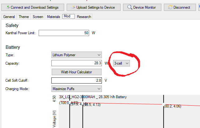

Lost Down Under Posted March 23, 2017 Report Share Posted March 23, 2017 Picture of the mod attached to computer.Screen shot. Link to comment Share on other sites More sharing options...
giz_60 Posted March 23, 2017 Report Share Posted March 23, 2017 Device monitor is showing 3 cells & that is a 2 cell device. Try going into the 'Mod' tab in Escribe & set the device to 2 cell in the battery settings...then upload to device....see if that gets it working Link to comment Share on other sites More sharing options...
Lost Down Under Posted March 23, 2017 Report Share Posted March 23, 2017 You are worth your weight in gold.Thank you so much. Changed the battery selection to 2 cells and all's well. Link to comment Share on other sites More sharing options...
