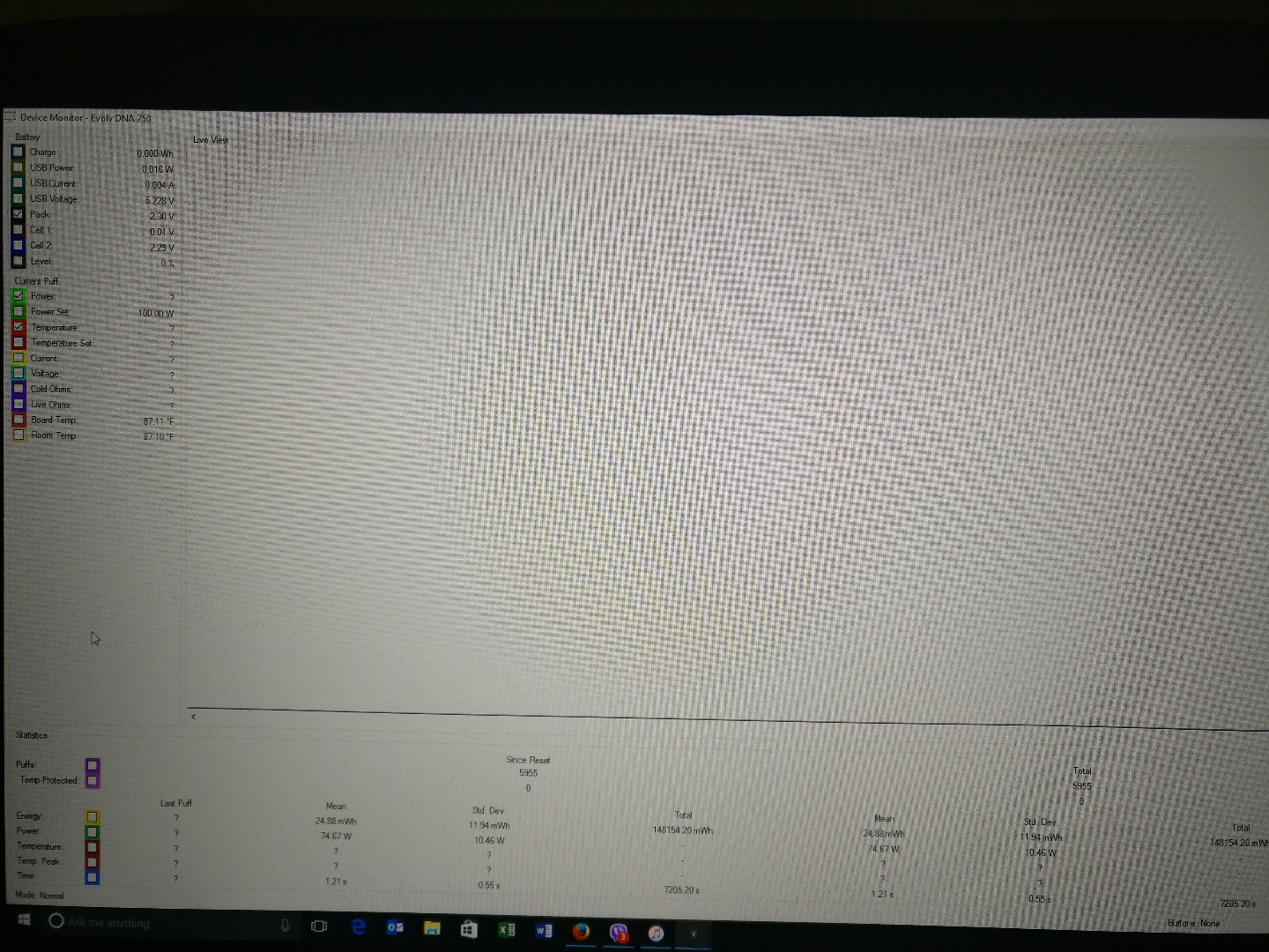

Aikko Posted March 21, 2017 Author Report Posted March 21, 2017 Sorry for the bad quality cause my laptop would not take a screenshot for some reason.This is without the batteries.

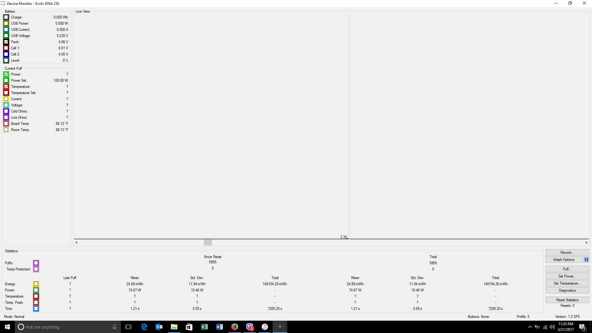

giz_60 Posted March 21, 2017 Report Posted March 21, 2017 need to see it with the batteries in...if you press 'PrtSc' on the keyboard then open Paint & paste...then 'save as'Edit: or you can use the 'Snipping Tool' in windows
giz_60 Posted March 21, 2017 Report Posted March 21, 2017 For some reason, the board is not seeing the #1 cell...could be a board issue, connection between the batteries & board...being you bought it from a local vendor, and it fairly new, your best bet would be to take it to them because it is still in warranty...it doesn't appear to be a software issue because I have the same device running the same software version. Here is the factory .ecig file it you want to give it a try... Therion_166.ecig Edit: Much better screenshot...
