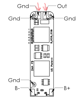

So, when atomizer is attached it says Check Atomizer? It is normal for a Check Atomizer message with no atomizer attached.,.,...,  Since you have it open check the screws that hold the board in for tightness and make sure you have a good ground at the 510 connector.  Then see if it will connect to EScribe...

If you have a meter & seems you will have it open, if you screw an atty onto the 510 connector, check for continuity between the 2 wires where they connect to the board...if no continuity is present, then the issue is on the 510 connector side....if continuity is present, then the issue is board side...
