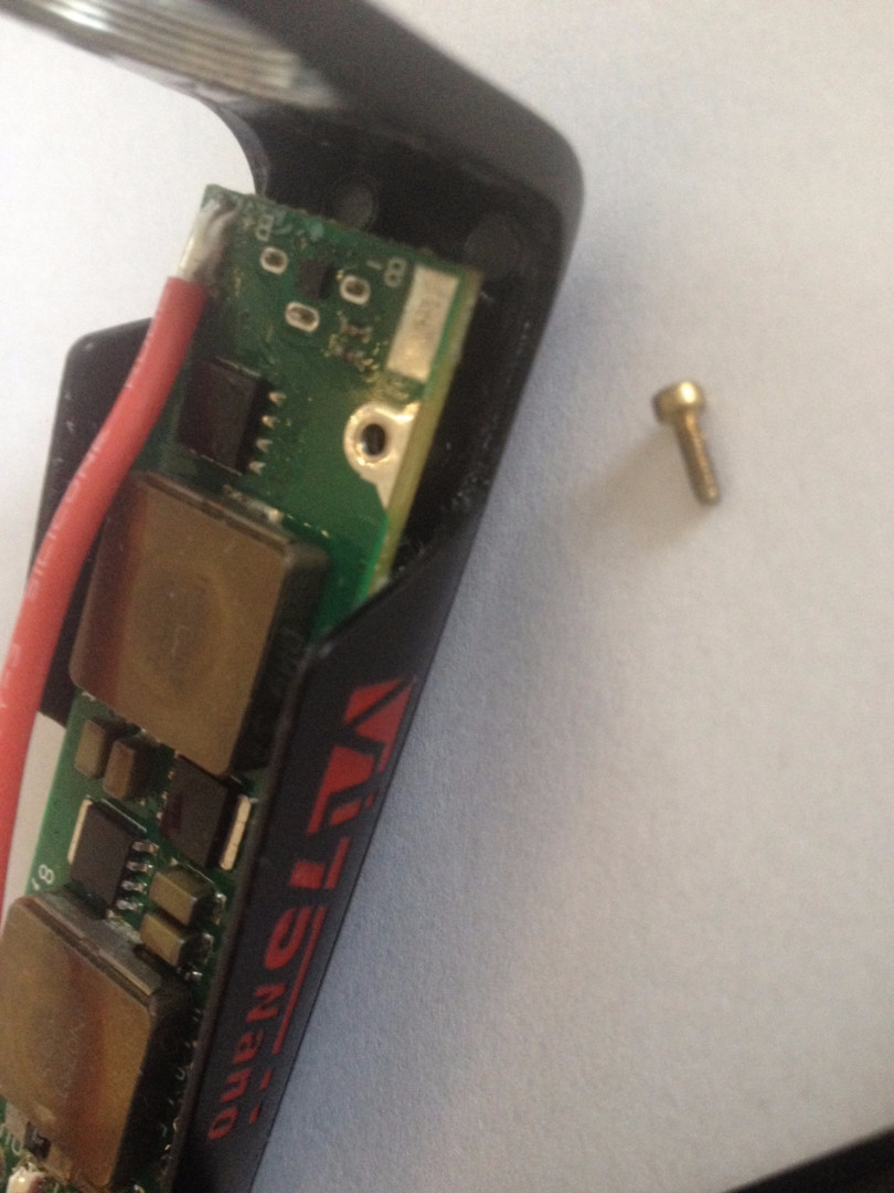

ryno250 Posted March 27, 2017 Author Report Posted March 27, 2017 Ok got the set today ,pulled it apart and tightened al the screws the were a lil loose, and so were the body screws, and the screws that hold down the positive contact were also loose,It might be me but it seems to be hitting much harder now,I was set a 26watts but seem to be getting about the same at 20 watts ,is that possible..
giz_60 Posted March 27, 2017 Report Posted March 27, 2017 You betcha...better connectivity, better performance....
dwcraig1 Posted March 27, 2017 Report Posted March 27, 2017 Device Monitor in Escribe will show you the answer.....tell us too. 1
ryno250 Posted March 27, 2017 Author Report Posted March 27, 2017 What specifically should i be looking for in device monitor...???
giz_60 Posted March 27, 2017 Report Posted March 27, 2017 Improvements over the last time you ran Device Monitor...less battery sag, etc...
ryno250 Posted March 28, 2017 Author Report Posted March 28, 2017 ok cool,I was thinking battery sag,I will have a look today when i get a chance
ryno250 Posted March 28, 2017 Author Report Posted March 28, 2017 yes went into device monitor,voltage isn't dropping as far as it was at a full bater it dropping to 3.89 insead of like 3.7 so bit beter
