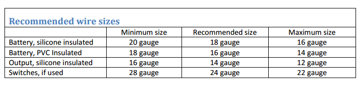

bluntmoment Posted March 27, 2017 Author Report Posted March 27, 2017 gonna be building my own box mod using the DNA 250 chip. Wondering what is the recommended solder to use for these boards? also what are the recommended gauges for the silicone wire?
