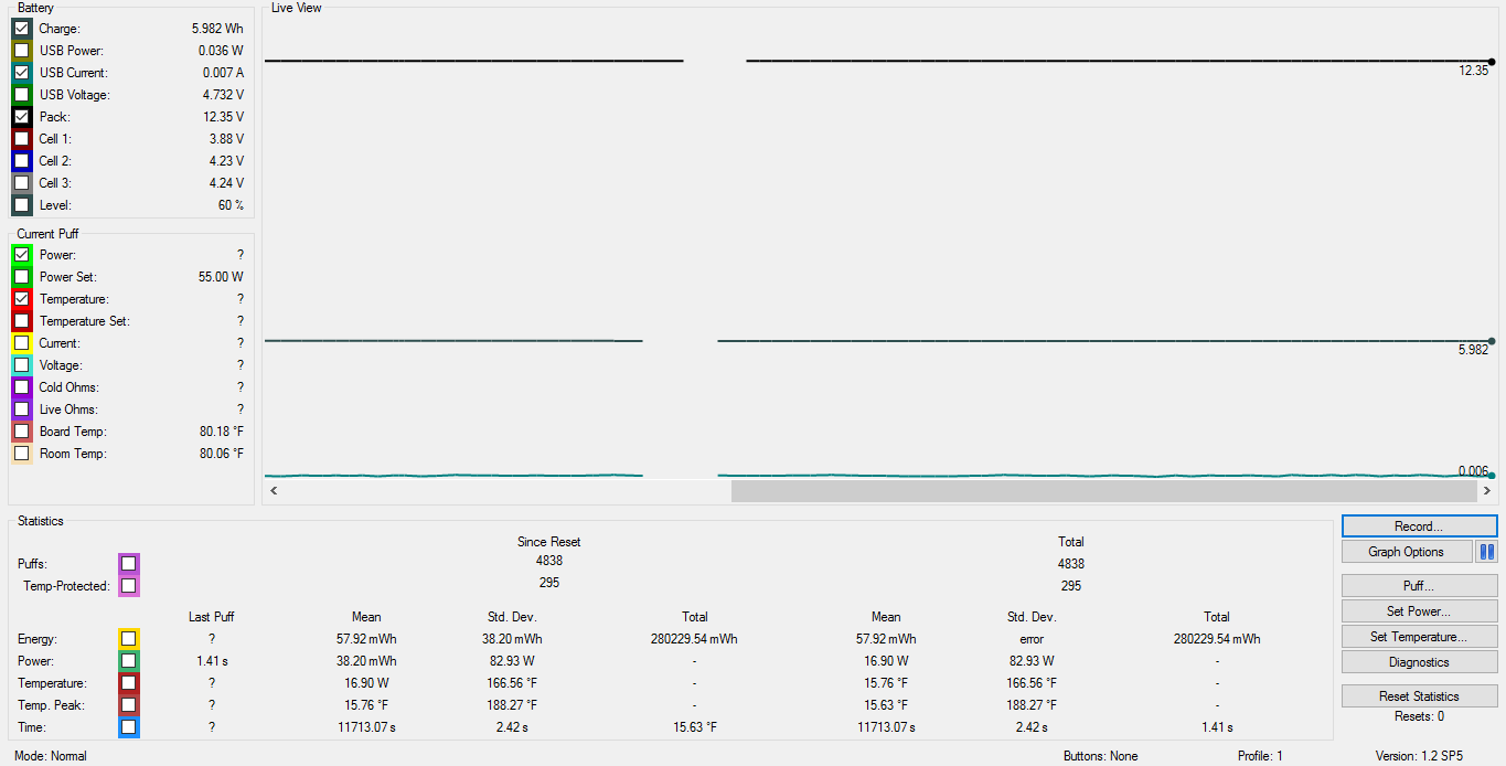

Chelo Posted April 7, 2017 Author Report Posted April 7, 2017 hi all,i have lavabox dna 200 with lipo 900 3 cell and when i put on usb, screen ligh reacts but not charging. ]when monitoring with escribe usb a is 0.008-0.009. laso it takes to long to charge battery. i tried to restore to manufacturers settings, also tried usb recovery but non of them helped.
giz_60 Posted April 7, 2017 Report Posted April 7, 2017 Cell 1 is out of balance with 2 and 3...need to run usb recovery charge to try to get it back in balance...may need to run recovery charge several times...

Chelo Posted April 8, 2017 Author Report Posted April 8, 2017 i tried as u said. error massage imbalanaced battery came out, but v of cels were above 3, i charged but 1 cell stayed 3.84, while 2-3 were 4.2. and battery charge percentage was only 35 and stoped charging.i tried to empty battery and here is what i got.
Spector NS5 RD Posted April 8, 2017 Report Posted April 8, 2017 ya, you most likely could use a new lipo. but more importantly, a new board. you said it will NOT wake up after it goes to sleep? you need to insert a USB cable to wake it? that's an early issue that affected some early boards. (2015 boards). now since fixed.

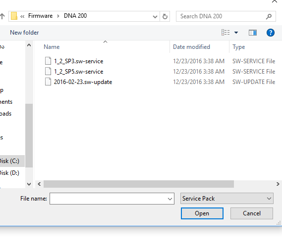

Chelo Posted April 9, 2017 Author Report Posted April 9, 2017 thank u.and few more questions.1. how can i update firmware for board and where i can found latest one?2. how can i update software for escribe and where i can found latest one?3. one of my mods (that one that is not waking up without usb) also drains battery imbalanced and makes them not working.. what may be issue?
Spector NS5 RD Posted April 9, 2017 Report Posted April 9, 2017 1. and 2. - latest versions of EScribe and firmware can be found through the link in my signature at bottom of this post.3. - bad board or lipo. hard to diagnose over the internet. swap lipos between mods to find out.
