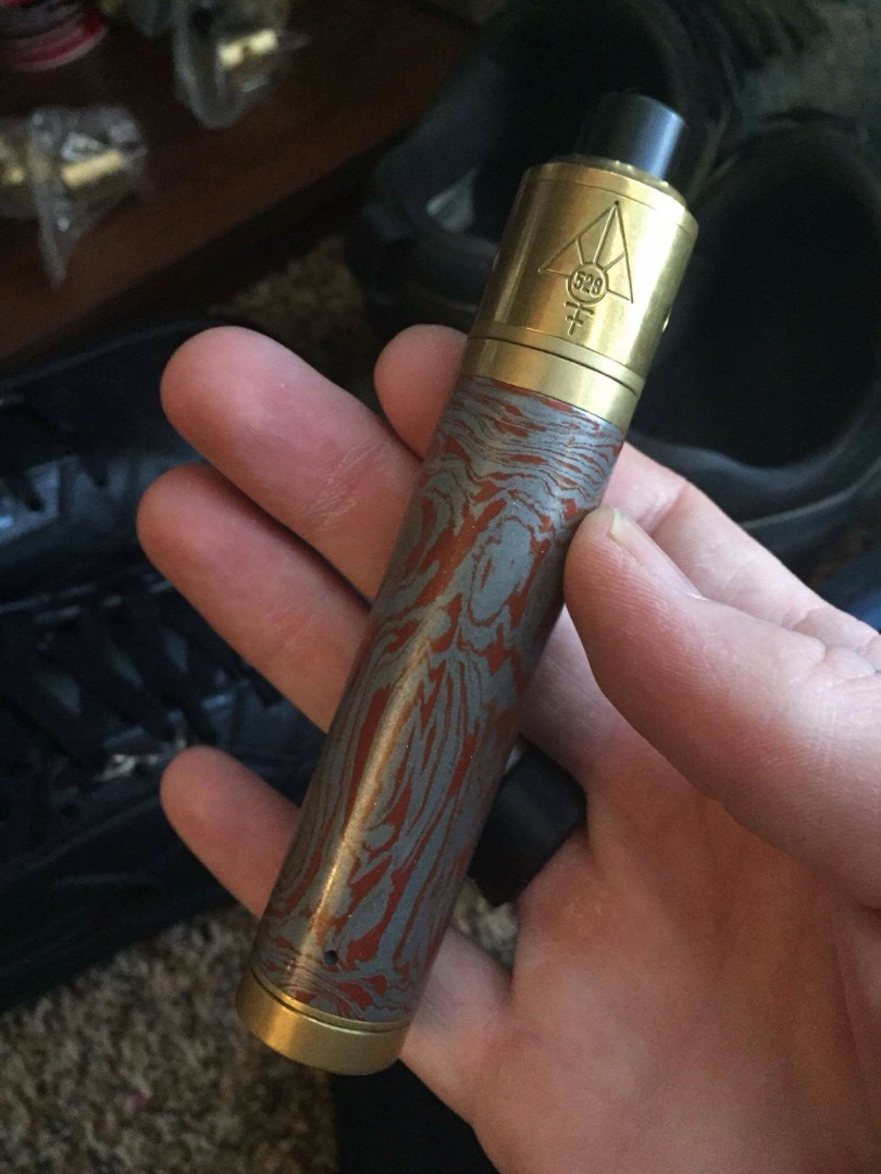

chilly814 Posted April 10, 2017 Author Report Share Posted April 10, 2017 Just got a Therion 166 with dna 250. Put a goon rda on top and im just getting check atomizer. My guess is the 510 connections is messed up. My question is what do I look for to see if it is and how do I go about fixing it the cheapest way.. Link to comment Share on other sites More sharing options...

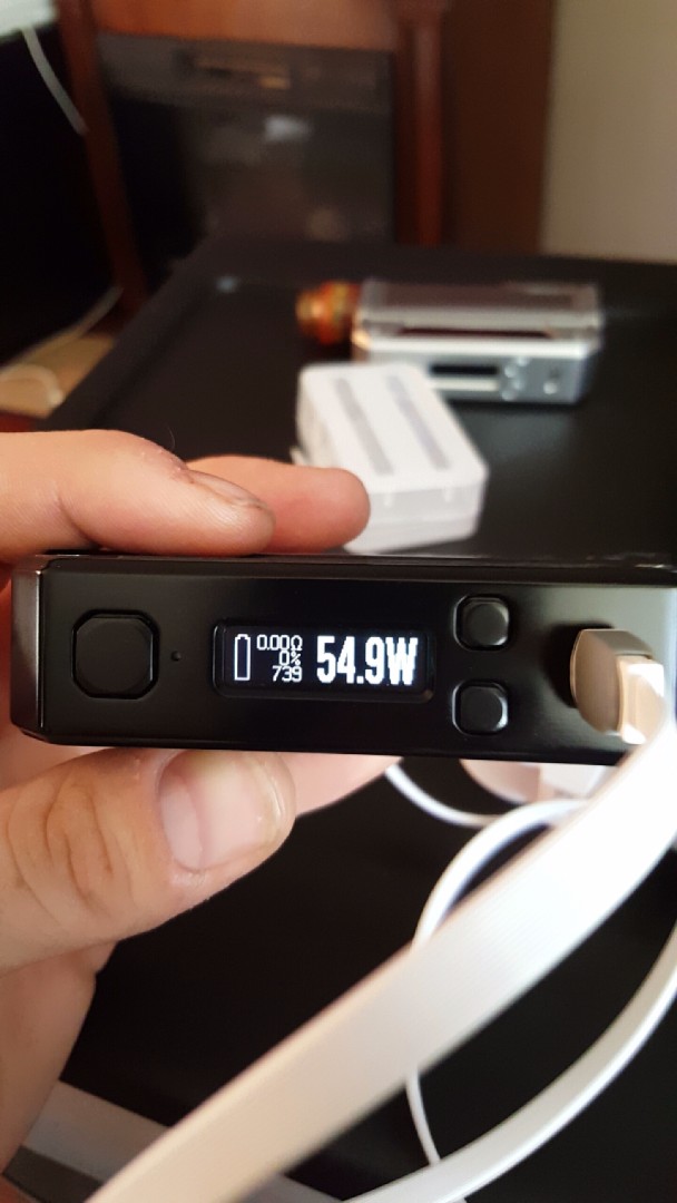

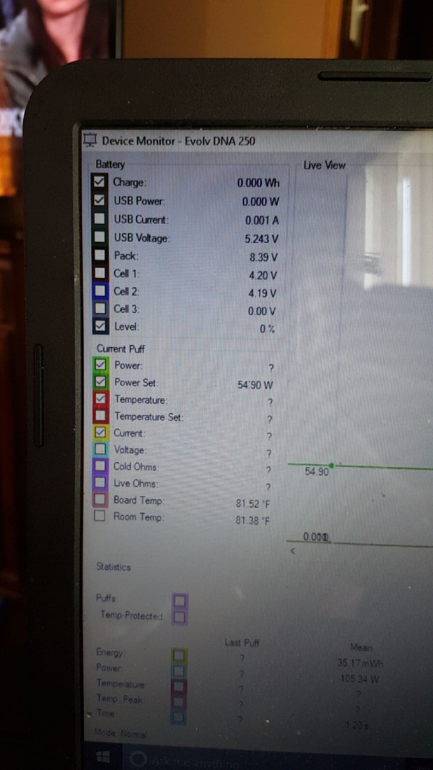

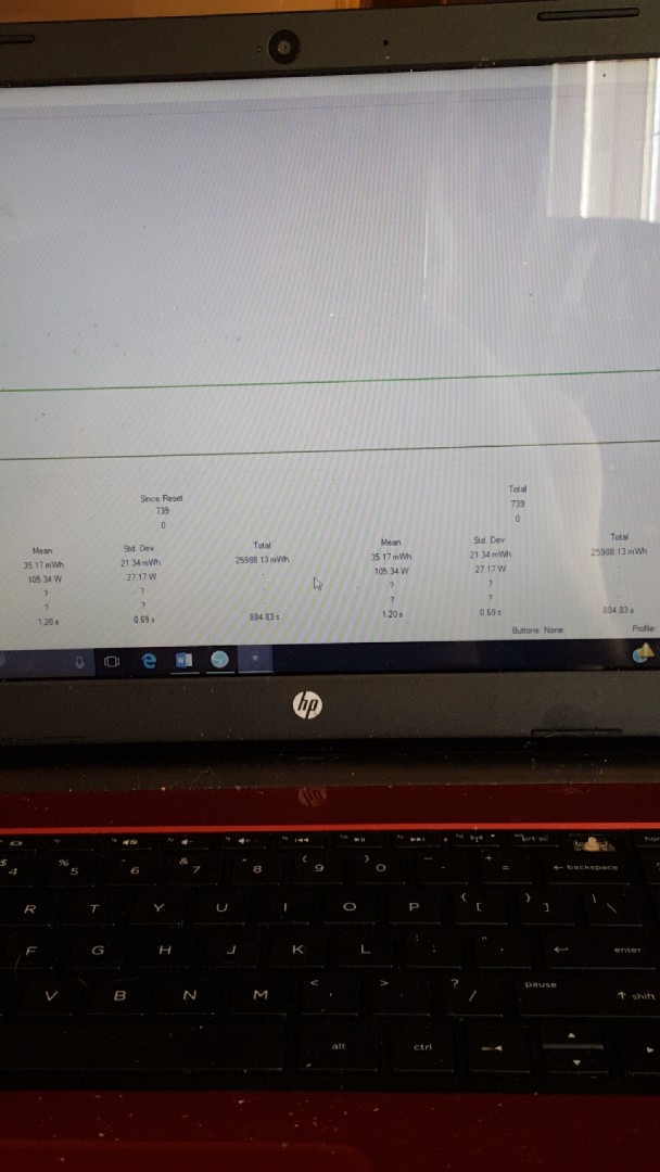

chilly814 Posted April 11, 2017 Author Report Share Posted April 11, 2017 I'm not quite sure what you're asking for sorry. But here are some pics of what I thought you was asking for. Link to comment Share on other sites More sharing options...
giz_60 Posted April 11, 2017 Report Share Posted April 11, 2017 If you are referring to the battery indicator on the screen not showing the correct level, it is a known glitch...all my 250 devices will do that if the USB is attached when changing out batteries. I have found that unplugging the USB & either remove & replace the batteries, or let the device set for about 15 mins. it will refresh the indicator & show the proper level again...in the Device Monitor shot, you can see the voltage is showing in both cells, but the % is 0 because of the the same issue, but will reflect the same % seen on the device once it has refreshed itself... Link to comment Share on other sites More sharing options...
chilly814 Posted April 11, 2017 Author Report Share Posted April 11, 2017 But my issue is when it's not plugged in I will power it on it will show my logo then it goes off. When it's plugged in I get what I showed you in the pics and even on device monitor where you can hit the botton yo make your mod fire it says battery to are to low Link to comment Share on other sites More sharing options...

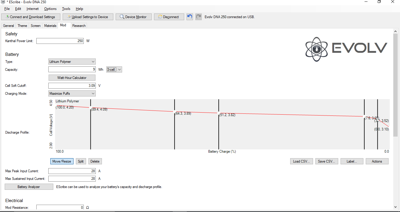

giz_60 Posted April 12, 2017 Report Share Posted April 12, 2017 Ok, near the top of the screen, go to 'Option>User Interface' & then select 'Manufacturer'...that will give you the 'Mod' tab...on the Mod tab, make sure that it is set for 2 cell...then upload to device... Here is the factory Lost Vape .ecig file for the Therion 166 in case you ever need to restore it to out of box state... Lost_Vape_Therion_166.ecig Edit: When you hit the 'Restore Defaults' in Escribe, you reset the mod to the Evolv defaults, not Lost Vape's Link to comment Share on other sites More sharing options...

chilly814 Posted April 12, 2017 Author Report Share Posted April 12, 2017 ok I found it ans everything on mine looked exactly like your picture you sent me except mine was set on 3 cell Link to comment Share on other sites More sharing options...
giz_60 Posted April 12, 2017 Report Share Posted April 12, 2017 The device is looking for a 3rd cell that isn't there, changing it to 2 cell & uploading settings to device should have you going...here is the .csv file for the 25r batteries... Samsung_25R (2)_18650_2500 mah_16.92Wh.csv ....download this file & save to your computer...on the Mod tab, click on 'Load .CSV' & then select this file...in the 'Wh' field, enter 16.92...in 'Cell Soft Cutoff', enter 2.75...the LV default 'Mod Resistance' is .004 Link to comment Share on other sites More sharing options...
