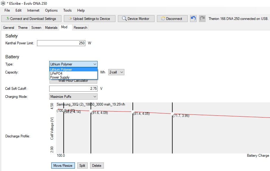

ttatlanta Posted April 13, 2017 Author Report Posted April 13, 2017 Just received my Therion 166 today (and enjoying the heck out of it!) Connected to Escribe, flipped through the tabs and found out that the default chemistry is LiPo. Known issue, so let's select the 18650 from the pulldown menu. Wait, what?!â¦
giz_60 Posted April 13, 2017 Report Posted April 13, 2017 Lithium Polymer setting for the Li-ion 18650 cells... "Lithium-polymer batteriesâ are actually âLithium-ion polymerâ batteries
ttatlanta Posted April 13, 2017 Author Report Posted April 13, 2017 giz_60 said:Lithium Polymer setting for the Li-ion 18650 cells... "Lithium-polymer batteriesâ are actually âLithium-ion polymerâ batteriesSemantically you are correct, but⦠While both are lithium based, these are very different batteries in the real world. AFAIK there's no LiPo on the market in 18650 form factor. Most importantly in this case, LiPo and LiIon have a different charging dynamics.Edit: maybe I've been mislead by this post, as it mentions "18650 LiIon" setting, but I'm reading the official Escribe manual and there's no mention of this option.

giz_60 Posted April 13, 2017 Report Posted April 13, 2017 ttatlanta said:A Reddit post with 3 upvotes is a very scientific source of information indeed. </sarcGuess you missed that the quote was from Wikipedia as well...At the end of the day, for the DNA 2xx devices, Lithium Polymer is the correct setting, in Escribe, for the Li-ion 18650 cells. You can always make a request to Evolv about changes/features in future updates to Escribe, but for now, it's what we got...
retird Posted April 13, 2017 Report Posted April 13, 2017 ttatlanta said:You stated the obvious, then basically rephrased my question⦠that doesn't count as an answer. Yes, I think we've established by now that 18650 LiIon have disappeared from the menu options with DNA200&250, but why?! Why single 18650 had a dedicated option, yet 2 or more of them are treated as LiPo? Then again, if you insist that LiIon and LiPo should be treated the same, why not call the menu option "LiPo/LiIon"? Doesn't make sense.............We've not established that 18650 LiIon have disappeared from the menu options with DNA200&250.Why?The 18650 LiIon option did not disappear from the 200's and 250's as it was never there to start with. If the point you want to make is that you would like a LiIon option be added to the 200 and 250 boards via EScribe then you might drop a suggestion and state your reasoning using this link:https://helpdesk.evolvapor.com/index.php?a=add&category=5If you have a concern as to whether the DNA 200 and 250 safely charge batteries you could also add that to the suggestion form. Evolv folks are pretty good at replying back from their help desk.As a side note: Updating firmware and software prior to August 8, 2016 wasn't much of a thing but the FDA Deeming Regulations are now in effect and the process gets complicated and expensive. At least that is what I have read....Overview of Deeming Regulations: http://sfata.org/wp-content/uploads/2016/05/SFATADeemingReuglationsAnalysis.pdf

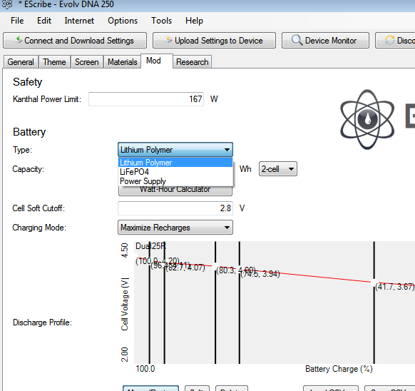

Spector NS5 RD Posted April 13, 2017 Report Posted April 13, 2017 to add, the reason for the battery chemistry drop down menu is so the board knows at what voltage to stop charging at and the maximum hard cutoff point. there would be no real immediate reason to add Li-ion. both Li-ion and Lipo chemistry batts/cells require a constant current / constant voltage charging procedure, both usually have an end charge voltage of around 4.20v (4.20v is not required but is considered the fully charged voltage). the difference between the two, in terms of "different charging methods" would be negligible. you're splitting hairs trying to differentiate between the two chemistries when it comes to how the DNA 200/250 charges. there would be no real benefit or drawback, that you would notice, to your cells if there was a specific Li-ion option. you CAN choose between 4.10v and 4.20v for a cutoff voltage. i've been running and charging 18650's on my replaceable DNA 200/250 devices using the lipo option with no ill effects to my 18650 cells, some are over two years old. besides, what other board on the market offers as much or ANY battery settings customization as the DNA series?like, @retird stated before and was only trying to help, ask in the suggestion thread or write an email expressing your concerns for a Li-ion option in EScribe for the DNA 200/250.
