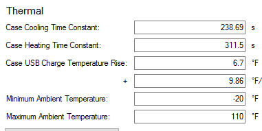

lathrodectus Posted April 21, 2017 Report Posted April 21, 2017 @giz_60Would you please post your therion 166 thermal settings?I dont have tools to calibrate yet and I think your results would be better than defaults.Thanks
giz_60 Posted April 21, 2017 Report Posted April 21, 2017 It doesn't take any special tools, just have to make sure your batteries are at least 50% drained...it does take awhile for the analysis to run...but here is a screenshot of the case thermals off of my Therion

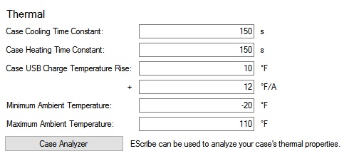

dpruk Posted April 21, 2017 Author Report Posted April 21, 2017 Here's what my settings are, not a clue if there wrong though
giz_60 Posted April 21, 2017 Report Posted April 21, 2017 Those are the Evolv generic defaults...unless the case analyzer has been run or the manufacturer changed the values, those are the settings you will see.Edit: In other words, they are not the correct values for your Therion
