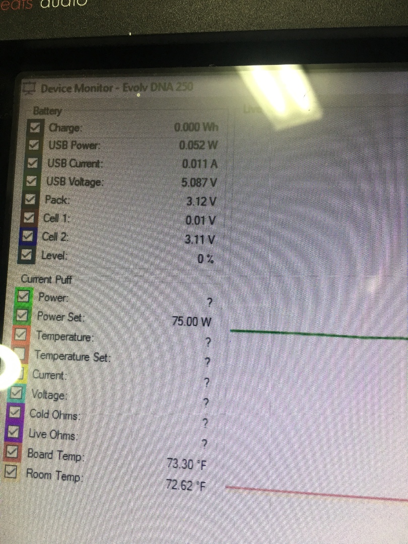

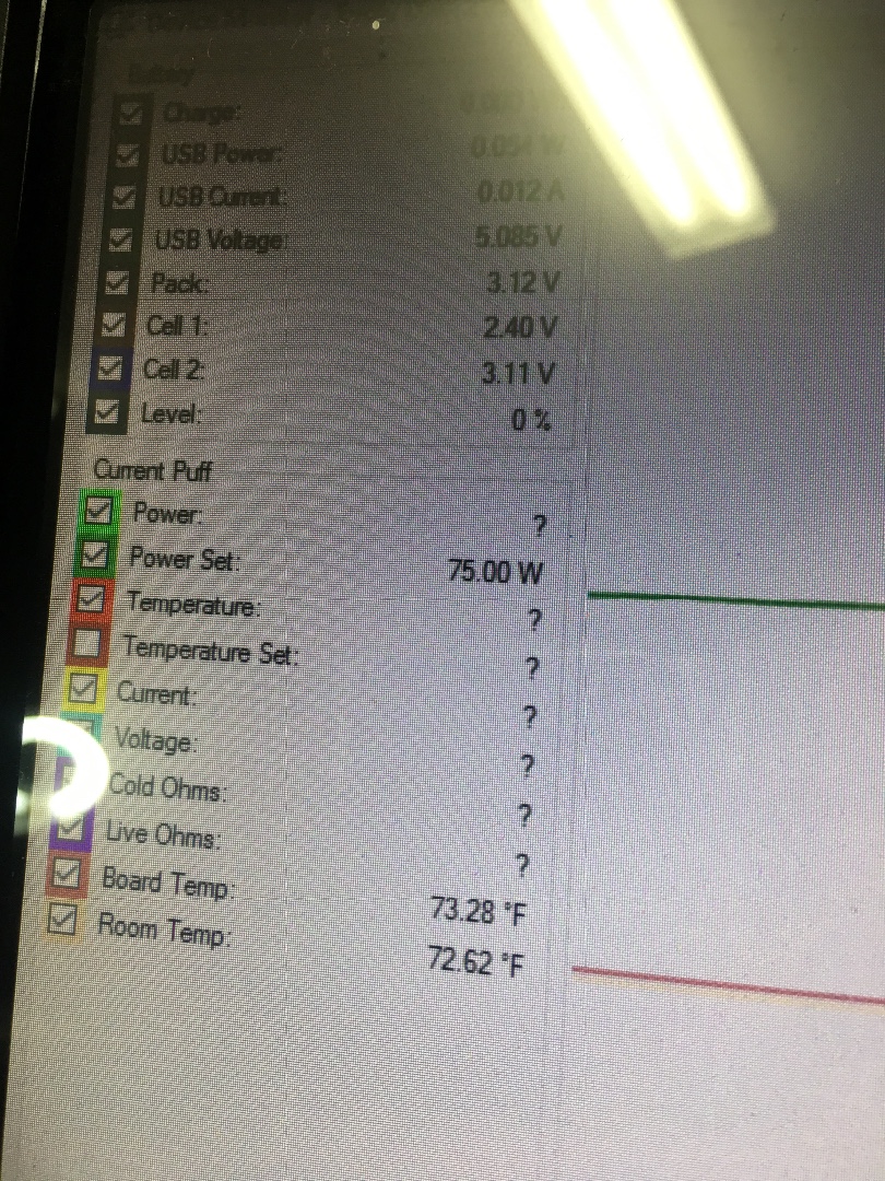

giz_60 Posted April 18, 2017 Report Posted April 18, 2017 Can you post a screen shot of the 'Mod' tab in Escribe & a screen shot of Device Monitor...
tdelandero Posted April 18, 2017 Author Report Posted April 18, 2017 Sure I'm getting now a message that say Check battery The batteries are new and when the device it's connected to the power the battery indicator blinks.
giz_60 Posted April 18, 2017 Report Posted April 18, 2017 On one picture, Cell 1 is .01v & on the other, 2.4v...looks like you have a battery connection issue...have you checked the battery compartment to make sure no juice has leaked in....you might try cleaning the battery contacts with some iso alcohol...

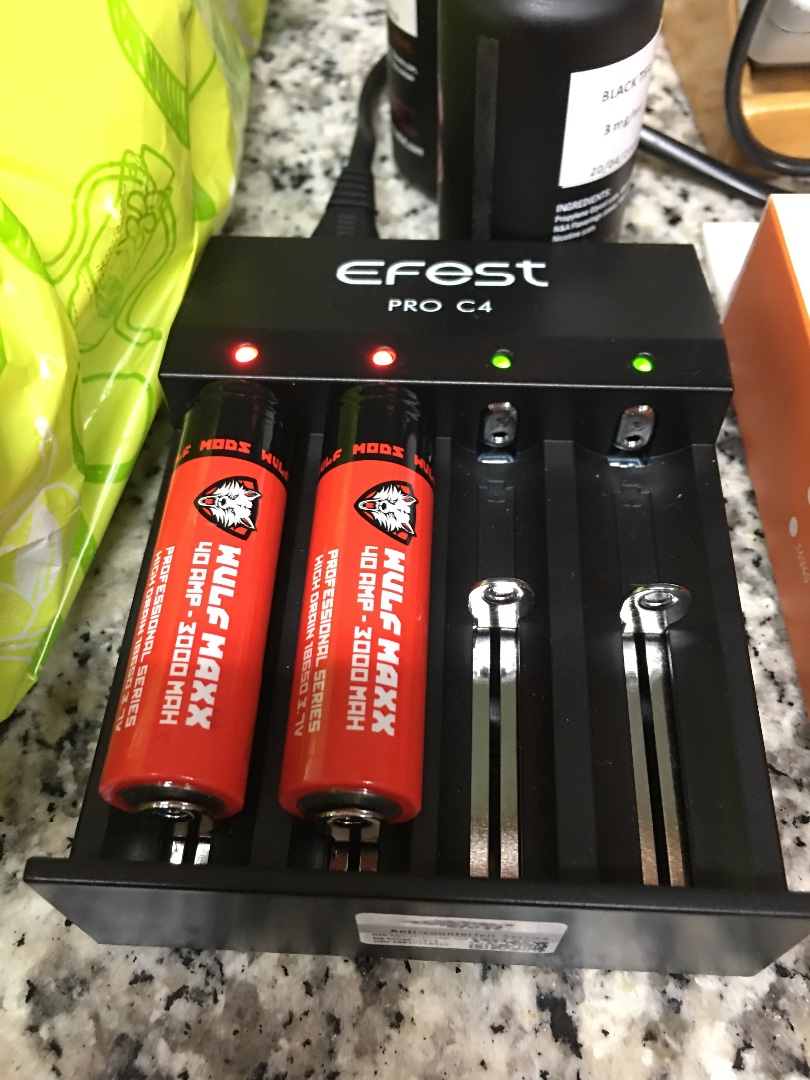

tdelandero Posted April 20, 2017 Author Report Posted April 20, 2017 This is the charger and the batteries I'm using
giz_60 Posted April 20, 2017 Report Posted April 20, 2017 tdelandero said:Thanks a lot !!! So you recommend me to charge the batteries with the external charger than connected directly to the power source? Shouldn't matter, but you should always use the batteries as a married set....charge together...discharge together...tdelandero said:This is the charger and the batteries I'm using The charger should be fine, but would recommend batteries that are on Mooch's list....and make sure you get them from a reputable source..lots of fakes out there

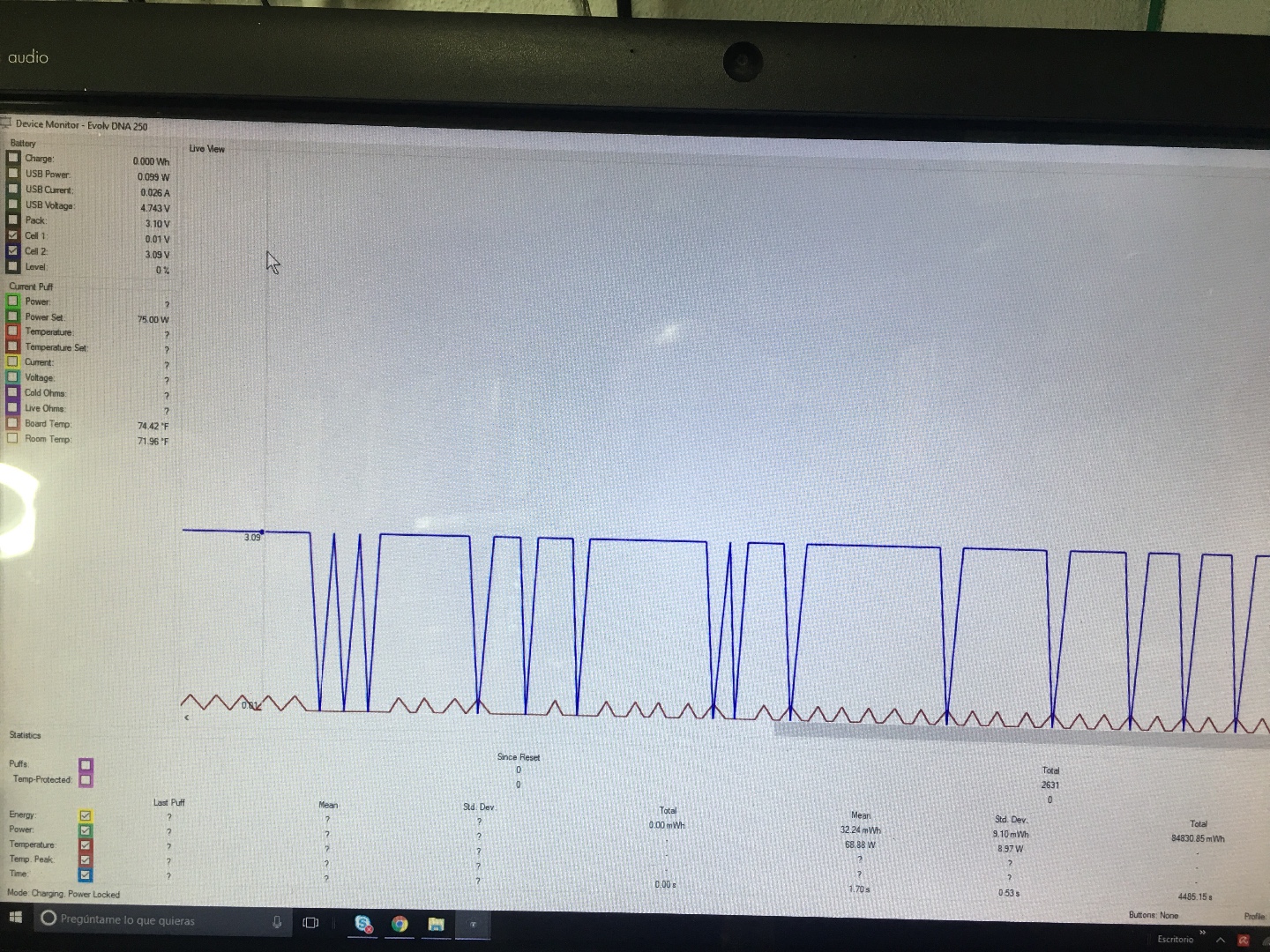

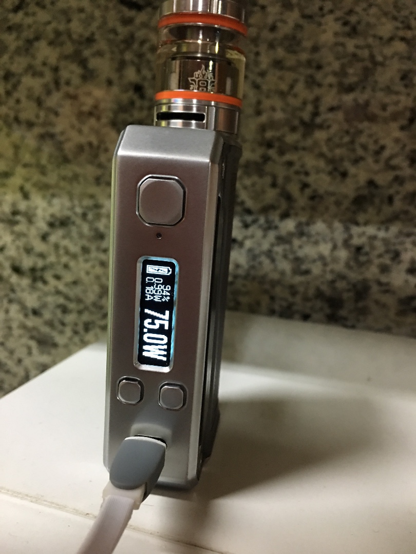

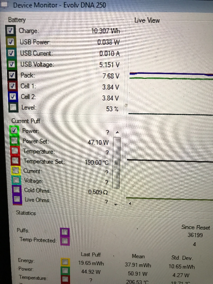

tdelandero Posted April 20, 2017 Author Report Posted April 20, 2017 For last, when I connect the vape directly to the power source using a Samsung galaxy 2A charger this it looks. Does it look normal?
giz_60 Posted April 20, 2017 Report Posted April 20, 2017 Yup...looks good...like I said, if the problems come back, it's probably because of the batteries...the ones you have are probably what are referred to a re-wraps...a battery that has been wrapped with a different cover...no telling what is underneath...
tdelandero Posted April 20, 2017 Author Report Posted April 20, 2017 So the once in the picture are fake?
giz_60 Posted April 20, 2017 Report Posted April 20, 2017 Fakes would be ones that someone has re-wrapped a cheaper battery, but is selling as a name brand...they may work ok, but the ones on Mooch's list have been tested & those are the ones that are recommended for our purposes...I personally use LG HG2, VTC5, VTC5a, VTC6, 30q....If you find them really, really cheap...then they are probably fake..buy from a reputable supplier! A couple of extra dollars will go a long way!!!

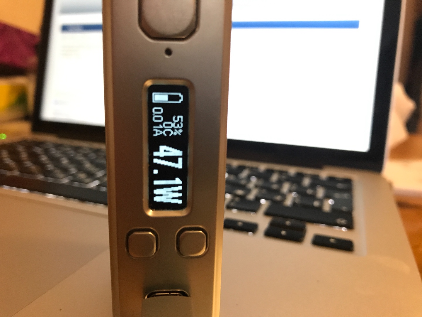

niceone Posted April 20, 2017 Report Posted April 20, 2017 Have same problem with charging. Therion 166. No charge logo on display, but it shows all other parameters (%, temp, current Amps)A = 0,01Tried with lots of power adapters, cables, and different batteries(sony vtc6, samsung 25r, lg he4)Any thoughts ?

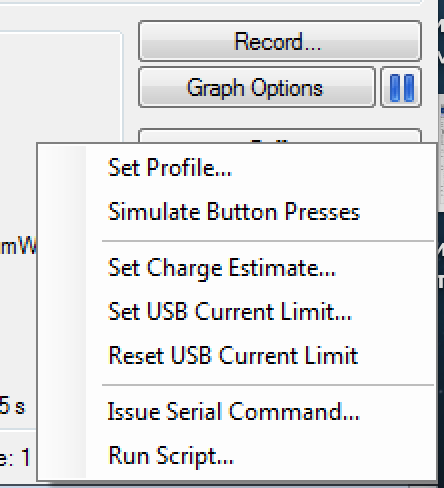

giz_60 Posted April 20, 2017 Report Posted April 20, 2017 Give this a try...in Device Monitor, bottom right corner, click on 'Diagnostics>Reset USB Current Limit'
niceone Posted April 20, 2017 Report Posted April 20, 2017 giz_60 said:Give this a try...in Device Monitor, bottom right corner, click on 'Diagnostics>Reset USB Current Limit'Already...no changes.

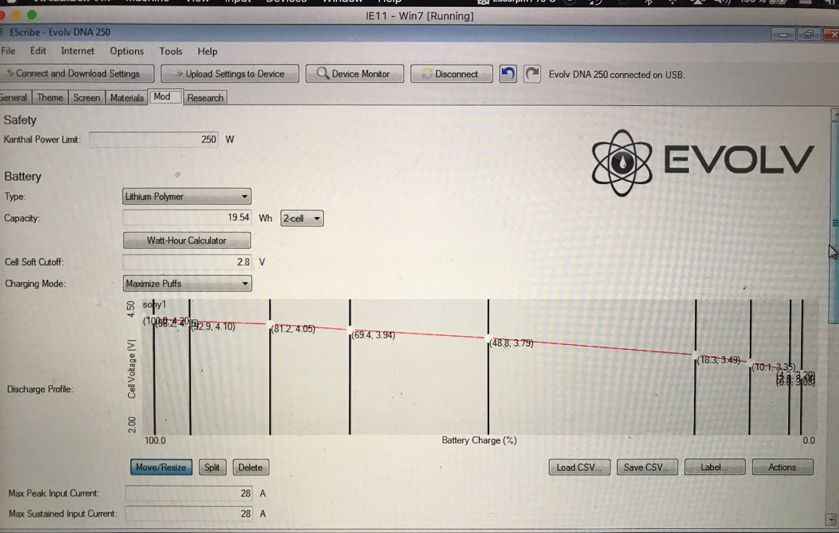

giz_60 Posted April 20, 2017 Report Posted April 20, 2017 Can you post a screenshot of the 'Mod' tab in Escribe?
niceone Posted April 20, 2017 Report Posted April 20, 2017 giz_60 said:Can you post a screenshot of the 'Mod' tab in Escribe?Sure
VapingBad Posted April 23, 2017 Report Posted April 23, 2017 tdelandero said:For last, when I connect the vape directly to the power source using a Samsung galaxy 2A charger this it looks. Does it look normal?No, I get > 1.9 A from Samsung 2 A charger, could be the Wh set too low, the device limits charge to 1 C rate, also to 1 A when data is connected like a PC USB 3 port, but setting the charging current in DM to low as others have said seems most likely cause. For the guy wit 0.1 A charge have you disable charging in DMA accidentally?
niceone Posted April 23, 2017 Report Posted April 23, 2017 VapingBad said:For the guy wit 0.1 A charge have you disable charging in DMA accidentally? Nope, cause it happens during night charging with wall plug.Also, i don't have this option in my Escribe (v1.2 SP5.2) How to enable these options for USB charge ?
VapingBad Posted April 24, 2017 Report Posted April 24, 2017 It might be on the mod tab on that version, something like uses external charger, you would want to set that to false.
