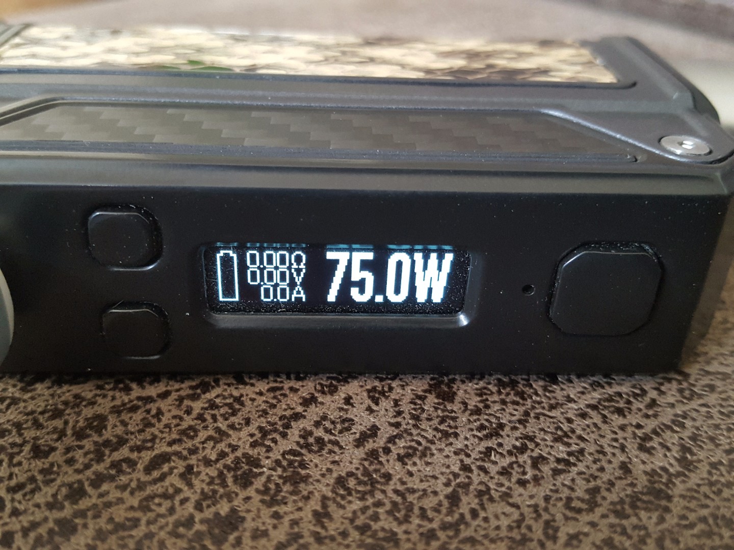

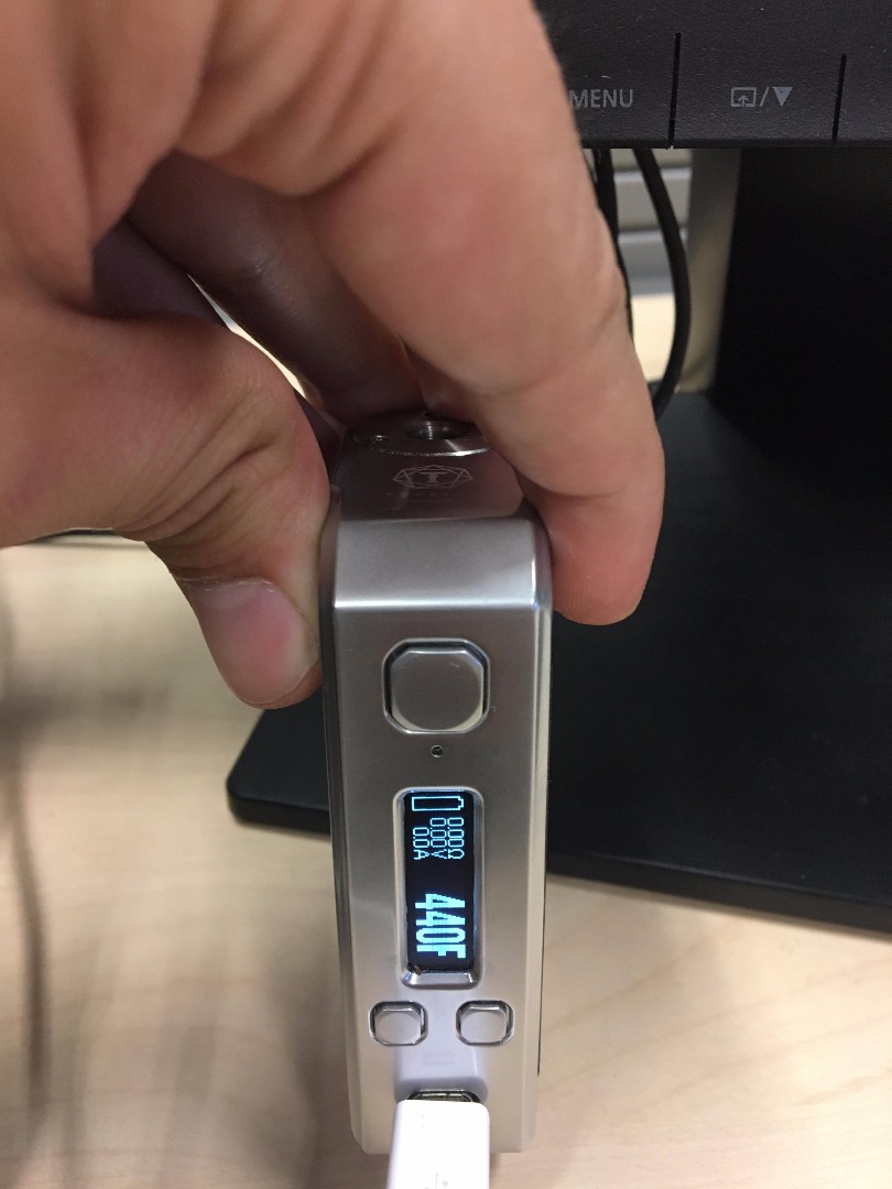

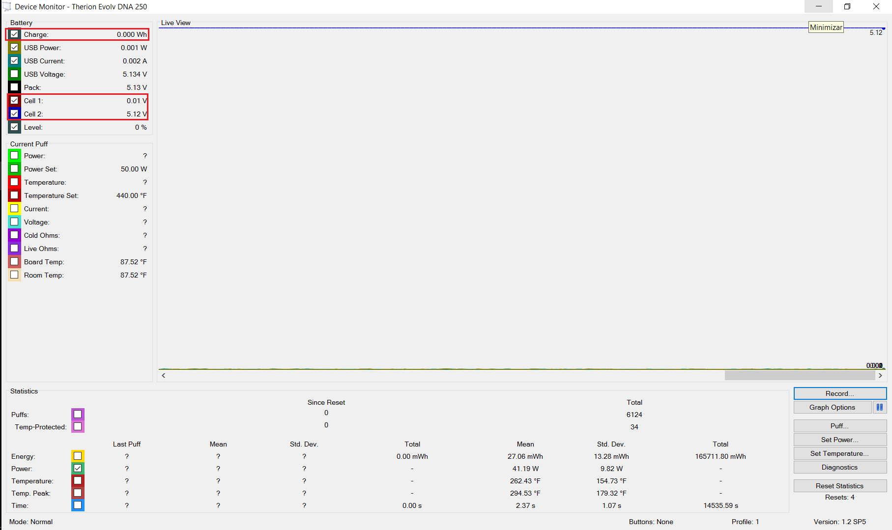

Doblos Posted April 24, 2017 Author Report Posted April 24, 2017 Hello All / Evolv, I will describe the problems found in my new therion 166W DNA 250, Until today it has worked correctly without any problem.. but since yesterday, I'm observing on the screen that the battery indicates to be empty, when turns on the mod the screen shows check battery. Description of the problem (check battery): Investigating the problem... I am observing in the Device Monitor the cell 1 has only (0.01V) voltage constant and the cell 2 marks constant too 5.2V, I have checked the Batteries (2 sony vtc6) are correctly loaded in another mod. I tried to exchange them but without success, I have verified that the batteries are working correctly in other mod, When I disconnect the mod from usb / electrical grid it goes in the off state. Any ideas?, Someone has happened to this same ?, what can I do? Attached screenshots of state.
giz_60 Posted April 24, 2017 Report Posted April 24, 2017 Had the same thing happen to my Therion...there are no settings to change to fix....had to be repaired. Either contact the vendor you bought it from or Lost Vape at...In U.S.... http://www.lostvaperepaircenter.comOutside U.S....lostvaperepair@gmail.com
txmonkey214 Posted April 25, 2017 Report Posted April 25, 2017 Hi, I had the same happen, just last week. It was sitting on the charger, overnight. Nick at evolv said it's likely the daughter board/usb went south. My takeaway from this is I will never charge batteries via usb, again. I have two external chargers. So, there's no need. I'm waiting for the 200, or 250C to come out. After that, my last surviving escribe mod will be my backup mod.

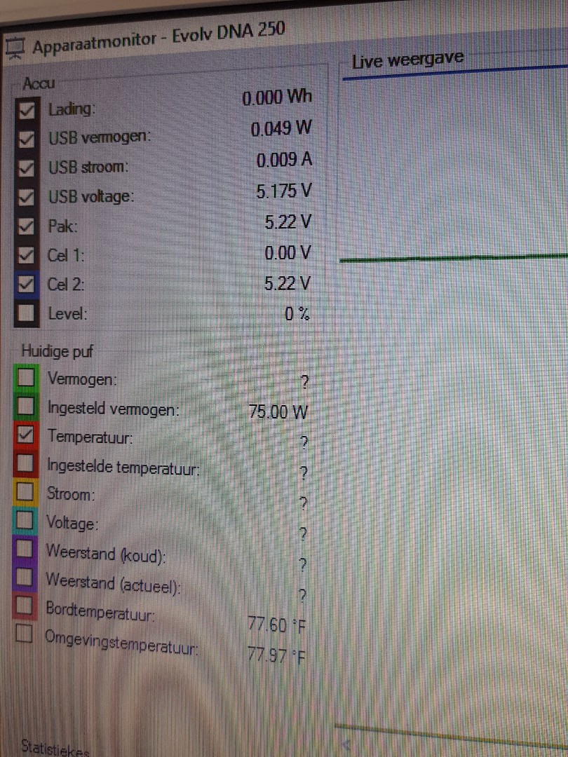

Enrico Posted April 25, 2017 Report Posted April 25, 2017 Hi there, im having the same Problem here. After doing a Battery test and loading it to my lost vape therion 166 I pressed disconnect in Escribe and removed the cable. Had check Battery message so I tried loading the factory e-sig File again, But didnt solve The Problem. Cell1 0.00V Cell2 5.22V. And the Display doesn't Stay on when i press The Firebutton (sleep Mode)
giz_60 Posted April 25, 2017 Report Posted April 25, 2017 Enrico said:Hi there, im having the same Problem here. After doing a Battery test and loading it to my lost vape therion 166 I pressed disconnect in Escribe and removed the cable. Had check Battery message so I tried loading the factory e-sig File again, But didnt solve The Problem. Cell1 0.00V Cell2 5.22V. And the Display doesn't Stay on when i press The Firebutton (sleep Mode)Anytime you see a cell voltage over 4.2x, then that's a good indication of a problem with the device. Try contacting the vendor you purchased it from or Lost Vape at one of the links in post #2
