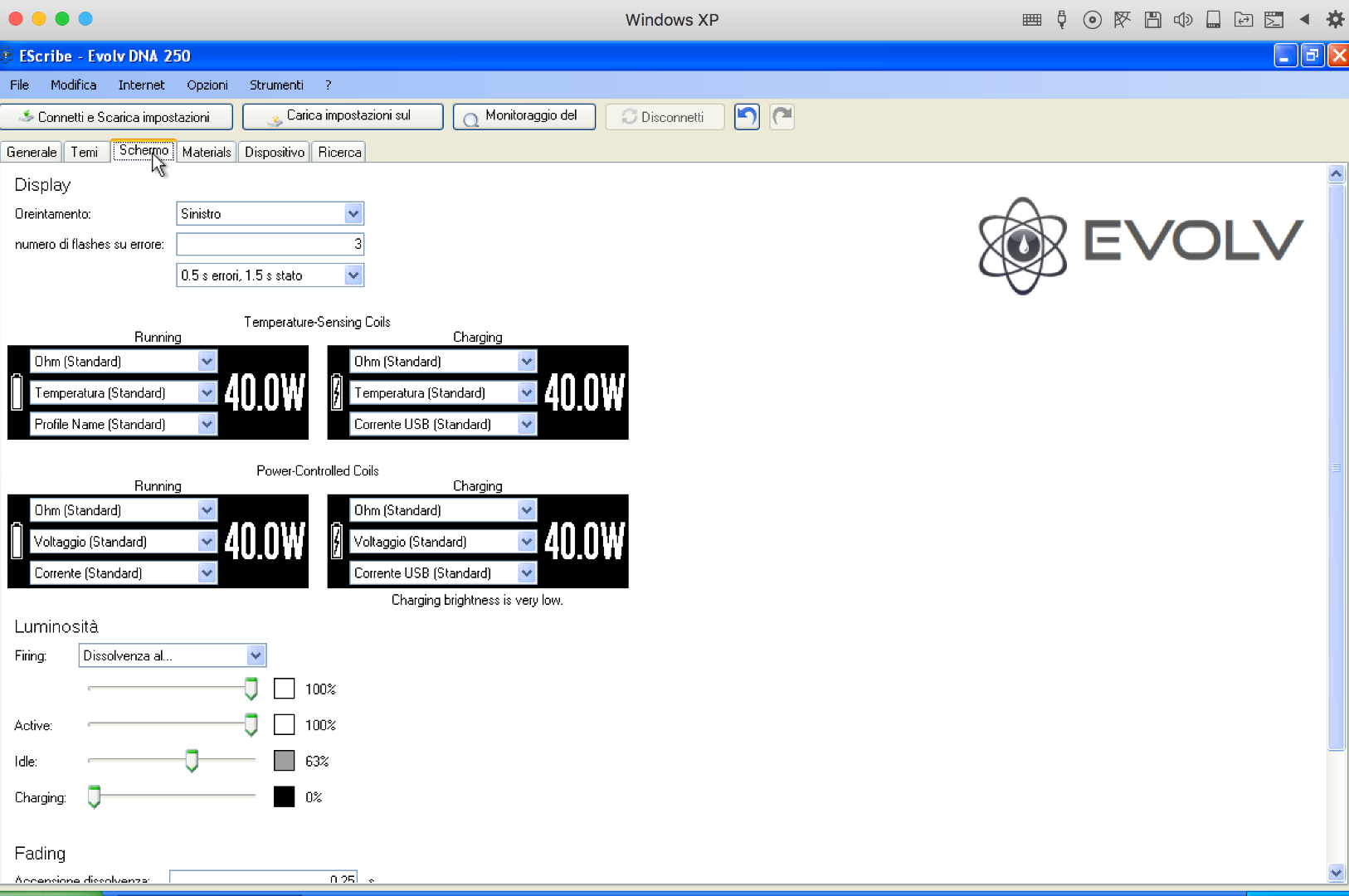

tomato Posted April 23, 2017 Author Report Posted April 23, 2017 Hi ,Please how i can set battery charge percentage in dna 250 with escribei change setting in this page ma nothing happentanks

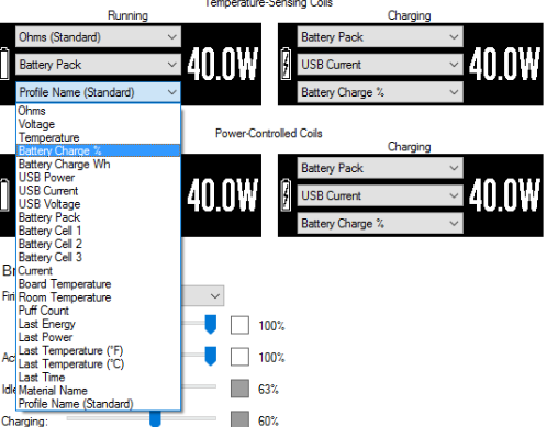

giz_60 Posted April 23, 2017 Report Posted April 23, 2017 Select this setting & then 'Upload Settings To Device'....
Wayneo Posted April 23, 2017 Report Posted April 23, 2017 BUT you'll never see it UNTIL you turn UP your charging Brightness !

tomato Posted April 23, 2017 Author Report Posted April 23, 2017 ok tanks but there are 4 panel with 3 setting each i must change only the frist like pitc or change in all of 4 panel ?sorry but i'm very inexpert
giz_60 Posted April 23, 2017 Report Posted April 23, 2017 Depends on when you want to see it...all the time,1 setting in all 4 panels...if only while charging, the 1 setting in the right 2 panels (but raise the brightness)...if only while in normal operation Temp mode, 1 setting in the top left panel...if only in Power (watt) Mode, 1 setting in the bottom left panel...

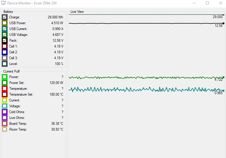

Madkat Posted April 27, 2017 Report Posted April 27, 2017 giz_60 said:It will stop charging. In regards to the Wh battery level.I am using the HG2 X3 @ 28.3wh kindly provided by giz_60.i have been charging this on my PC with device monitor open, was expecting it to stop charging once it hit the 28.3Wh but its been still charging for another 30min.I increased to Wh to 29Wh, it's now charged to the 29Wh and is still charging.Does this mean the Wh capacity is greater that what i have entered? should i keep increasing it?
giz_60 Posted April 27, 2017 Report Posted April 27, 2017 Madkat said: In regards to the Wh battery level.I am using the HG2 X3 @ 28.3wh kindly provided by giz_60.i have been charging this on my PC with device monitor open, was expecting it to stop charging once it hit the 28.3Wh but its been still charging for another 30min.I increased to Wh to 29Wh, it's now charged to the 29Wh and is still charging.Does this mean the Wh capacity is greater that what i have entered? should i keep increasing it?No, it does not mean your capacity is greater. No matter what value you enter in the Wh setting in the mod tab, you are going to see the same behavior in Device Monitor. The value you were given was generated by running the battery analyzer on those cells. Anyways, it's not going to affect battery performance, but only aid in making the battery indicator on the device a bit more accurate. The board doesn't use that value to decide when to stop charging, but rather the actual voltage of the cells.
