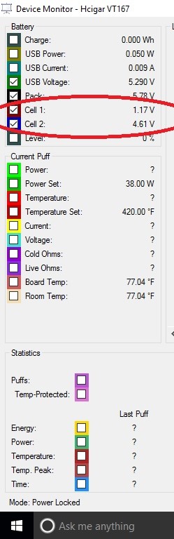

ivansn Posted February 13, 2017 Author Report Posted February 13, 2017 Accidentally I changed battery setting from Lithium polymer to Power Supply mode. But when I try to change back to lithium polymer setting with general battery settings (11.1 Wh, 2-cell, 3.09V cutoff) then upload settings, still cannot charge and display battery check everytime I press firing button.Try downgrading to SP3 or SP5a firmware still do not work.What should I do?
dwcraig1 Posted February 13, 2017 Report Posted February 13, 2017 What does eScribe show for cells 1 & 2 voltage?

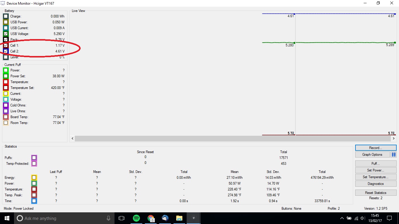

ivansn Posted February 14, 2017 Author Report Posted February 14, 2017 dwcraig1 said:What does eScribe show for cells 1 & 2 voltage? Cell 1 : 1.17VCell 2 : 4.61VSwitch battery position or using other full charged battery type/brand (vtc4/vtc5/samsung 25r/lg hg2) is also the same results.
dwcraig1 Posted February 14, 2017 Report Posted February 14, 2017 Sorry to tell you but the board is the problem.

chai911 Posted March 12, 2017 Report Posted March 12, 2017 Battery management IC had gone. I fixed this problem many boxes already.
ming Posted April 20, 2017 Report Posted April 20, 2017 chai911 said:Battery management IC had gone. I fixed this problem many boxes already.I just have this problem today, can you please tell me how to fix it, thanks

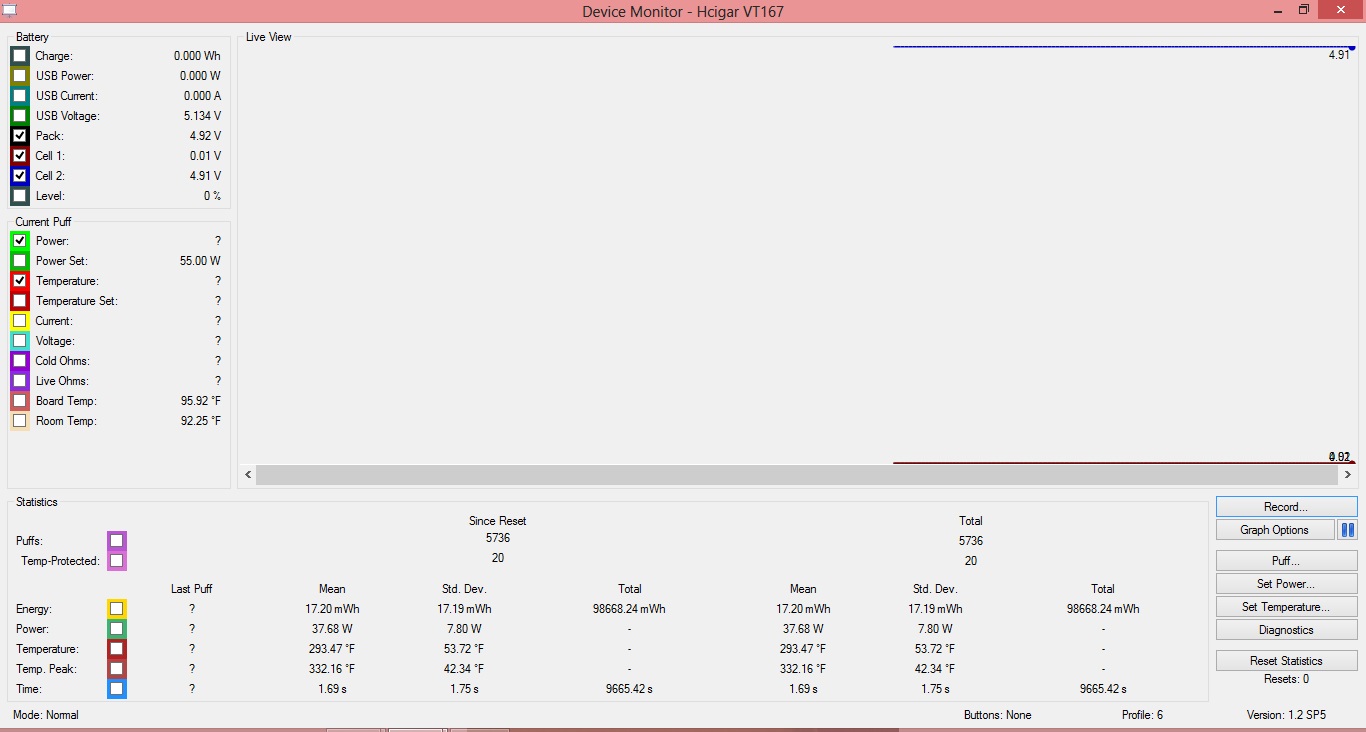

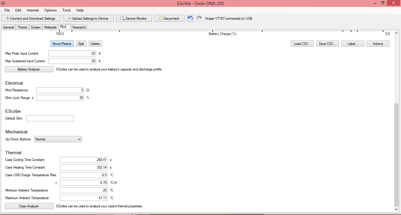

giz_60 Posted April 20, 2017 Report Posted April 20, 2017 ming said:I just have this problem today, can you please tell me how to fix it, thanksCan you post a screen shot of the 'Mod' tab in Escribe & one of the 'Device Monitor' too...

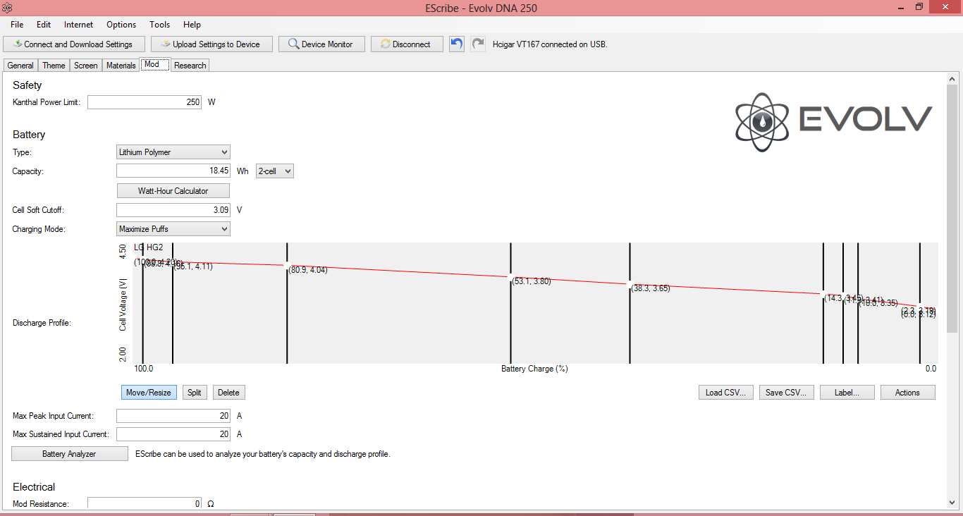

ming Posted April 20, 2017 Report Posted April 20, 2017 I switch the place of two batteries and it display the same thing. And both batteries work in my other mod (evic vtwo mini) I use LG HG2
giz_60 Posted April 20, 2017 Report Posted April 20, 2017 All your settings look ok but seeing the 4.91v on cell #2 is a good indication that there is a problem with the device...if it is still in warranty, you might contact the vendor you bought it from or email Hcigar at...service@hcigar.com
