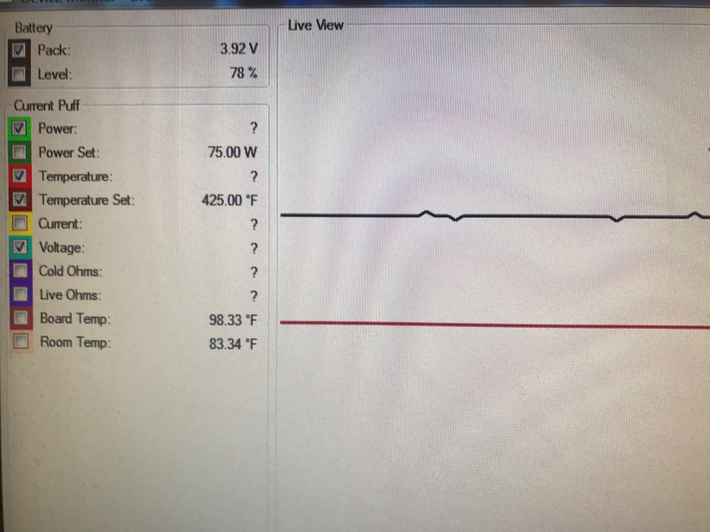

Wayneo Posted May 11, 2017 Report Posted May 11, 2017 Damn. Can you post a printscreen of your Mod tab and Device Monitor with the following boxes ticked.

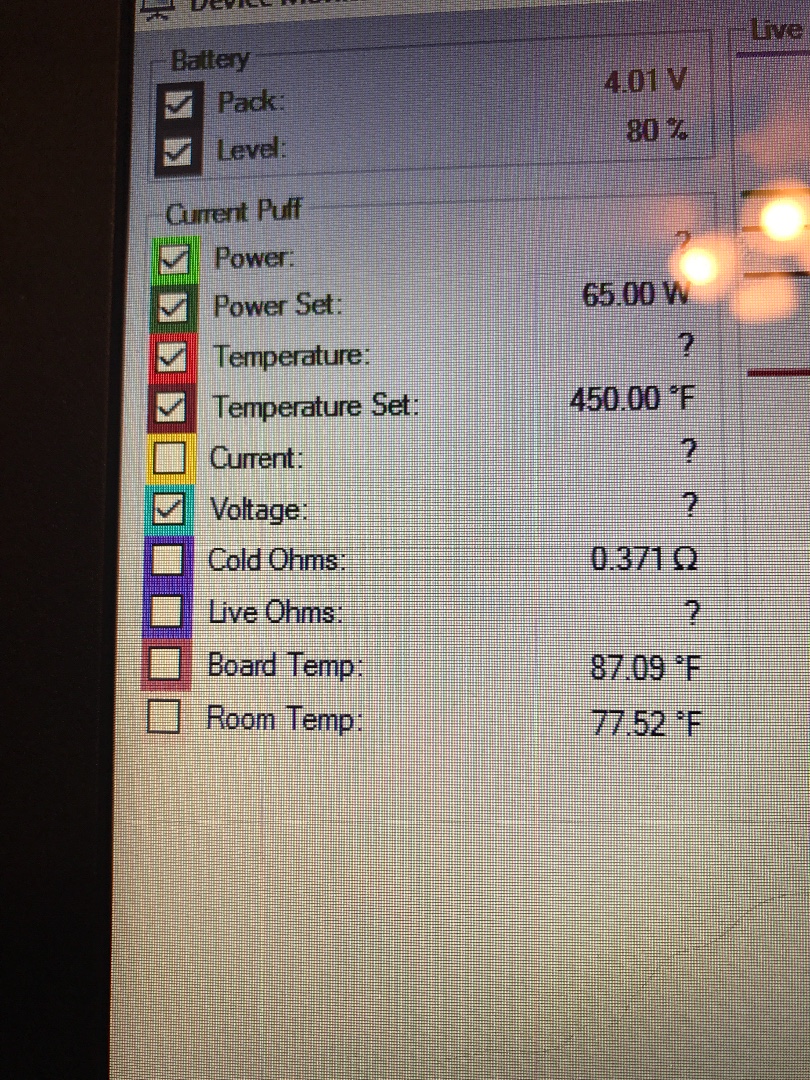

awsum140 Posted May 12, 2017 Report Posted May 12, 2017 With "cold ohms" at "?" it either isn't seeing the atomizer of you need to press the fire button once to get a reading. If it isn't seeing the atomizer, check the connection between the atomizer and the mod, after that the connection between the 510 and board inside the mod.

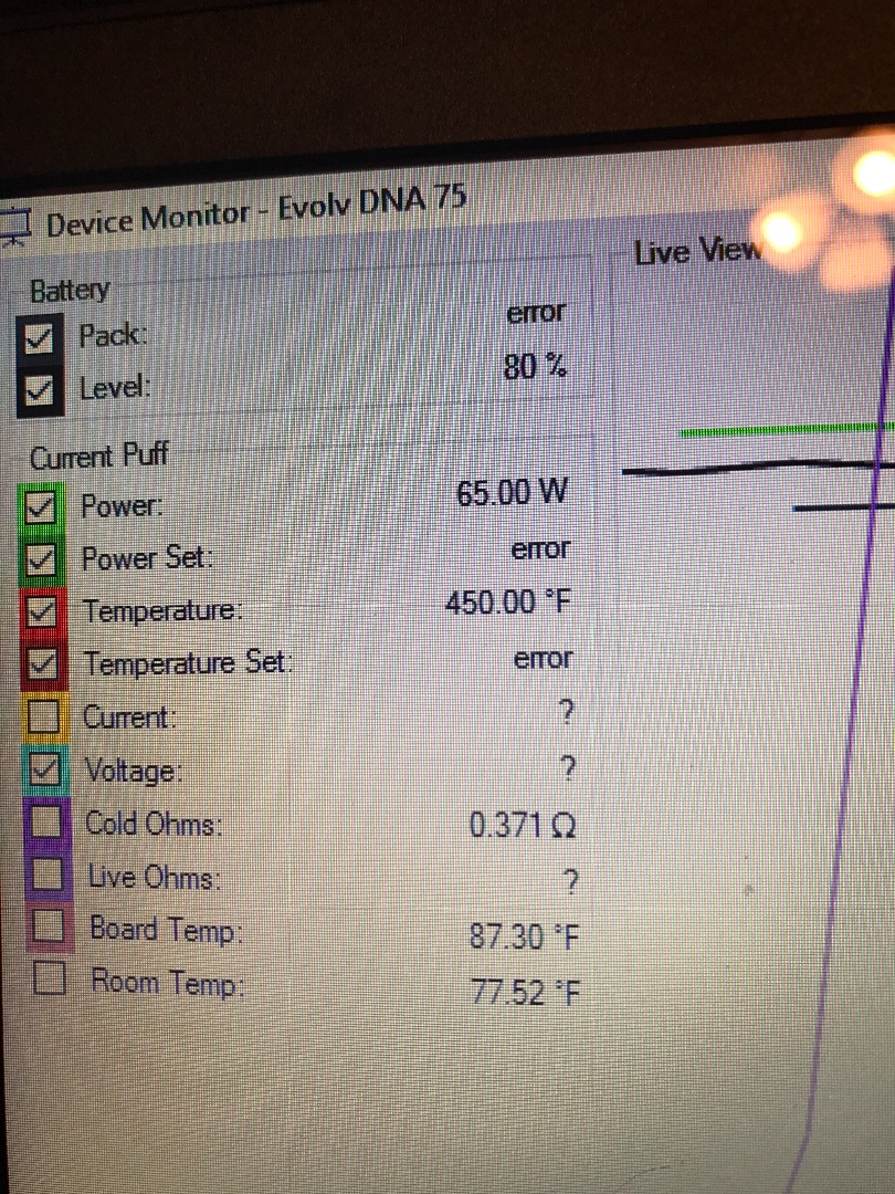

djbig1s Posted May 12, 2017 Author Report Posted May 12, 2017 Now I'm getting the cold ohms setting. But then a while bunts he of errors start coming up. Bizarre
Wayneo Posted May 12, 2017 Report Posted May 12, 2017 Can you post a printscreen (the entire screen) of your Mod tab and Device Monitor while firing.PrintscreenWith Device Monitor showing you just hit the "prt sc" button on your computer.Open a Paint software program and click on "Paste".You can change size, orientation, and etc. in the Paint software.Save this to your computer.Attach the saved file to a post here.OR(if you press [ALT]+[PRT SCN], open MSPaint and paste [CTRL]+[V] you have a screen shot from any program, that you can save and upload)ORSniping toolAND what are these errors you've mentioned
