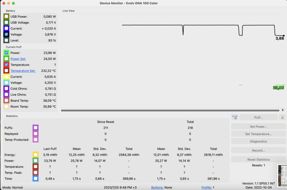

  5. dna100c - steam crave hadron mini
  6. i need to disable usb charging everytime i connect it to my mac. how can i fix it?
  7. thank you. it was 4.08 before firing. current puff area looks good to me, too. but is 4.25 volt possible with battery has 4.08 volt? is there any part that increases voltage? i am a bit interested in electricity, thats why i want to know actually, maybe this is not the place to discuss it but this is vape-related. i know the functional test, there is 7 missing, but on mod i can see 13 test done by factory. no problem with it, just to be sure about everything. as i said before, weird packaging made me curious
