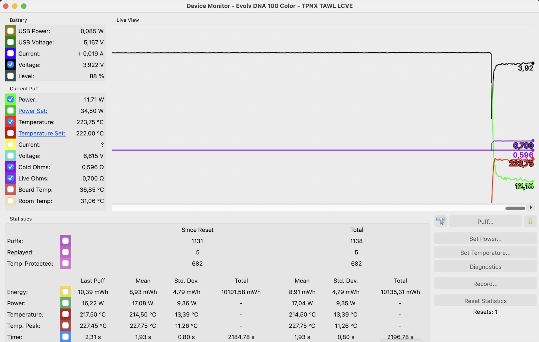

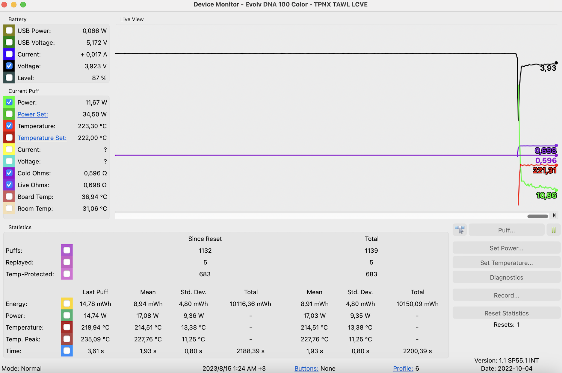

  1. both ss look similar. i saw "temp protected" once, i couldn't understand why and how that happened. i thought it would stop firing when there was no liquid, or rather i knew so, i guess it is normal for it to heat the wire. so we can say that there is no problem then?
  2. here we go.. another atomizer, better wiring, no pre-heat no wick and no juice. it still fires. no temp-protected warning or does not stop firing.
  3. wet wick. but coil's form was not very good, but it does not changes anything because i get same result with better formed coils. preheat on, punch 5. i will try with another atomizer now and without preheat. even i try to fire without wick, i never see temp controlled, it fires and coil gets hot. this means something is wrong but what is it...
  4. i cannot see this message either. i saw it once by luck, and i lost it. i tried dry hit, and it burned wick, isn't it supposed to not burn it? i am confused, what is wrong with it? even without wick, only ss coil, coil gets hot while i fire. post screws tightly screwed, nothing seems wrong.

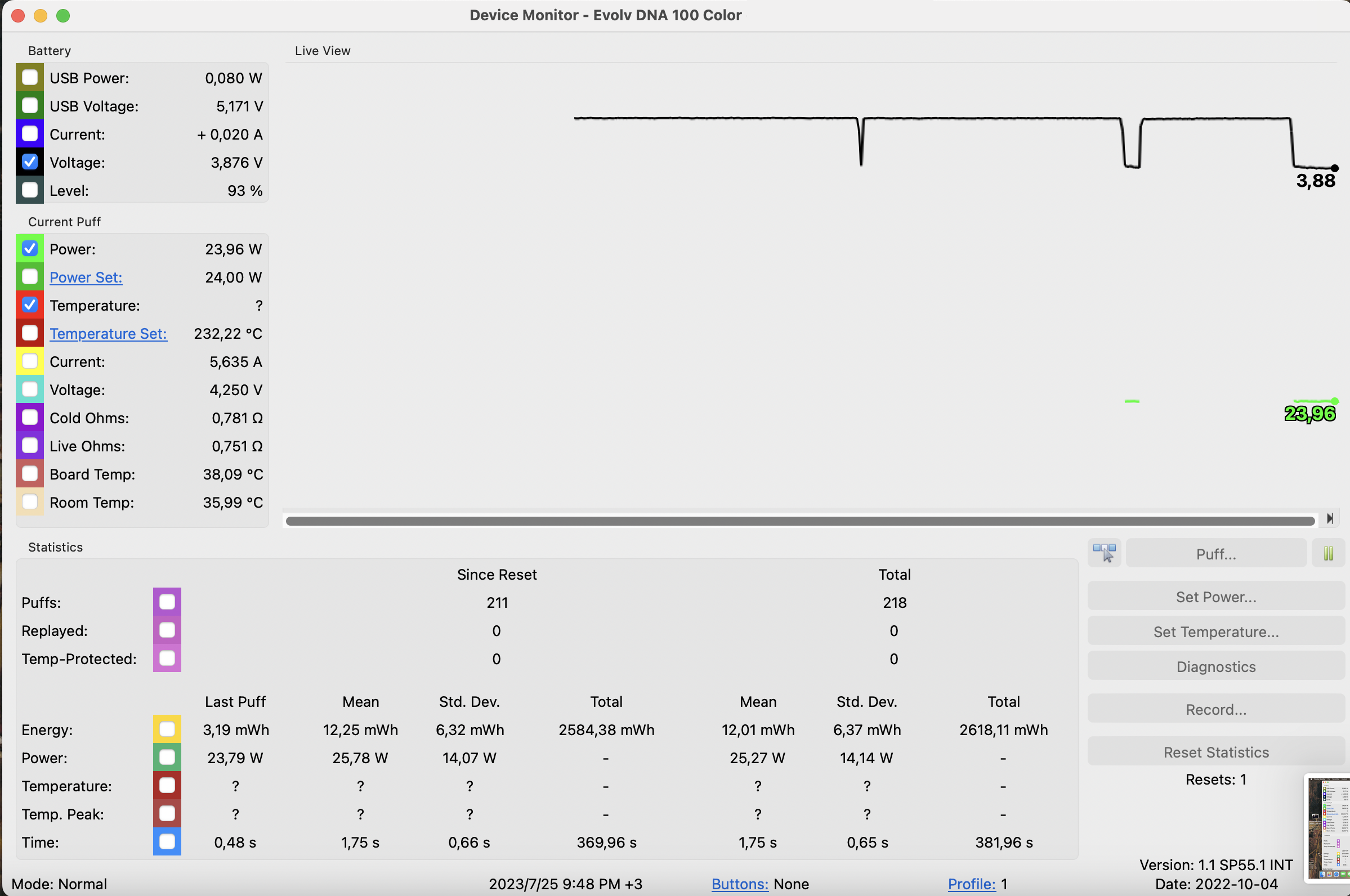

  7. thank you. it was 4.08 before firing. current puff area looks good to me, too. but is 4.25 volt possible with battery has 4.08 volt? is there any part that increases voltage? i am a bit interested in electricity, thats why i want to know actually, maybe this is not the place to discuss it but this is vape-related. i know the functional test, there is 7 missing, but on mod i can see 13 test done by factory. no problem with it, just to be sure about everything. as i said before, weird packaging made me curious
  8. Hi. I bought steam-crave hadron mini dna100c, and this is my first dna chip mod. I just want to be sure about battery stats. I bought Molicel P42, it arrived at 3.5 volts and I charged it at 0.5 amp, it is a brand-new battery but it made in june 2021. Here is my stats; (i took this ss while firing) it says 3.88 while firing, but 24 watt and 3.88 can't be 5.63 ampere i guess. this is something they call "battery slag" but isn't this a little much? btw, how can i test fully this mod to be sure everything okay?, it arrived with missing 18650 battery slave and sponges was half, not as it should have been, that's why i am curious.
