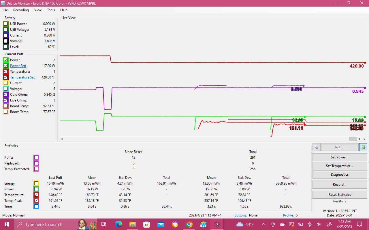

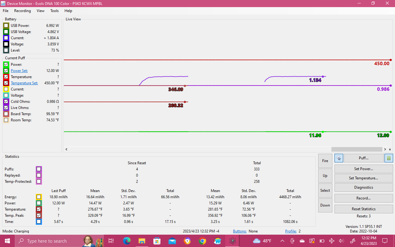

  3. As sure as rain it's 316SSL, unless I was sold something mislabeled... I was using the same roll about six years ago on a KFL2019 with an Asmodus Colossal and it was working near perfectly (even if not "accurate" persae). Still spaced, no hotspots And as far as the atomizer stability goes, it seems rock solid. For both the KFX and KFL19. And yes! I do. I've got three diagnostics screens for you. #1 is the KFX in watts, #2 is KFL19 in Watts, #3 is the KFL19 in TC

  5. First time forum goer and first time DNA-owner here... So the gist is that I'm running a Kayfun X on a Thelema Solo DNA 100C. Coil: 2.5mm ID, 8/9 wraps, spaced, 316SSL 28g, reading as 1.04 ohms. Settings: TCR 0.00088, 13.5W, 400F, no preheat and punch 1. The TC is working, but in the average 3-6s pulls I take, the temperature is topping out in the 380's. It's stepping down my 13.5W to 11.1W and keeping a consistent temp, but in the 380's, and not the set 400F. Not sure if there's a setting or something I'm missing, but I'd like to figure out how I can get my atty to get up-to-temp quickly... Even if that means using preheat and/or punch, just not sure how to, or the best settings. thank you to any one that may be able to help at all
