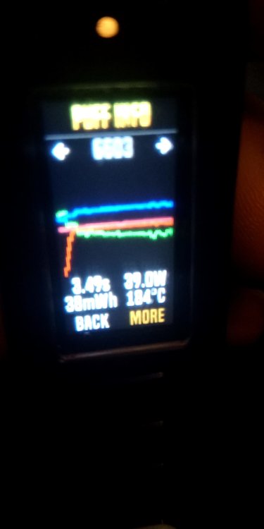

  7. Hi, I'm vaping on a Thelema solo DNA 100C, I'm trying to optimize my salted butter caramel flavor, it's not easy. could someone explain to me why the temperature information is different between the Escribe monitor and my box, please? monitor : 190ยฐc (+-3ยฐ) Box : 184ยฐc
